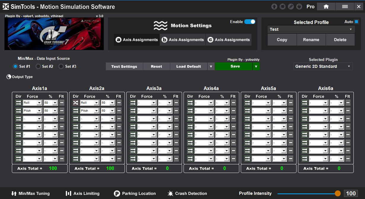

    Hi, I'm relative new and I'm studying the software before start to assemble my first DIY 2DOF or 3DOF to play GT7 on PS5.
    With success I run the GT7 proxy and I see the telemetry data, so everything ok.
    Now on SimTools v3 I wanna try the Virtual Output like one of the youtube videos of @vthinsel.
    I installed the GT7 Game Plugin, the "Plugin Builder" of Virtual Plugins and "Generic 2D standard" of Axis Plugins, I set the axis for a 2 DOF like in the SimTools manual, but at this point I'm not able to run the Game Plugin. If I push on the white start button in the middle of the game plugin nothing happen and the Virtual Output doesn't work. I have no setted any Interface setup because in this moment I haven't real
    peripheral. Is it ok?
    Someone can help me?
    Thank you in advice

  5. Arazok

    Have you patched the Plugin first (only one time) ?

  7. Arazok
    Arazok Member
    Mar 26, 2018
    180
    Computer scientist
    783Coins
    +32 / 0 / -0
    Sorry, I am using Simtools 2.x but you need to "patch" a plugin the first time.
    Not sure if this needs to be done also in Simtools 3.x

    I didn't find anything about that...I hope someone can help me
    21,719
    152,027Coins
    +11,062 / 56 / -2
    Please read the v3 Quickstart and Manual, some games need to have the path specified, which is what is meant by patching a game for motion:
    https://simtools.us/wp-content/uploads/2024/02/QuickStart-Guide-for-SimTools3.pdf
    https://simtools.us/wp-content/uploads/2024/02/SimTools-v3.pdf
    I don't have GT7 but presume you are using this plugin, is that correct: https://simtools.us/plugin/?varname=30&color=0e97dd
    If so what does it give as a guide during activation, because if a patch path is required it should prompt for that?

    I've already followed the guide.
    The patching note is to use the GT7 proxy and as I have already wrote I'm using it.
