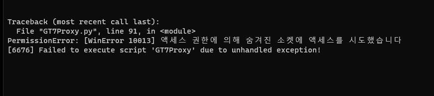

    When I try to use it with simhub, it seems like there's a crash. Is there a way?

    Since the game is sending UDP packets, only one app can grab them or you will have a port conflict.
    So you will need to send the data to one app and then forward the packet to the other app.

    I'm asking because the proxy server had an error before port forwarding and it couldn't run.
    Running SimHub, an error occurs, and not running SimHub, it will run normally.

    I already that know how.
    Regardless, an error appears even if you specify a different port on the sim hub.
    This error appears when the simhub is running regardless of the port change.
    I think that's why we need to change the port in gt7proxy.
    21,721
    152,039Coins
    +11,062 / 56 / -2
    Can you please post a picture of the error and all configurations.

    PermissionError: [WinError 10013]
    This error appears.
    Since the port cannot be changed in GT7, it is meaningless to have port forwarding on the simhub.
    So,
    Must be able to change the port in the SimTool plug-in or GT7Proxy before you can perform port forwarding on the SimHub.
    Alternatively, you must be able to port forwarding on the simtools

    I solved it.
    I re-created the executable by changing the port from the source code of the proxy.
    This works simultaneously with SimHub.
