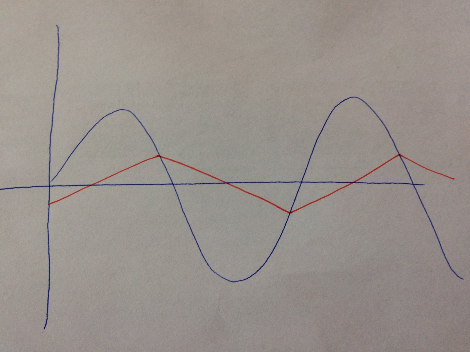

  19. MarkusB
    Jun 30, 2015
    552
    4,215Coins
    +597 / 2 / -0
    Is this jerky movement like the red line in the following picture?
    This is how the initial movement was in my case. If it is similar, please follow my previous advice:
    1. Increase the PWMax value. (By following the tutorial steps, you have carefully increased this value until the motor started moving. For following the curve, you need to increase it.
    2. Increase the Kp value.
    As already suggested: Before blindly changing the values, learn about their meaning by reading this post.
    After this initial tuning, the motor curve should follow the sine input rather precisely, at least if the motor is not under too much load. (When I did my tests, my motors were not connected to my rig.)
    If the jerky movement looks different, a screenshot may help to find the reason.
    I agree with @BlazinH that this is very likely caused by reversed wires. You need to reverse either the motor wires or the +5V and GND wires of your feedback pot (see again step 17 of the tutorial).
