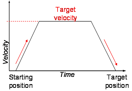

    For driving a wheel rolling in a straight distance from 0m.m. to 100m.m. which is called "range of motion " ... and if we have only 100 set points that called " linear motion resolution" ...
    So the system can't set you on any fraction of the range ... we use higher resolution set points ... So we get smother motion along the motion range and will not notice the little jump differences between the set points ... the same concept applies to a 180 or 360 degree rotation arm as radial motion ... these items are solved pretty good in the SimTools Free Motion Control Program in this site ...
    For the next video it shows how we as humans doing this as we are driving a car or throw the dart and look where it goes and then correct our next strike depending on our shoulder position adjustment resolution ... and our Brain calculations .
    Resolution of the motion is generated in a good program and is performed by a good motion controller PID parameters ...

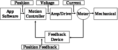

    I have not built anything yet but reading all I can. One thing I can not find is some sort of single line diagram.
    something like.......computer>arduino(?)>motor controller(jrk)>motor.
    Does that sound right? Does it have to be an arduino?
    Any help is appreciated.

    Yes @rick surette that is right ... and It doesn't have to be arduino ... you have also the SimAxe and the jrk as motor controller that can handle motion control too ... here is the latest @bsft projects using JRKs ...:thumbs

    game plays,
    simtools reads data from game via game plugin program
    simtools sends data to control board,
    control board with feedback moves motor/actuator to generate motion.
