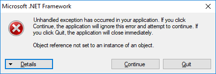

    Since last Windows 10 update last week I ca't run the GameManager,. It gives te error
    I've tried to reinstall .net but it says that the program last version is installed

    please click the details button so I can see what's going on buddy.

    Too long for the window, so i've done a copy-paste:

    It works, thanks Dustin, I can enjoy it again.

    This bug is fixed in v2.2.
    Thx for reporting it buddy! @Sento Siete!

    please help me with this same problem,
    after a year or so tried to run the rig, but same problems, nothing was changed on my win 8.1, simtools 2.4 (i guess)
    framework errors, and game manager misses live for speed plugin, which was never installed,
    DEMO mode, though there is a pink patched rectangle
    no game profiles, error messages all over
    what should i do?
    Thanks,
    System.NullReferenceException: Object reference not set to an instance of an object.

    First ensure you are using the latest version of SimTools: https://www.xsimulator.net/community/marketplace/motion-simulation-software-simtools.63/
    If there are errors expand the error message and copy then paste the full error message here.

    Thanks for the reply,
    i reinstalled 2.4, now it runs but wants live for speed.
    i guess i have to renew the licence.
    is not there any way to restore the licence?
    the directory is there, with two licence files in it.
    i red that there is a limited number of licence renewals.

    There are limited number of reinstalls for SimTools, too many will trigger a specific message saying that, if so contact SinTools direct: https://simtools.us/contact-us/
    You should be using the latest version of SimTools, which is v2.5.1: https://www.xsimulator.net/community/marketplace/motion-simulation-software-simtools.63/

    Open the reg app and click 'check license' and it will fix any license problems if found.
