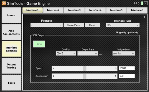

    I was able to go thru the settings in Game Engine fairly easily and after a few tries I am getting the output testing correctly with the mouse. The actuators go thru the initial check fine, when I start Game Engine and I see no issues.

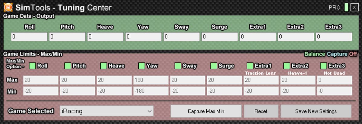

    The problem I am having is that when I start the game, the Game Manager remains "green" and it never and tuning center never receives any telemetry data. I have unpatched, run some laps with all 3 games, repatched running as admin, and without admin rights but still nothing, the Game Manager never changes to blue.
    I am not sure if it has to do with having my games on a different drive (not C:) and because of that the patching is not going thru correctly, or it is just not going at all.

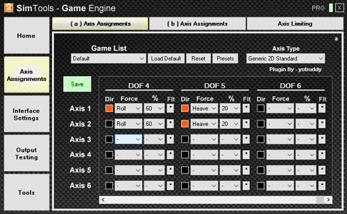

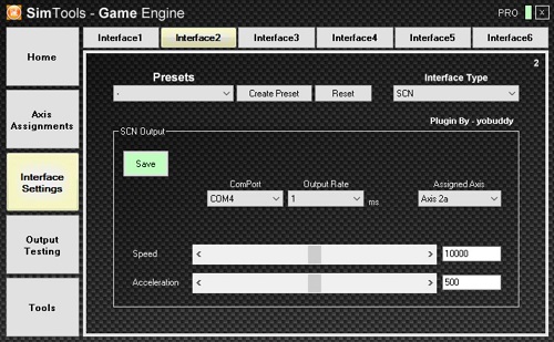

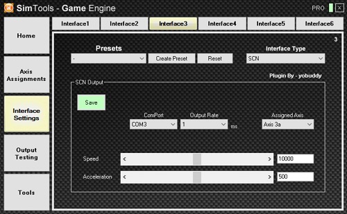

    Any way, I hope you guys can help me because I am running out of options. I am posting some pics of my settings.
    1.JPG 2.JPG 3.JPG Thank you,

    Can you please post a picture of your Interface Settings.
    Does your simulator move using Output Testing?
    Just to be sure can you please confirm the patch path you use for iRacing?
    Also the Axis Allocations are too high for Axis 1 and 2, the total should be closer to 100% not 180%.

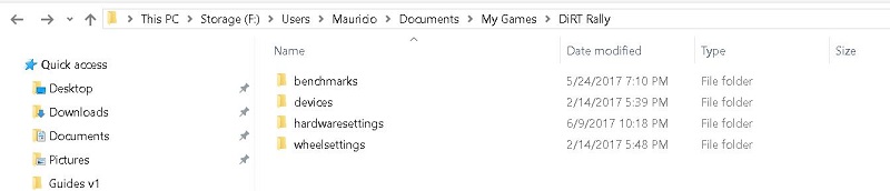

    So I read that we need to do some laps in the games before patching. I have been playing these games after installation of simtools for a while, but I hgave it a try anyway with Dirt Rally. Still after patching Game Manager still does not go blue.
    I noticed a file named "hardware_settings_config" was created when I clicked on "patch game" under this folder.
    F:\Users\Mauricio\Documents\My Games\DiRT Rally\hardwaresettings
    So could this be the patch? If that is correct, then patching must be OK and the issue is probably somewhere else.
    I am adding more pics of my settings.
    If you need any other information just let me know.
    Thanks for your help, I appreciate it.

    Sorry interface 1 attached 4 times and I cannot remove it. The other captures are attached

    With Codemaster games where you patch depends on your Windows install being 32 or 64bit.
    Patch to documents>my games>dirt rally for 64bit
    Patch the game install folder for 32bit.

    I patched the game under F:\Users\Mauricio\Documents\My Games\DiRT Rally . I see 4 folders inside as shown in the pic
