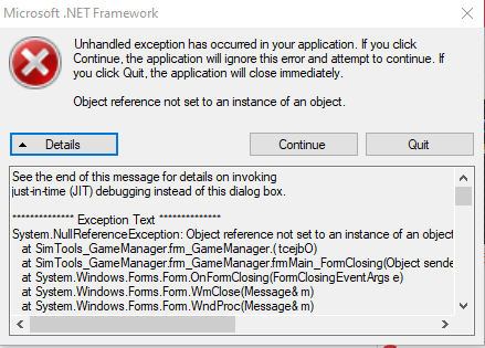

Question Game manager has an error.

  10. Patrick123456
    Patrick123456 New Member
    Jan 8, 2021
    22Coins
    Hello, I have a problem. Any concerns help me help? Many Thanks
    22,219
    154,783Coins
    +11,217 / 57 / -2
    In what circumstances is the error generated?
    For example, have you updated from the old version of SimTools or is this a fresh install?
    Have you tried repairing or reinstalling .NET: https://www.microsoft.com/en-us/download/details.aspx?id=30135
    To rule out other possibilities is your computer set to English Local: https://www.xsimulator.net/community/faq/simtools-language-setting-bug-change-to-english-local.233/
  12. Patrick123456
    Jan 8, 2021
    22Coins
    Thank you very much for your help.
    The problem was Mircosoft.Net framework.
    I reinstalled it and then it worked.
