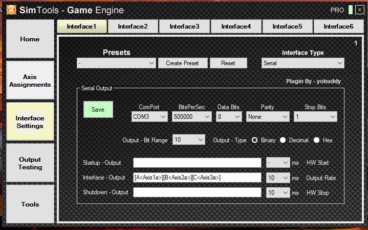

    Did you get it working? I have exactly the same problem. Starts working but after few seconds, the game engine stops working. I have to reboot the Pc to get it working again. I'm using an Arduino controller for my DOF. Rest of Games (PC1, Assetto, iracing) working fine. Running Simtools 2.1 on Win10 (i7 5930K, titan X)

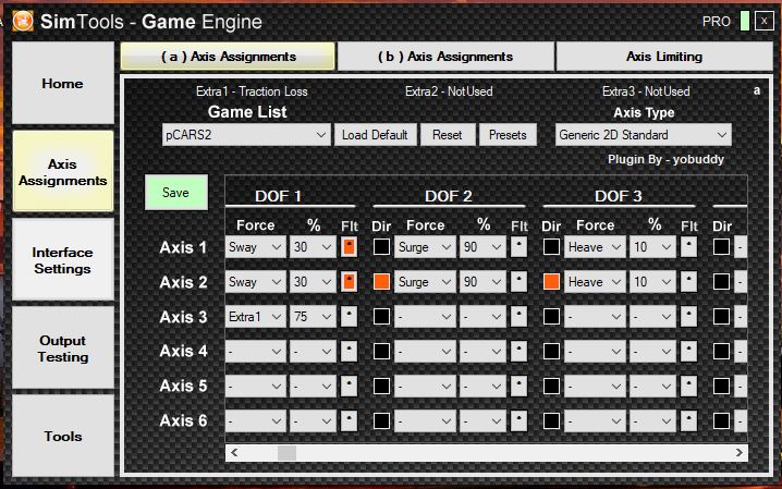

    The problem is with project Cars 2. I tried using PC1 and PC2 plugins (in the game options you can select output profile for PC1 or PC2) but both had the same results. I'm now using pluing 20.3.3 for Project Cars 2. As I said, my other games work fine. Below a couple of screenshots of my config.
    I dont receive any error messages. Basically, you start the game and after few seconds there is no more movement. If you close the game and run another game it wont work either. So, I have to restart the PC to get it working again.
    Running 3DOF with Arduino. Simtools 2.1 on Windows 10

    Sounds like you are tripping a PSU out or crashing the UDP communication.
    Just a quick test, lower the Main % in Game Manager to 80% and let us know if that changes anything.
