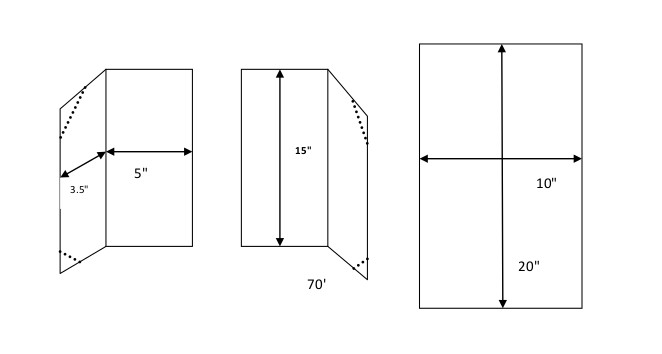

    I thought I would post a final and complete parts list with links so that this could be easily built by others. Please note I've included some mild revisions from my build to improve panel size. Here we go:
    G-SEAT FINAL PARTS LIST, complete w/links:
    Aluminium Pieces 0.08-0.09" thick (11-12G), all edges tumbled: (see attachment)
    1 - 10" x 20"
    2 - 15" x 8.5", with 70 degree bend as depicted below; both outer edges from each panel chamfered 1.5" from corners (see below)

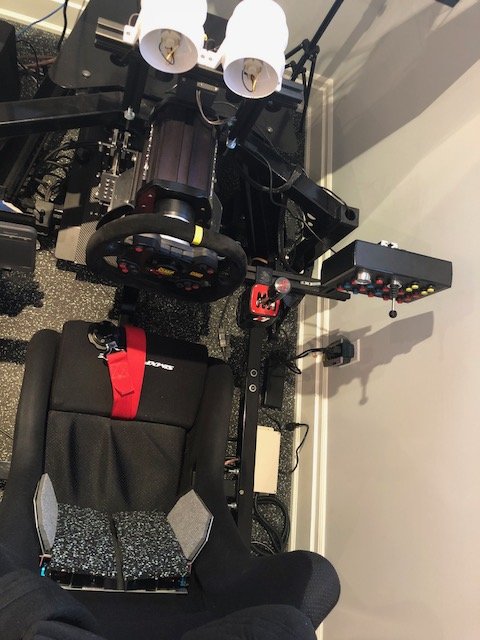

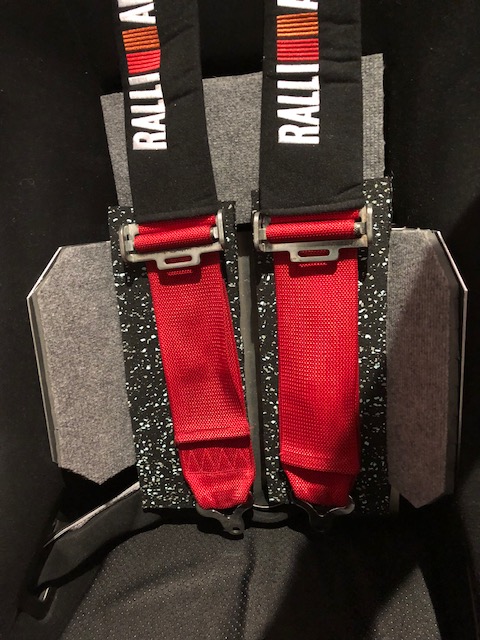

    I think the major pro of the G-seat is it provides tremendous feedback regarding sustained G-forces in corners as I'm sure you already know. It can be tricky to integrate with other motion, but once you find the sweet spot, it's fantastic! I find it really helps my driving. I now use only sway and pitch in Simtools with the GSeat. That said, I've been driving with Simvibe for a long time now, and I'm not sure what I would choose if I had to have only one. I would say that a G-seat might help your driving more, but Simvibe might be a better first step to immersion if you do it in all 4 corners of your rig. If you were just going with 1 transducer, I would definitely build a G-seat. If possible, best answer is do both ;))
    Good Luck!

    Well i was definitely also considering adding both - vibe and gseat, but in other hand i was worried about how the servos and rest of the gseat electronics handle the vibrations from transducers? Ain´t it a problem?
    Well i´m not actually looking for improving my driving (i admit i´m not and will not be the festest living human:D) more looking for most real immersion... My motion rig is great, but still missing "something"..
    Btw for gseat i´m looking for sway definitely, but also heave for bottom paddles (i also like rallying..:).

    I think that depends on your racing seat. If there are removable pads, it could definitely be possible though I haven’t tried. My thoughts are that the lateral G forces are more important to add to the immersion and driving information. There are other ways to achieve some of the surge braking sensation that you’ll get with leg paddles such as the excellent harness tensioner that I recently purchased from @SeatTime (see commercial section of forum).
    Should you choose to go with leg paddles, I think you could consider using a single paddle like @early_m ended up doing (https://www.xsimulator.net/community/threads/diy-g-seat-from-concept-to-final.11669/)
