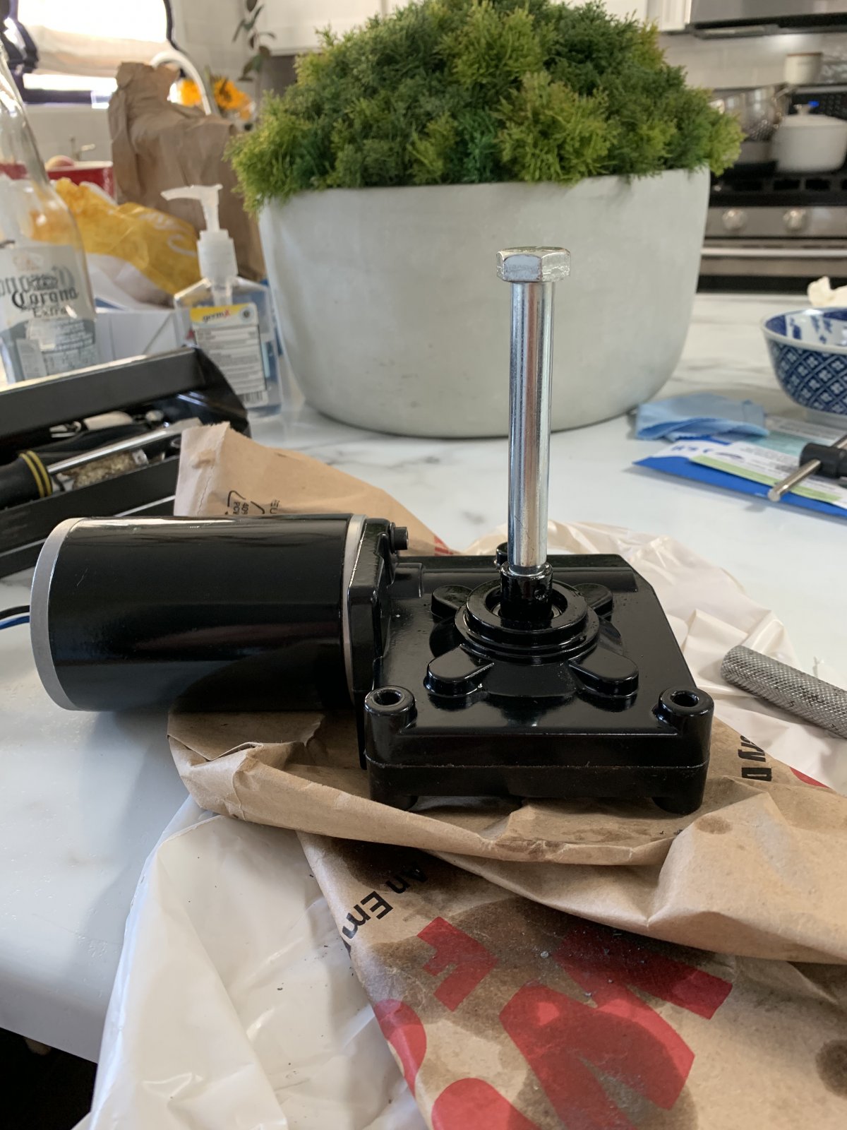

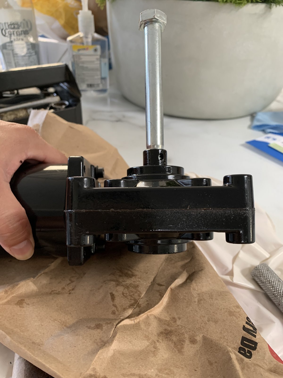

    Love your rig and it’s actually the inspiration to my Project.
    Dave, did you use a fully threaded (threaded all the way up and down) bolt?
    Or one like mine?

    Thanks. I went to the junk yard and grabbed one from a chevy truck.

    Yeah, that should work fine! Mine is probably chevy, but it has a rubber damper or something in the tranny side. I just welded around it.

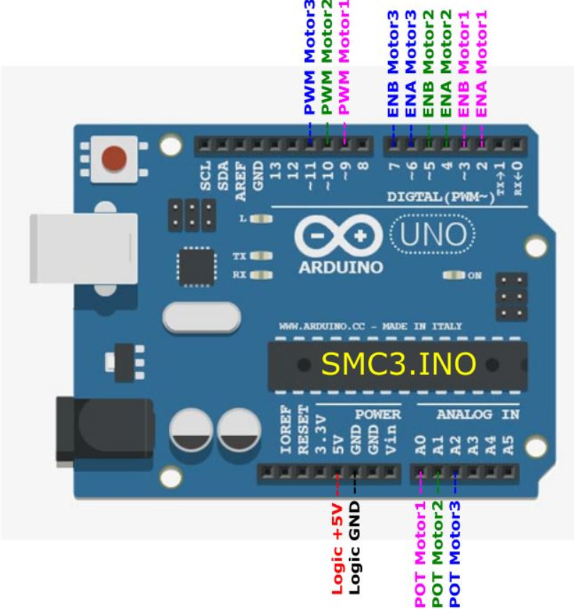

    Does the Arduino need to be powered sepertly or is receiving power through the ibt2 connected to the psu?
  12. Halloween2go
    Halloween2go Active Member Gold Contributor
    Dec 12, 2019
    202
    1,407Coins
    +176 / 1 / -0
    Good question.. But easy answer. The Arduino is powered by plugging into your computer USB which is 5Volts. The IBT-2's are just used to control motors, which will be powered by either a big battery or some type of voltage converter.. I just posted a video series on my channel focusing on all this stuff.. take a look if you have time DMAX
