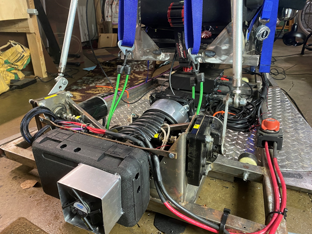

    Very ingenious, now I understand, those at the waist already hold you all the time and shoulder straps let's say they make a plus in the braking effect, very ingenious and cheap, good idea, thank you.

    Well I certainly can't take credit for this.. I saw it on BoostedMedia's YouTube site. And he got the idea from one of his subscribers.. But I will say, It adds to the immersion weather you have VR or not. Having those shoulder straps crank down on you when you are braking!

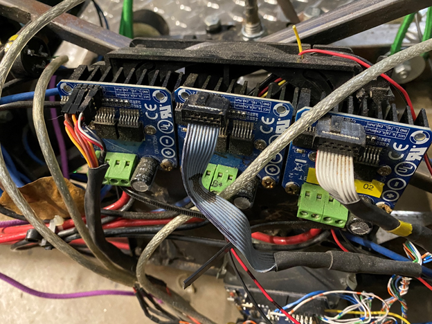

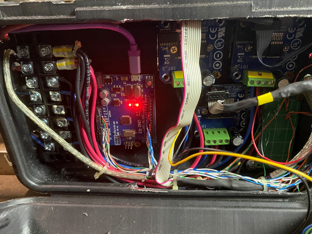

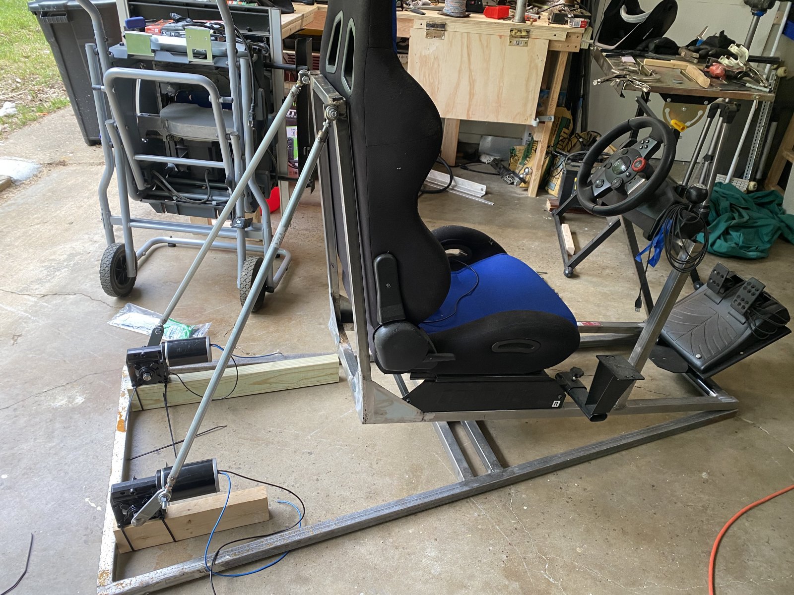

    Finally got around to building my control box, instead of just having the arduino's and wires just hanging out everywhere.
    I was experiencing intermittent issues with the hall effect pot being read by the Arduino and always solved the issue by re-seating the wires. But that was a pain. So decided to solder all the connections on the Arduino but leave the IBT-2 connections as 8 pin connectors.
    Here is a photo BEFORE I did the Rework (and you can see it in action in my videos) upload_2021-1-26_17-54-24.png
    I have a 120MM fan blowing on the IBT-2’s. You can see this was kind of an “initial” Proof of concept build for me. So now here is a photo of the new build. upload_2021-1-26_17-54-57.png
    So Here is my Solution. 120MM 12v fan blows on the IBT-2 fins. The Arduino and other connectors are in the Black Box. Also have a Celeron Fan Blowing at the other side of the IBT-2’s. I also reworked the wiring a bit as you can see in the next photo. upload_2021-1-26_17-55-34.png
    So Here I should have the ability to pull out an IBT-2 if it burns out (pretty easily) All the IBT-2 power wires are pretty small 8 AWG, but that’s what comes with the crab pot motors so that’s what I used. I have shielded wires from each Hall-effect POT. All wires to the Arduino are soldered. I used (old soundcard 10 pin connectors) to wire from the Arduino to the IBT-2’s.
    Also have several 12V sources also connected to power both fans and an additional 12V for the wind sim option up front of the rig.
    Initially, my rig grew from 2 DOF to adding the third IBT / motor combo for Traction loss. I was excited to get everything working so I just cobbled everything together. This was my first serious effort at getting it a bit more reliable. Right now I have about 20 minutes testing but no real running in so we will see if I need to make any more holes to vent heat. To me, it looks much better. But the proof will be in ‘reliable operation’ .
    I’ll post a video on youtube send it here this weekend. DMAX

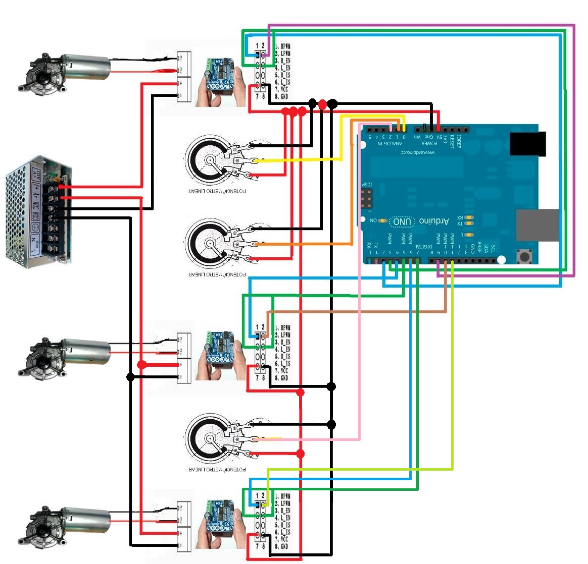

  19. pfm21
    pfm21 pfm21 build 3dof dinamic
    May 13, 2020
    157
    374Coins
    +34 / 0 / -0
    2DOF, 3DOF, DC motor, Arduino
    Hello Friend. I wanted to replace the motomonster with ibt_2. I followed the diagram I am attaching. to test I connected all the cables but only a motor and a potentiometer. when I try with SMC3 the motor only moves on one side. what could you be wrong? thank you
