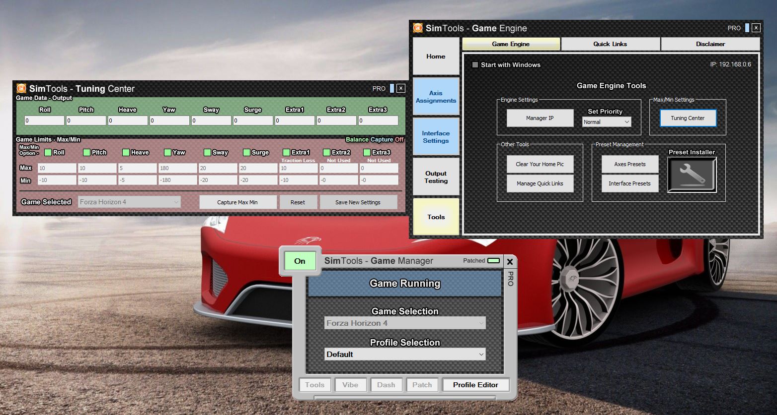

    Could anyone help me. In the Game manager the game is "Running" but I do not receive any data from the game.
    This problem is when i play FH4 or the crew 2. other games run very good.

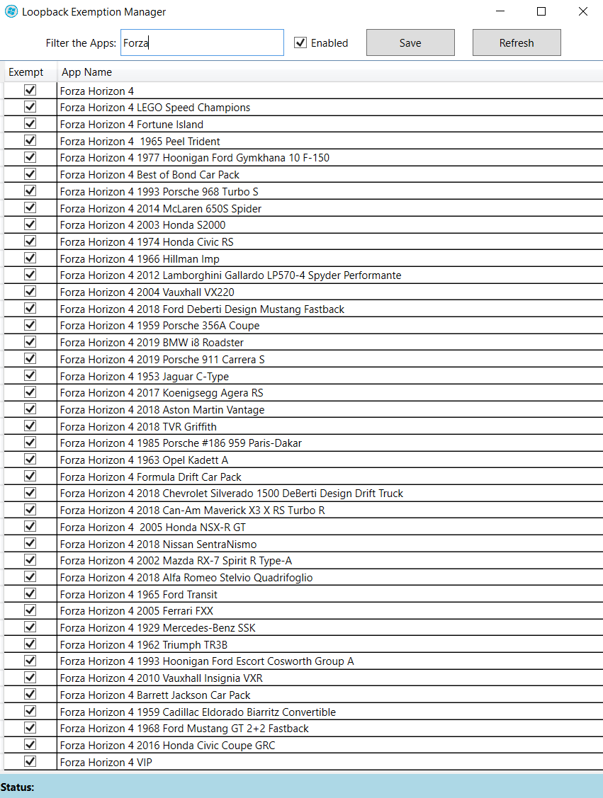

    Open WindowsLoopbackManager.exe as administrator.
    Then enable all the loopback for all the Forza entries and save.
    In the game enable data out on and ip 127.0.0.1 port 4123. That should work.

    Thaaaaaannnkkk you hug:
    It works :thumbs

    Just right click and start as administrator. You only have to do this once.

    What is the ip number of Simtools Game Manager? It should be also 127.0.0.1
