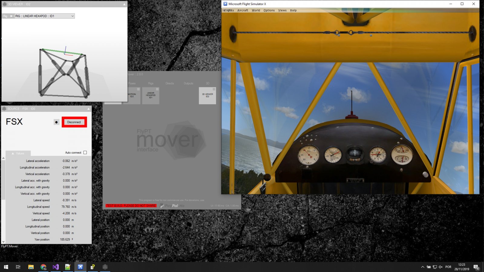

    Ok, SimConnect for prepar3D and Flight simulator.
    Are they the same?

    Microsoft sold their FSX code to prepar3D so they are the same but I would expect further enhancements have been made since then.

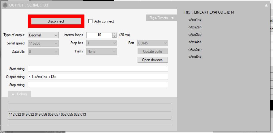

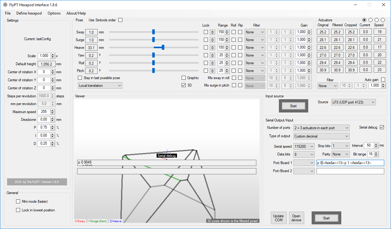

    Hi @pmvcda
    the last days I made the final wiring of the motor controller and the endswitches - heavy challenge so far with some remaining Problems with my endswitches
    Now one of my actuators is running stable with your mover interface - so big milestone is reached! :cheers
    But now I have the same problem, that once Stijn Carelsbergh had when he tryed to connect his Odrive to your older hexapod interface.
    The problem is, that one Odrive motor controller controlls two actuators via only one USB-port.
    Here you can see my output settings for the one running actuator. But as far as I try to add some commands for the other actuator the actuators doesnt run at all.
    So please could you give me a hint what to do? How do I have to write the command line?
    Thanks a lot!!
    Wickie

    Hi, just follow this:
    It's from one of is posts.
    I would write here the string, but I'm on the phone
    Just noticed he's using the same axis, but put there the axis you want to use
    See this page: https://www.xsimulator.net/community/threads/my-6-dof-project-with-bldc-motors.12918/page-3

    Hy @pmvcda
    Thanks a lot for your fast answer!! I apreciate your support very much!!
    I have already knewn the thread you mentioned and tryed to solve the problem this way - but I dont unterstand something:
    Stijn had the problem with the hexapod interface software - this looks different to the mover interface!
    I was not able to find there the: "number of ports".
    Stijn said: "I found the problem, the space between the commands was not expected." - ok, but which spaces? I tried to remove them all or only some, but it doesnt work.
    Do you mind writing the exact command line?
    Wickie
  17. pmvcda
    pmvcda aka FlyPT
    Nov 3, 2010
    2,237
    Portugal
    15,702Coins
    +2,669 / 17 / -0
    I think it's
    p 0 <Axis1a><13>p 1 <Axis2a><13>
    No space between the two actuators.
    Axis inverted, wrong units, missing values....
    But First step done to get FSX and Prepar3D in.
