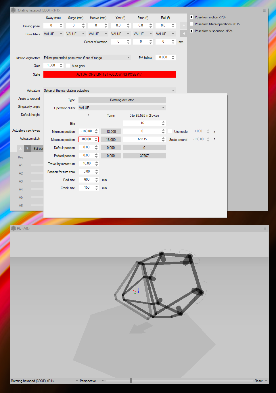

    1: In Mover 4, I have something like that, where you join modules and choose what to expose (big mess).
    The result is a module created from other modules by the user (but that is for 4.0, don't expect it soon)
    Here, it's harder to do it, but I can take a look at it (locking complete modules is easy, but just some controls...).
    2: To limit, we can use the filters. I removed the range in the rigs, now there's filters for all dof's.
    In the poses, i kept the range, but we can still use the filters and increase the range.
    I thought of removing the range, but it's faster to use it, specially in the poses.
    Actuators don't use range anymore, it's minimum and maximum now:
    Yes, there's a new actuator window...
    3: You mean in the pose from motion, when we add surge in pitch or sway in roll, a filter after adding them?
    I never did it, because in my thought, using multiple poses would generate the same problem, when adding them so the correct place for the logistic would be in the rig module.

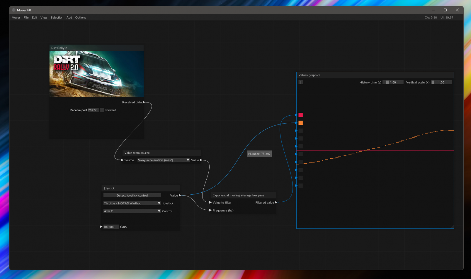

    Some coments about Mover 4.0:
    It will come some time after this release, but for now I have some performance problems with the UI and being done with a visual style, we can get a nasty spagheti pretty fast.
    Need to solve those and add more features before even thinking of releasing it. But honestlly it's my new baby, I like it, it's pretty for me.

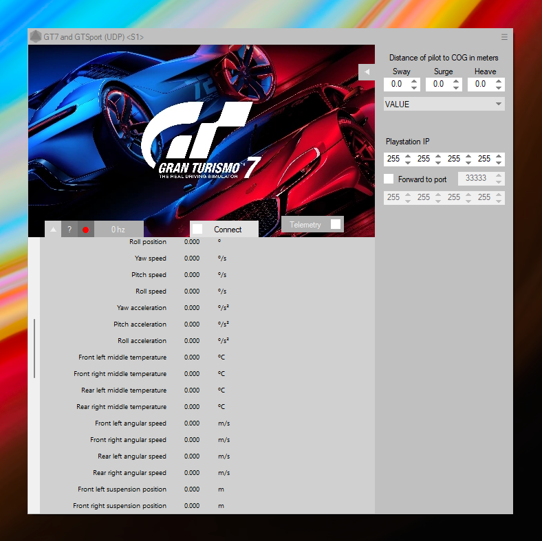

    Dear @pmvcda, thanks for your great project and post. Hopefully in the flypt version 4, you'll include Gran Turismo Sport and Gran Turismo 7 too. Simhub has them already associated so I think it will be great if could have them in flypt too. Overall, you're awesome mate..
  13. pmvcda
    pmvcda aka FlyPT
    Nov 3, 2010
    2,237
    Portugal
    15,702Coins
    +2,674 / 17 / -0
    That's already on the next release:

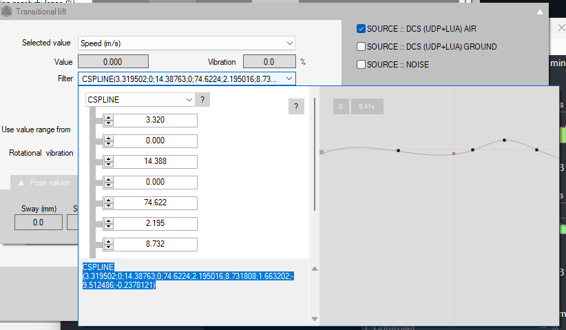

    Mainly it would be some love for DCS
    Automatic shutdown on kill/missle hit or crash. Or extreme tumbling due to gun hits. I found a export script for this but dont seem to be working for me. https://www.xsimulator.net/community/threads/flypt-mover.13464/page-161#post-238866 Added as attachment
    General:
    Fire gun
    Fire missile
    Dashboard/canopy shake/Shudders. Forgot the exact name on this.
    Helicopters:
    Rotor rpm
    Transitional lift (cant be done with curves, multiple factors)

    One more request. I dont know if this is a feature in 4.0 but if you can make it an option to not auto close the curve visual when you task switch that would be great. Im trying to tune a curve for DCS and speed but i have to choose DCS to have the inputs work. Doing so will close the curve im watching so its a lot more trial and error
    An option to keep this open so you have to click it again to close
  16. pmvcda
    pmvcda aka FlyPT
    Nov 3, 2010
    2,237
    Portugal
    15,702Coins
    +2,674 / 17 / -0
    Ok, will look at it. I think it's something easy to do.
    Maybe make it the topmost window... above DCS

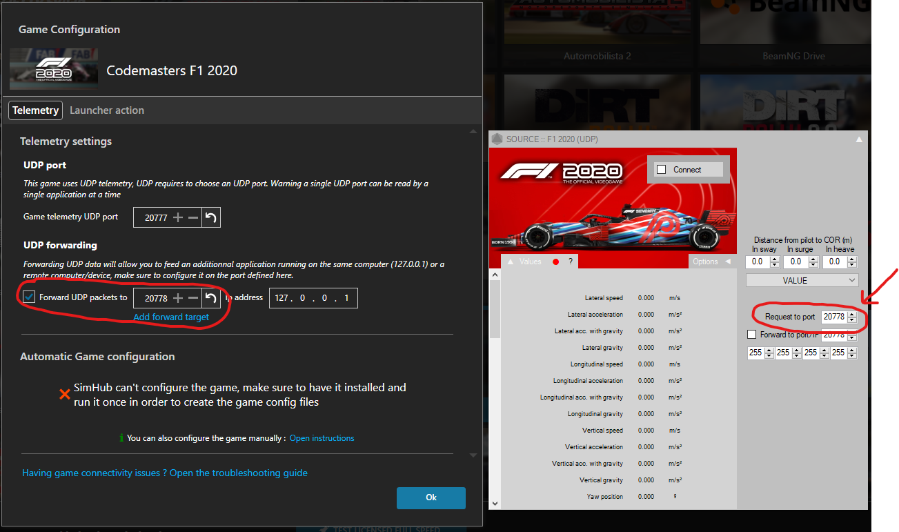

    Dear creator of the FlyPT Mover software, I would like to say a BIG Thank you for your awesome tool! I’m new to the motion subject (but old Simracer ;-)) and I’m blown away of the possibilities of your Programm - it’s a gift for the community.
    As I saw in this thread, there will be an update until end of this year and I’m excited about it. Besides the new WRC23 source, would it also be a new source for F1 23?
    I know that I can set the UDP to 22 and then it workings flawlessly with the F1 20 source but for some reason the telemetry won’t work at the same time in Simhub (dash, LED, wind, belts and so on). I know also that I can do a port forwarding - in F1 22 everything works parallel with no problems (motion from FlyPT and Simhub). So for now I have to decide for f1 23: motion or Simhub. Is there any trick or do I missed something? I use the latest version of FlyPT mover and the latest version of Simhub (9.1.12).
    Best Regards and keep going!
    Michal
  20. GWiz
    GWiz Active Member
    May 12, 2019
    191
    Dentist
    Aberdeenshire, Scotland
    1,509Coins
    +124 / 0 / -0
    Hi Michal, Have you set up port forwarding as shown here? This should allow both Simhub and FlyPT to work in unison: Screenshot 2023-11-23 185653.png
    I don't own the game myself, so I haven't tested this.
