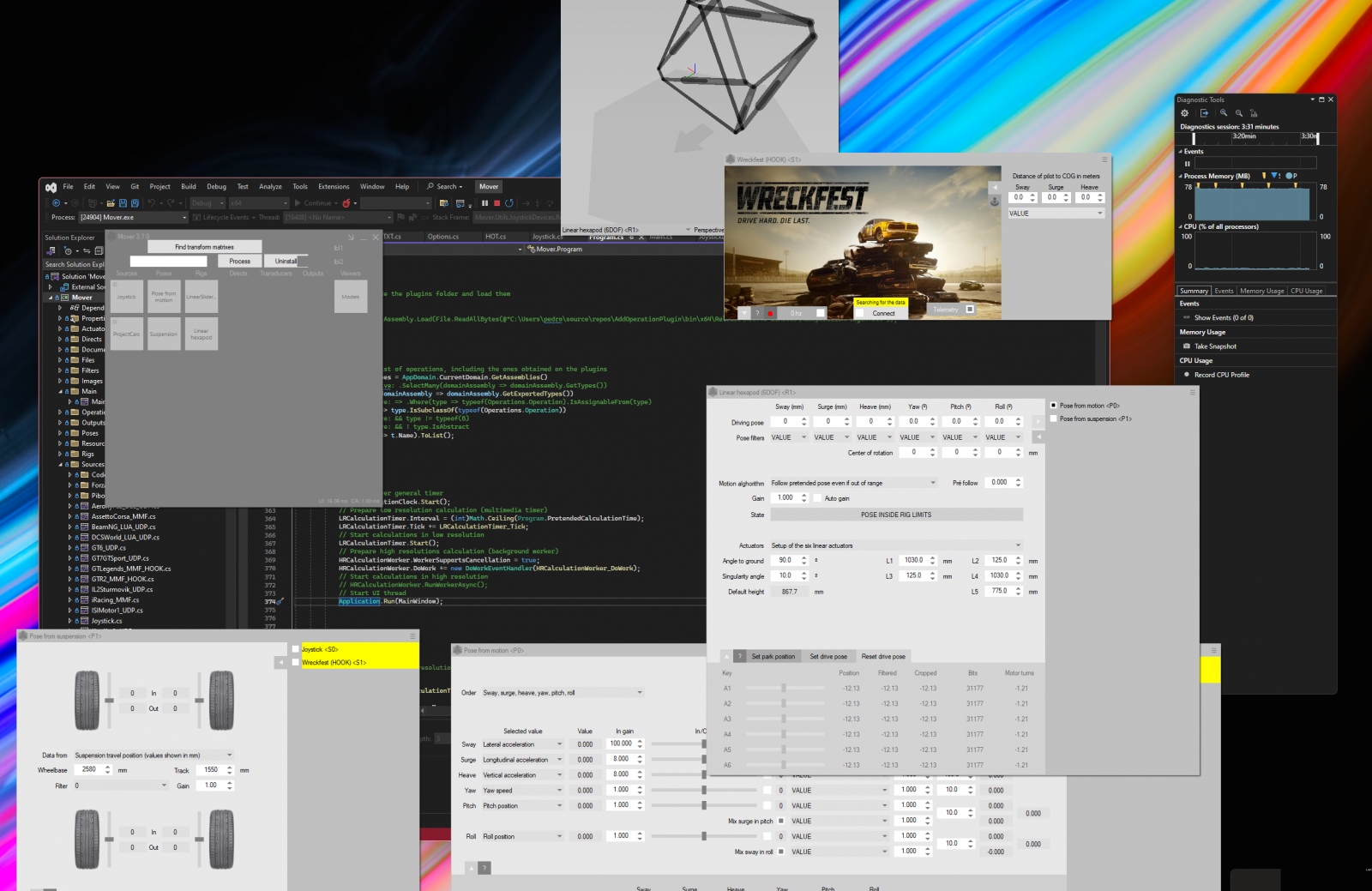

  18. pmvcda
    pmvcda aka FlyPT
    Nov 3, 2010
    2,288
    Portugal
    15,998Coins
    +2,742 / 18 / -0
    I'm working on it :thumbs
    • Like Like x 7
    • Friendly Friendly x 5

  20. pmvcda
    pmvcda aka FlyPT
    Nov 3, 2010
    2,288
    Portugal
    15,998Coins
    +2,742 / 18 / -0
    Not been around, but working on it... just right now:
    • Like Like x 10
