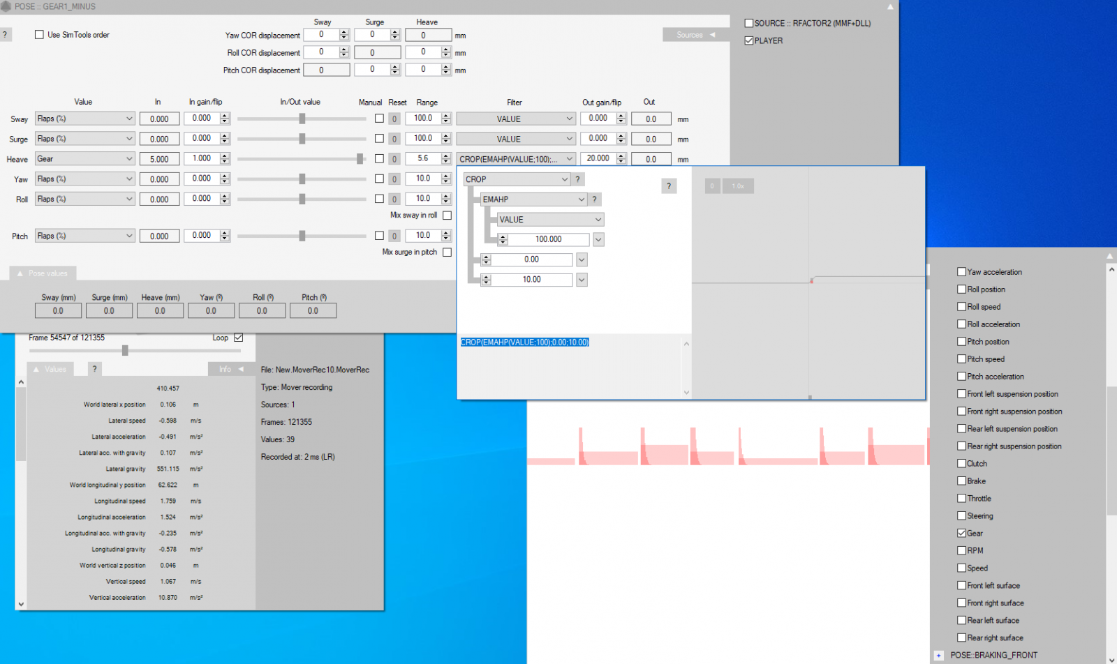

    First of all:
    this is an absolute genius project. I'm in love with the Mover.
    Secondly as it came up in a conversation recently:
    Is there currently a way to do something like "gear change smoothing"? If we mix in surge with pitch (or probably high surge values in general) it tends to make gear changes very harsh.
    Is there anything I could use/add to intercept a gear change event and add something like a spike filter on surge for a small period of time?
    I thought about using the "Basic DOF from Value" pose but that actually delivers the gear number and is not a gear change event - I'd probably have to add a custom input module detecting the gear change from telemetry and use that to add a SPIKE filter when the value becomes "1", not sure on how to do that though.
    Am I on the right track here?
    Apart from that: if I add a second pose for that surge spike filter - would it even be possible to apply a spike filter in that fashion on a DOF that primarily gets fed from another pose?

    The idea of using the dof from value might be the best.
    Use the gear value in a surge value.
    Maybe a high pass filter to get the gear change. You can also use some gain.
    something like:
    EMAHP(GAIN(VALUE;100);100)
    I did not test, so not sure of the results.
    That's something we have talked some time ago, but honestlly I don't remember what we have done.
    Using the EMAHP gives you two directions, on increase and on decrease.
    Wait...
    On high gears, the effect should be to high and we want the opposite, big effect in low gears.
    Try something like:
    EMAHP(GAIN(DIF(VALUE);100);100)
    The DIF gives you the variation of value, bigger the gain, more effect.
    To have lower effect on high gears, maybe subtract:
    EMAHP(GAIN(SUB(10;VALUE);100);100)
    So in 6th gear effect is 4, in 3rd gear is 7....
    With the above filter, the high pass is made on 400 for 6th gear, 500 for 5th... so on till 900 for 1'st
    But all in the same direction... damm, put the DIF again to get negatives and multiply with everything...
    MUL(DIF(VALUE);EMAHP(GAIN(SUB(10;VALUE);100);100))
    Since DIF is to sudden, put a low pass to delay:
    MUL(DIF(EMALP(VALUE;200);........
    The values in the high, low pass and gain need adjustments, but might give some effect.
    New version of mover as IF and it will make this easier to achieve.
    IF(DIF(VALUE);>;0;1;-1)... More soon

    I was actually thinking about wrapping/engaging a SPIKE filter on the surge axis.
    My first instinct was to create a pose that just counters the surge effect (doing surge in the opposite direction) but then I just saw the SPIKE filter being available at page 1 today.
    And I think that would be all we need - "if gear change, then wrap a spike filter around surge output with XX ms". Not sure if that can be done with today's version though. Am I thinking too small here?

    just build a Filter that creates a equal gain pulse for gear change only when engaging. But consider the gear change jerk is already included in the longitudinal acceleration.
    This could be nice for an additional tactile transducer effect but could not map a pose module to a transducer.

    My goal would actually be the opposite - gear changes can be too harsh when running high surge values, so I'd like to negate/limit the surge effect when changing gears.

    you can create 2 pose modules simultaneously, e.g. a high gain for surge (long.acc) and a low gain for gear change and map it together in rig module.
