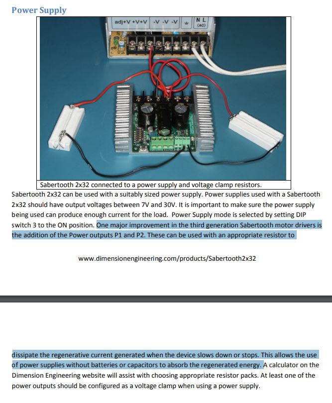

  14. creazyrider
    creazyrider Active Member
    Sep 12, 2017
    197
    france
    850Coins
    +56 / 1 / -0
    Hello Snaker07, like you i'm looking for a good controller for my 2DOF sim and I think I'll buy a Sabertooth.
    The two motors need 5A each so it would work with a 2*12A but I just read the datasheets and the 2*12A only works with battery supply.
    I want to power it with a 230Vac /24Vdc supply so the model working with it is the 2*32A v3. I think you need to add resistor between regenerative current outputs and power input
    Look at the Datasheet :
