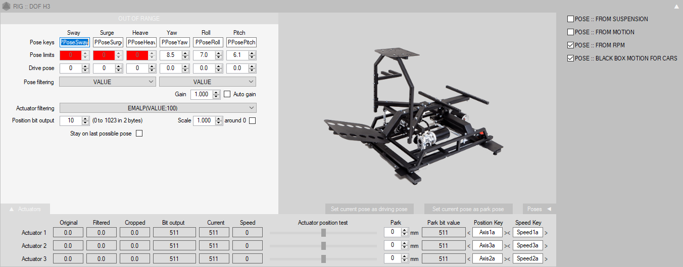

    The only way to limit the movement I see, is the limit range of the "from motion"
    but i don't know how i can limit the axis in "Back box motion for cars"

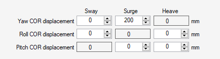

    This is my setup for my H2, if that helps. I defined the rig myself, as I changed the position of the main pivot for better balancing. I have the SFU gearboxes, with the link at the 85mm hole.
    The logistic filter is to drive the seat a bit slower at the extreme positions.
    I tinkered a bit with the middle position and the drive pose, because my actuators bump into the frame in the forward pitched pose. The middle offset shifts the range of motion (the angles up top) towards the back, so that I have still got the full pitch backward, but only limited pitch forward. The drive pose then corrects the neutral position to where it should be, i.e. forward of the middle of the range.

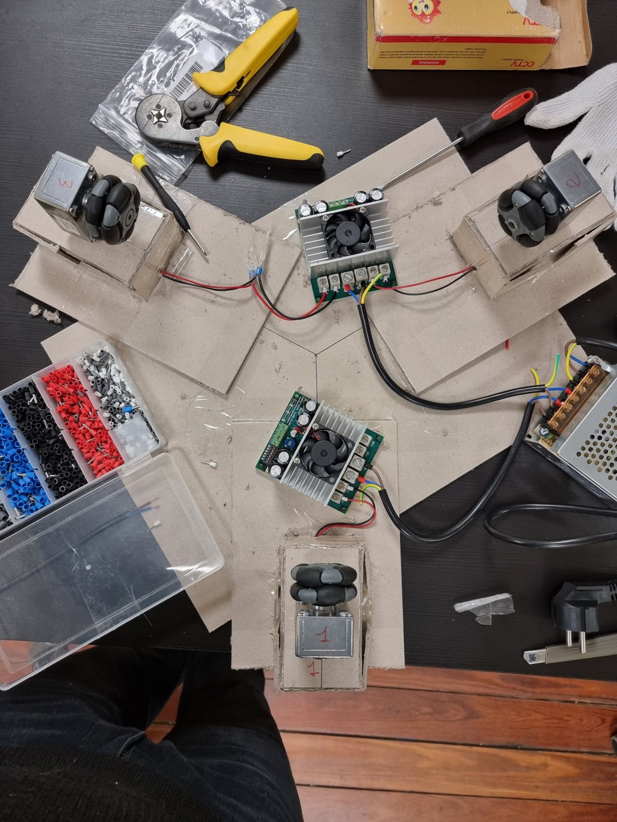

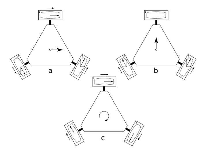

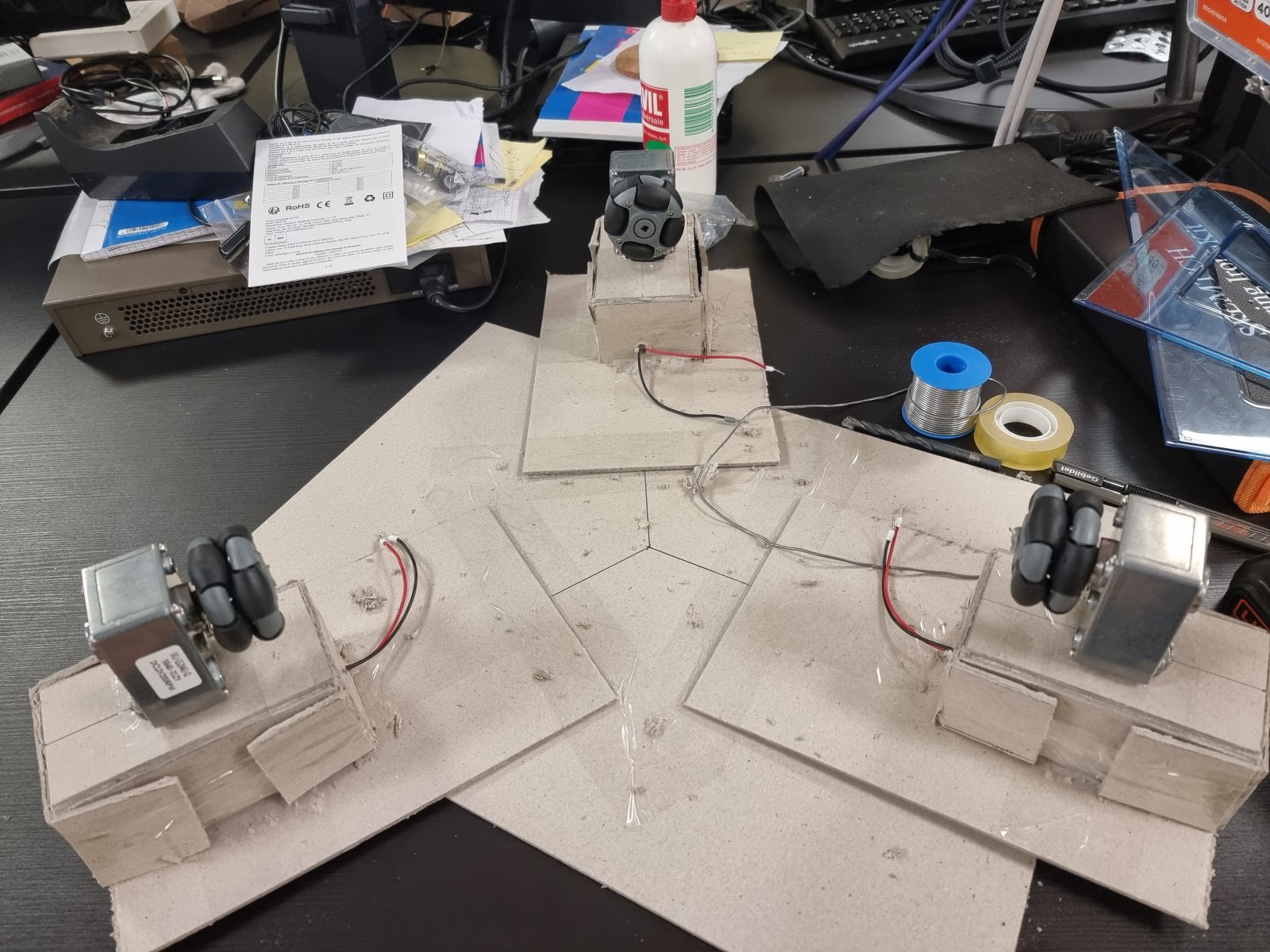

  3. pmvcda
    pmvcda aka FlyPT

    @Michail ,
    Limits is the maximum value for each DOF
    Drive is the position you consider the departure position and around wich all the pose values are implemented. This allows you to setup a drive position like you do in a car, like tilt the chair using a value in pitch of drive position.
    I don't understand what you men with 50º up and 50º down
    You can change the signal to minus in the pose gain, or use a GAIN(VALUE;-1) in the actuator value.
    But I'm not sure I understand what you mean.
    Imagine you are using a plane in Flight Simulator, where the data received is for the COG, in the wing of the plane and the pilot is seated maybe 10m ahead of the data. Here, you can put that correction.
    Use this for big values. For really small ones like cars, don't use it.
    Please show me a photo of the rig to see if you can set it in Mover right now.
    But I doubt.
    You can use Mover, but to have a 1:1 relation of the achieved pose with the rig and have the motion compensation working, it might be hard.
    Some other notes:
    You can limit values in the poses, but since you can use more than one pose in the rig, the sum of the poses might go beyond what you want, that's the reason we have a limit in the rig also.
    If you use just one pose, then it will be the same.

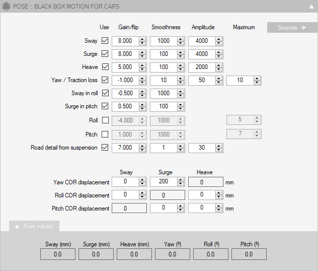

  5. Michail
    Michail Member Gold Contributor
    Jan 5, 2022
    165
    731Coins
    +28 / 1 / -0
    Thank you.
    I managed to setup again a mover profile for pcars2/ams2 with the help of your video where you setup with the preview version 2.9 dirt rally 2, rpm, suspension and motion.
    So it works for know. I have to fine tune a bit. My question is, when I setup a filter for surge emalp and emahp the values for example 150.0 is setup 15 or 1500 will be more harsch with high value than a small value?
    Second question is there a possibility to mix heave acceleration with pitch like surge?
    or to setup and assign axes from the ground a rig, like we do in simtools?
    I mean, that the rotational motor can driving 180 degre, 90 left and 90 right, i want to limit to 50 each direction.
    Like hexapod in the back, 2 rotational motor, and like simple 2dof 2 rotational in the front like the bike simulator

    The reason is, that my rig currently don't have "heave accelaration" as third DOF but "traction loss".
    When I upgrade to 4DOF with 4 rotational I need something like "4DOF rotational with 4 Motors 2 in front, 2 in back for traction loss.

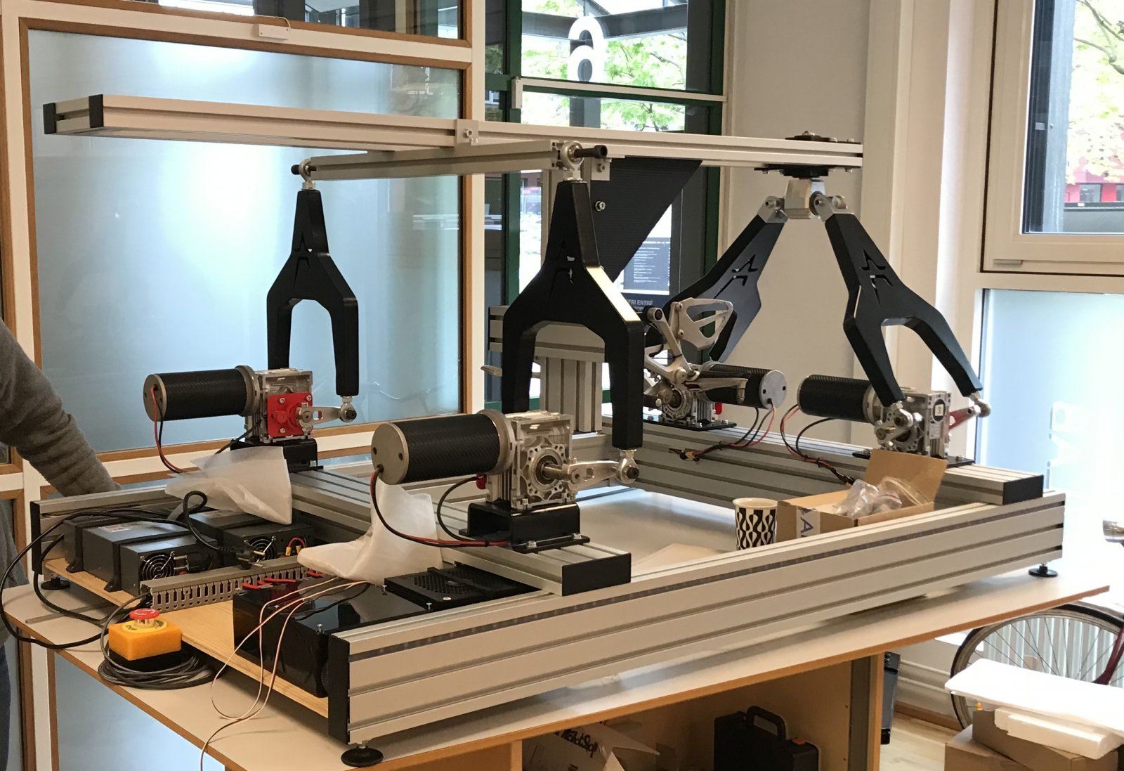

    can you explain for clarity what kind of DOF the Rig in your picture supports ?
  9. Michail
    Jan 5, 2022
    165
    731Coins
    +28 / 1 / -0

    post additionally a picture from your currently rig

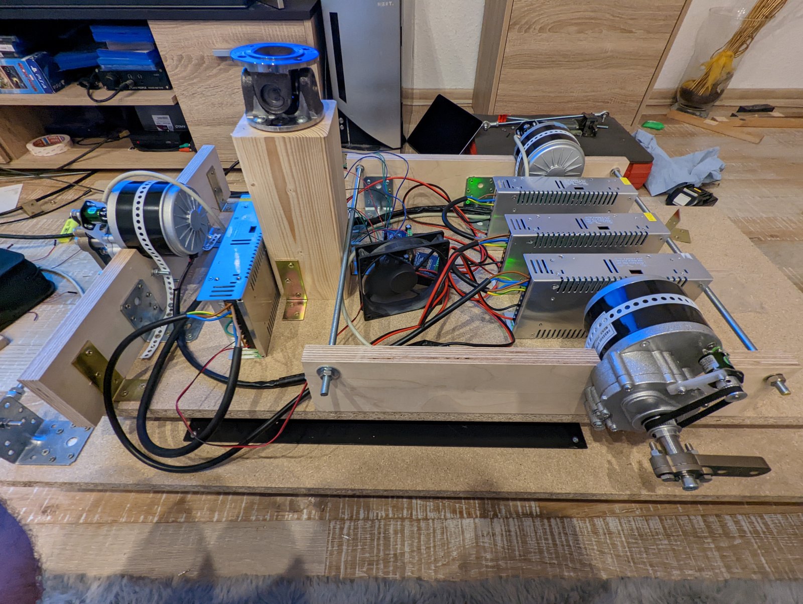

  11. Michail
    Jan 5, 2022
    165
    731Coins
    +28 / 1 / -0
    Here you go:
    Maybe better when you click the link at my signature for further information, so to be not off topic here.

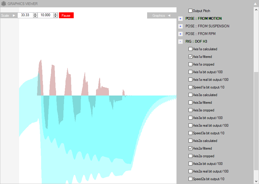

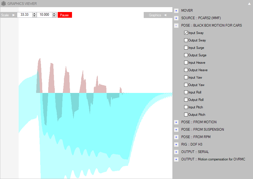

    Maybe some one can me explain why the sway in roll does ever leening to the left ehen I drive like a f1 pilot in the warmup lap right left to warm up the tires?
    Surge and suspension workd realy well but not sway.

    4DOF
    mover has graphic viewer, there you can see what telemetry data your game send

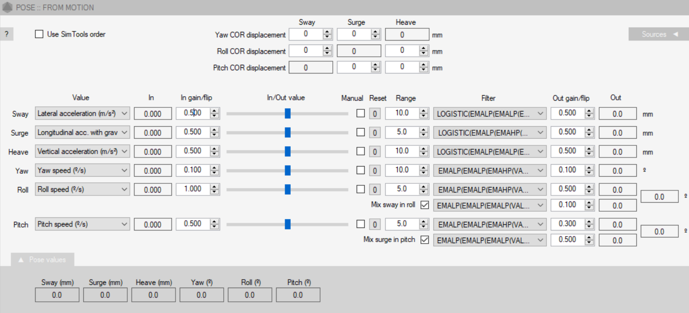

    Hi @pvmcda, I've got a question:
    I am using FlyPT Mover for my motion but i 've got some problem with set up parameter in FlyPT Mover.
    You could explain that to me about linkage between In gain/flip, Range, Out gain/flip. And Out (mm, rotation angle) of Pose and Range of Rig have any connection?
    Thank for talking the time to look over the question!

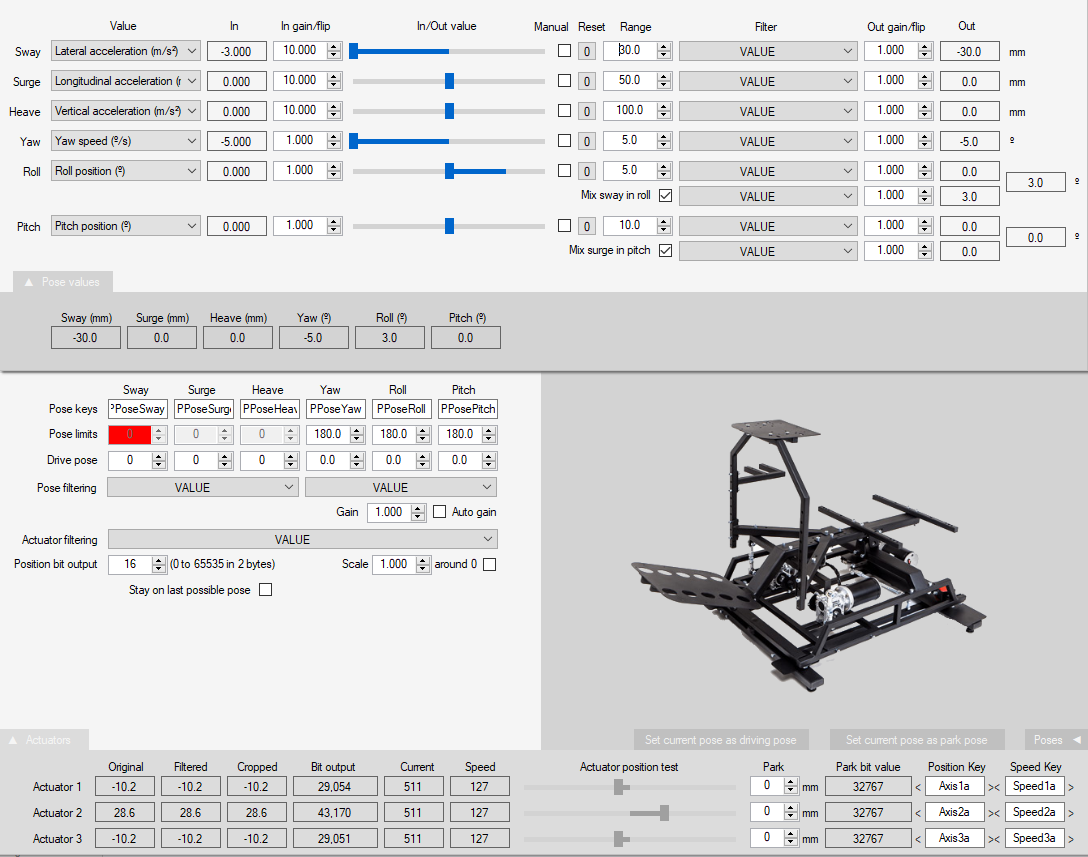

    Input:

    I know pvmcda is busy updating his software so I’m going to have a go at this as I understand it and use it. If I get it wrong, someone else in the community will need to correct me. Flypt mover also has a helpful website, that is still WIP. But if we give him time to complete his work, it may avoid the need for him to answer these queries individually.
    In gain is I understand the ratio of the value of the input being received from the game for the particular parameter. So if it is set to 1, the full value of that parameter is received. If it set to .5, half the value is received. The only adjustment I’ve made to these in default is roll for me is set to a minus because in fs2020, the parameter is reversed, left is right, right is left.
    Range is what you set for each parameter to suit your game and rig in mm or degrees depending on the parameter. So if you want yaw to be 20degrees (and your rig practically has the capacity to achieve 20degrees) then you input that range in. If the game goes to 20degrees but you have an in gain of 0.5, presumably you only get to 10 degrees.
    For out, this shows the live value of the data in game after gain, range and filters have been accounted for. You can’t adjust these, it just shows your final values. Anyway that’s how I understand. Hopefully not too far off the mark.

    That's it...
    Left gain is for the received value of the game, before filtering
    Right gain is after the filtering
    Range is the limits you want for this pose (not for the rig), you can add more than one pose to the rig so what reaches the rig might be more than what you define in that module (unless you use only that pose module).
    To limit the rig, you set the rig limits in the rig module

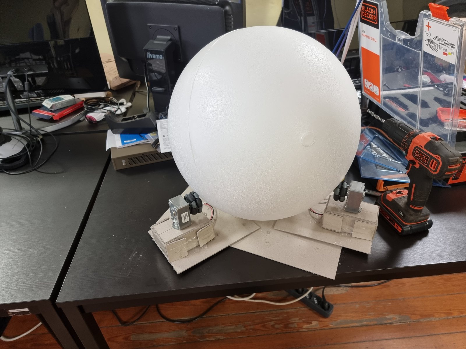

    Hello. So i finally got the 2x60 sabertooth. I successfully managed to connect 2 arduino uno via wireless and to share between then the orientational data from a bno055 sensor.
    Now, from my understanding, with the code found on this forum sps_8.2_softstart i can control one sabertooth per arduino. So i need 2 arduino uno to control 3 motors And divide the motors between 2 sabertooth. On top of that i need to modify the code to workout the math. How can i do it?
    Basically from my understanding i need to repartation proportionaly the power between the 3 motors to move the sphere in the desidere poistion. Here is a scheme of the theroy and some pics showing the prototype.
