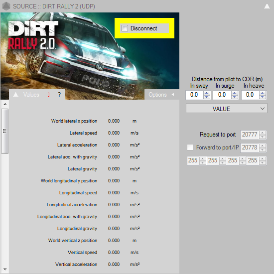

  12. zhai1987
    zhai1987 Member
    Sep 7, 2021

    I started dirt rally 2.0. He didn't get the data. How do I need to change UDP? Can you tell me?

  16. zhai1987
    zhai1987 Member
    Sep 7, 2021
    96
    320Coins
    +11 / 0 / -0
    2DOF, 3DOF, AC motor
    Brother, my problem has been solved. Now horizon 4 has not found how to set it... Can you help me?
