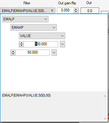

    lower EMALP to make it more responsive and increase EMAHP to slow the return(edited)
    HANNIBAL02/04/2020
    can u post a 3d graphic and the pose formula? @Insecta Tech - The Roach
    as an example?
    im very nooby mover user
    February 5, 2020
    Insecta Tech - The Roach02/05/2020
    First create a EMALP filter and change it to 50, then add a second filter on top of this for EMAHP and range that one to 500 and you'll see what I mean.HANNIBAL02/05/2020
    thanks.. ill try it out!!!! nice!
    Historiker02/05/2020
    I had not thought of upping the high pass filter to 500. For some reason I thought of it as a percentage with 100 being the highest possible. Thanks @Insecta Tech - The Roach for the tip.
    You're welcome

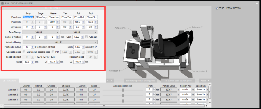

    Here is what I have learned (which is not much): I set the low pass filter higher to get the return to slow down. Higher LP = Slower movement. (I will freely admit that I do not understand what the HP filter does). My final filter settings for DCS is LP=200 HP=500 (EM)
    EDIT: Here is a screenshot showing how I set it up.

    To avoid confusion it would help to be clear about what filters are being discussed, so as to not have SimTools newbies scratching their heads and asking questions about missing SimTools filter fields ;)
    Edited the title as likely to turn up in a search on 'filters', where newbies could easily miss the thread section.

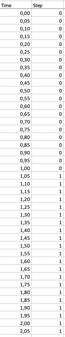

    Open up excel, right now! Then create a table like this one:

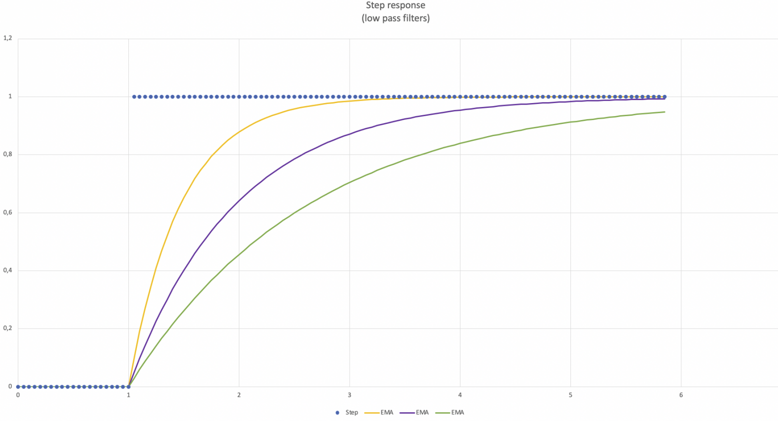

    Initially the signal is zero, but at a certain point the signal makes a step. This is the step input to our filter:
    Zero --> One
    Then you plot those points out in an X-Y chart (Not a line chart! Not a bar chart!) and what comes out are the blue dots in this picture:
    For every moment in time the input signal is represented by one of those blue dots.
    Now once you have that, we will create the output signal and we will do that for every point in time.
    For the first moment (Time = 0) there is nothing we can do. The output is always exactly the input. Sorry.
    But for all following points in time we will let the output signal drift slowly towards the value of the input signal as if it was magically attracted by it through a rubber band.
    And we do this by allowing the output signal to make a step towards the value of the input signal. But this step only bridges, say, 5% of the distance.
    These 5% are our adoption rate! The amount by which the new output will close-in on its "target". Remember, we want to "dampen" the output, so we are not letting it jump all the way. It may only approach the value of the input whatever that is by 5% of the distance at a time.
    The adoption rate is called Alpha. It is a measure for how "agile" we want our filter to be. It must be between 0 and 1.
    In our Excel sheet, for every point in time, we can calculate the Output signal with the formula:
    NewOutput = Input * alpha + PreviousOutput * (1-alpha)
    What we are doing is composing the new output out of the previous output and the input. But every component gets "weighted". The input gets 5% weight (alpha) - The current output gets 95% weight (1-alpha)
    Just do this in excel, it will make you understand!

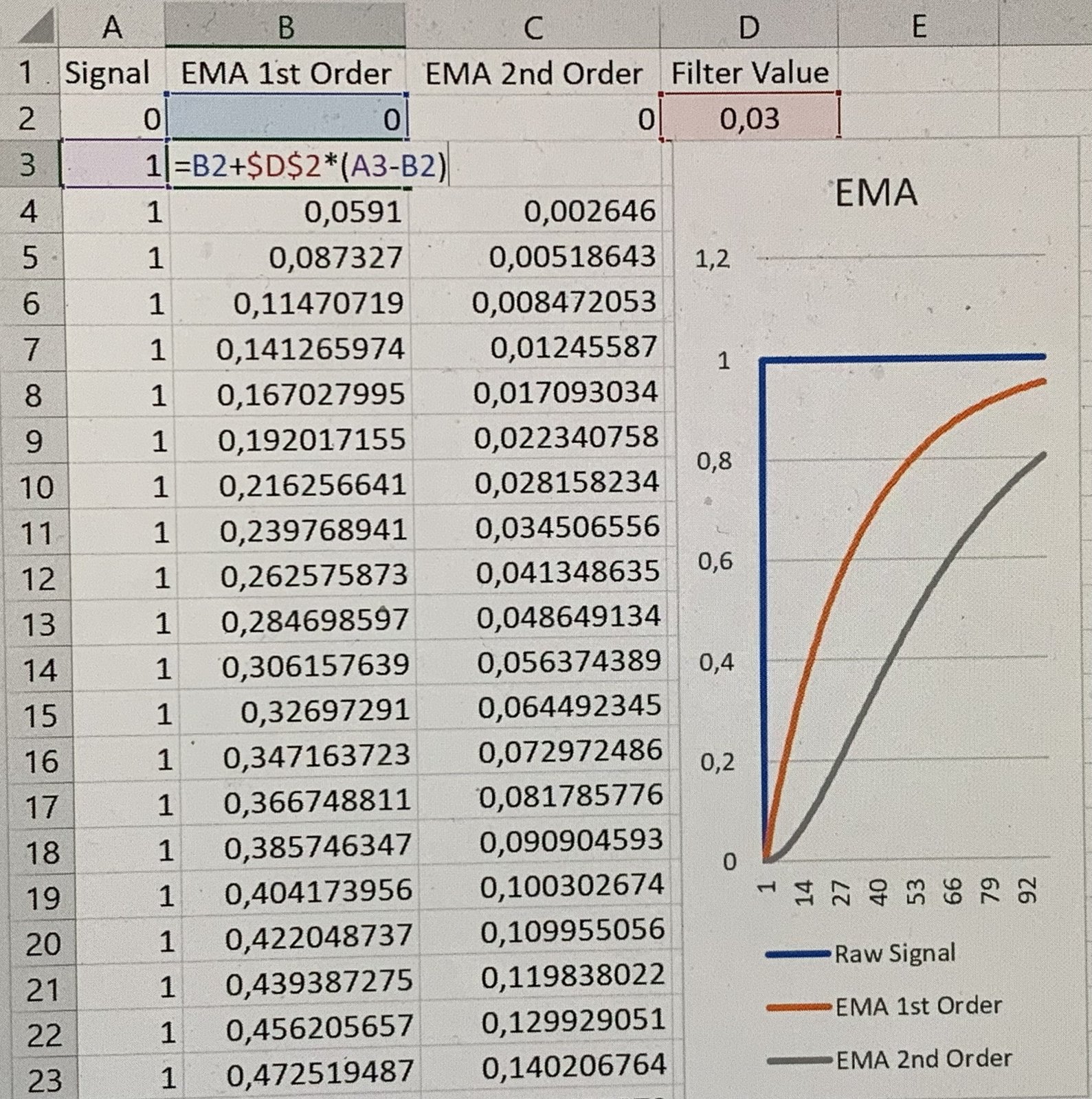

    And here the next step. Changing the Excel sheet to be able to play around with the parameters:
    Notice that there are two ways to make the filter react quicker:
    1. Increase the adoption rate
    2. Increase the frames per second (decreasing the time interval)
    Follow along the exercise and play around with those parameters, see how the output curve changes. Get an intuitive understanding.

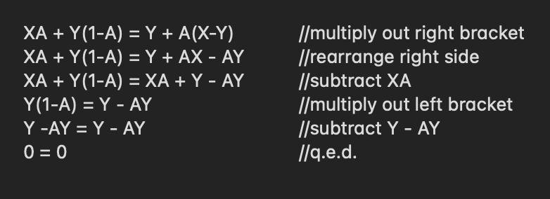

    Fantastic pedagogical approach but this (1-alpha) is kind of mysterious to me.
    @Dirty , to represent EMA, why not just use the logic : filtered output = previous output + filter amount * (input signal - previous output)
  16. Dirty
    Oct 15, 2017
    736
    All the way up front.
    7,835Coins
    +864 / 2 / -0
    Hey :)
    These formulae are both correct. In fact, both are equivalent! :) Isn't that cool!!!
    I was almost about to ask you to just "take it on good faith", but knowing you like I do.... I knew you were never going be satisfied with it and that you were going to come up with a proof of your own sooner or later :-D So I figured I might as well do it myself:
    One formula is....
    The other formula is...
    ...and we want to show that they are equivalent, so we write down...
    On the right side we multiply out the bracket and we get...
    We can rearrange that to...
    Now we subtract "NewInput*alpha" on both sides:
    Next we multiply out the bracket on the left side:
    And if it is not obvious already, we subtract "PreviousOutput -alpha*PreviousOutput" from both sides:
    q.e.d
    HA HA!!! I just love math!
    And btw, thanks for asking. I think I never would have taken the time to do this proof if you hadn't :thumbs
    It's probably easier like this:

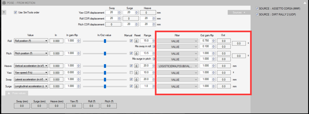

    i have an exapod with thanos moved by flypt mover
    i mainly use iracing or assettocorsa competizione
    i feel "vibrations" of my body when braking (with the standard profile "black box" in ptmover
    do you know in which way i can remove this virations without loosing the "real-feeling" in the movement of the rig ?
    thx so much for support
