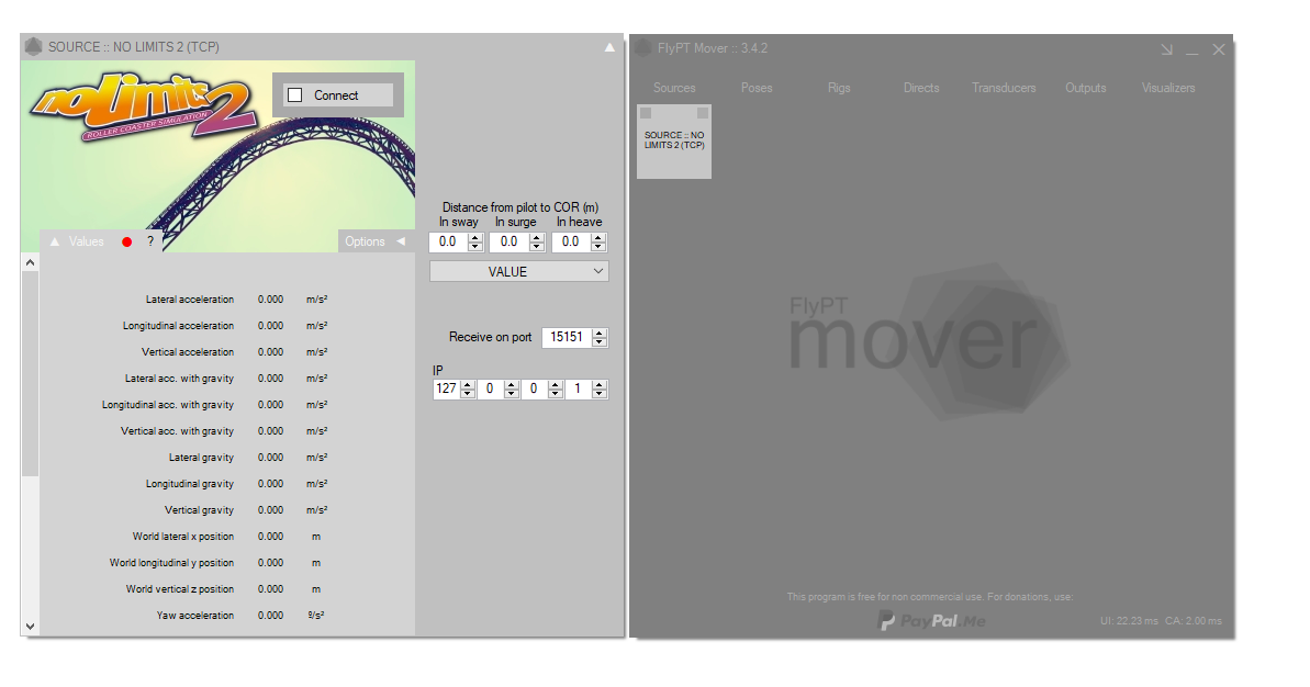

    Sry short Question. Am i blind, or is there no support for "NoLimits 2 Roller Coaster Simulation" ?
  2. Historiker
    2,162
    9,205Coins
    +2,173 / 19 / -1
    It is there, Source: NO LIMITS 2 (TCP)
  3. Bastiuscha
    Bastiuscha Active Member
    Apr 1, 2017
    291
    750Coins
    +191 / 2 / -0
    Yes... found it by my self. You was faster. On the webside i did not found, but in the tool himself.
