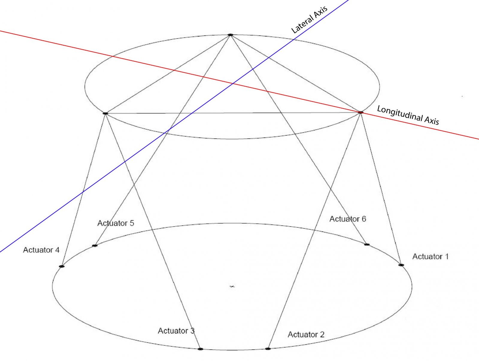

    You have this:
    For you rig the string should be: (IF YOU DON'T CHANGE THE CONNECTIONS)
    <255><255><Axis4a><Axis5a><Axis6a><Axis1a><Axis2a><Axis3a><0><0><0><0><10><13>
    I'm getting confused :confused:.... I think it works this way.
    WAIT! If your numbering, is the way they are connected to the AMC, then it should be:
    <255><255><Axis6a><Axis1a><Axis2a><Axis3a><Axis4a><Axis5a><0><0><0><0><10><13>
    :confused::confused::confused::confused::confused:

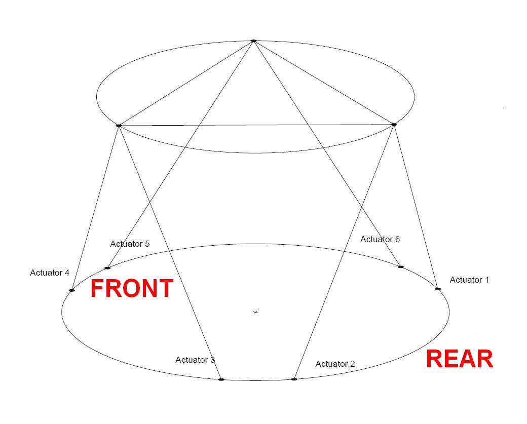

    I'd advise against changing the standard order that has been used for years now with Ian's Bff 6dof software and Hexpod plugin... it would be impossible to use them if you need later.
    Please use this order here:

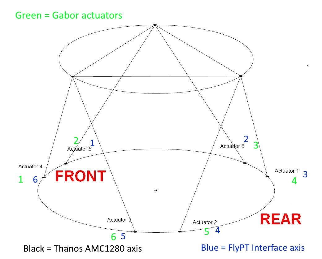

    My rig is the same like this but front is rear and rear is front. Because I have a pair of actuators in front and the other pairs are rear right and rear left.
    Like Thanos's first rig http://motionsim.blogspot.com/2013/04/some-photos-of-6dof-platform.html?m=1
  4. pmvcda
    pmvcda aka FlyPT
    Nov 3, 2010
    2,237
    Portugal
    15,702Coins
    +2,674 / 17 / -0
    But you can use the same order, you just have different spacing between them and that is setup in the FlyPT Interface when you define the rig

    Ok then, then your existing wiring is correct and compatible with the 6dof standard.
    One difference hexpod plugin and Ian's software had, the front and back are opposite, so Ian added direction reversing on his roll pitch and sway surge axis (like mirroring) to accommodate for platforms that needed to have the cockpit lower inside the cockpit thus the legs positioned between the actuators...
    So flypt needs to add this option too...

    Yes I use hexpod this way as you said, mirroring roll pitch sway surge, and it works. Most of members used this geometry for wormgear motors, except who used linear actuators.

    Because for a beginner the front is usually there where the screens (or the feets) are located, I've seen so many people doing cabling mistakes because of this diagram.
    If we do abandon the concept of REAR and FRONT as I was advising many times, we will save our self and the user a big amount of time correcting misleading informations.
    I see the blue and black numbering being the same and correct (flipped by 120 deg.)
    Green numbering seems wrong.
    @Gabor Pittner
    Although your cabling respects the longitudinal axis, being out of standard, you may experience issues if you want to drive your platform with Ian BFF software.
    The actuator 1 and 2 (first pair) should correspond to the top and not the base of the triangle of the upper platform regardless if it's your front or back.
    Because REAR and FRONT are swappable, I would rather use this for reference:
    I hope it helps.

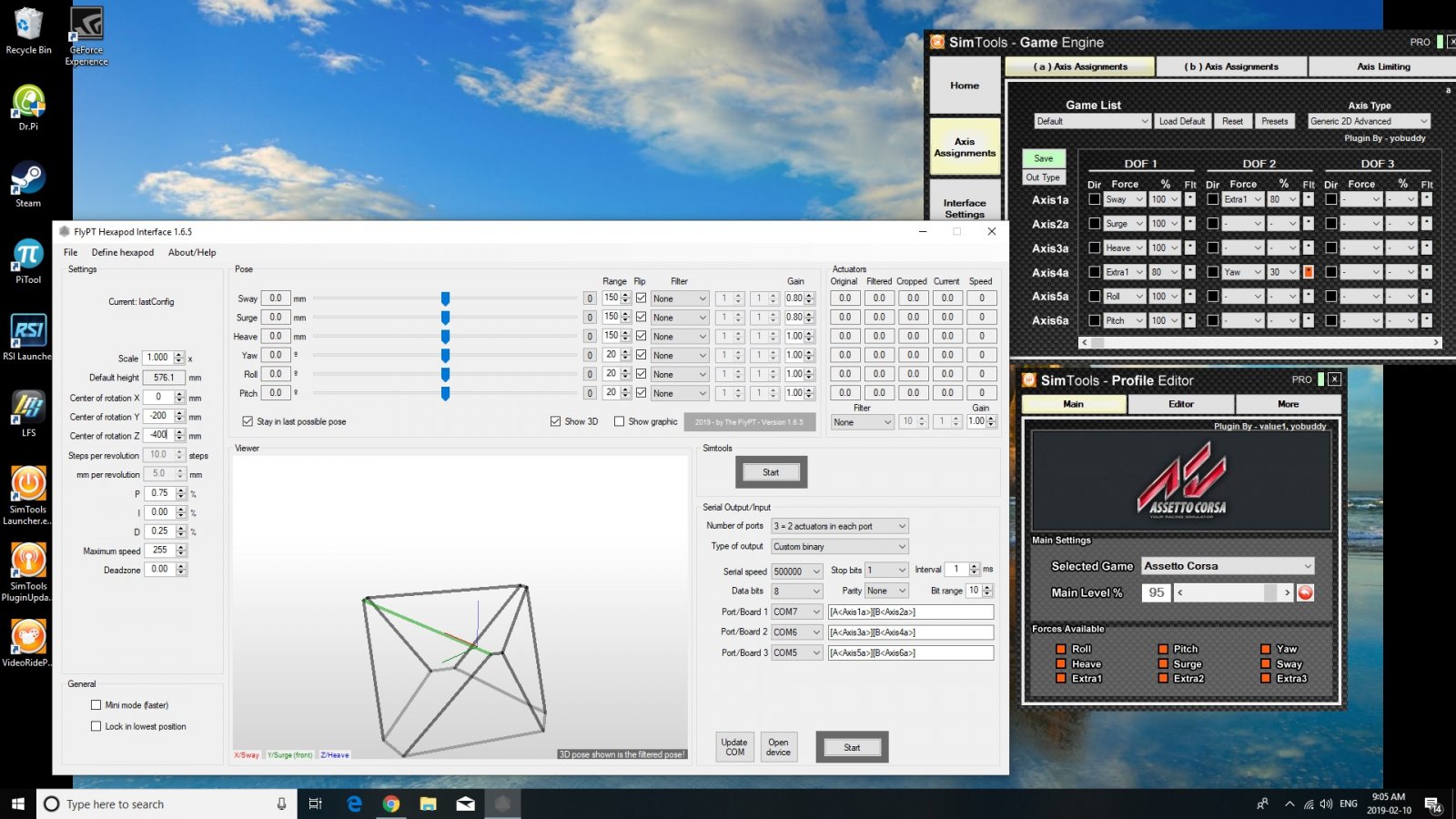

    I got it to run with Asseto Corsa. I uninstall Simtools and reinstalled it with Antivirus off/Windows Defender off. I did the same for the plugins and I made sure to install all 3 files inside the plugin, and not just the dll like I thought at first.
    It works well. I only have 2 issues so far. I get the feeling of inverse roll in the curves, even at really low speed. I need to find a way to adjust this. But when I hit a side bump, the roll effect is as expected.
    But my real problem is yaw. As I turn around the track, I get violent yaw correction once in a while. I even got a track with a long straight line right at the correction point, and I was rotate from side to side like a new paint bucket in a shaker. I have the washout set in Simtools. What more can I do to get ride of that?
    Actually, I have a third problem. After 55 minutes in Asseto, I suddenly felt so sick, I had to stop right there and get out off the rig, otherwise, it would not have been pretty. I had to got to bed and I still feel a bit dizzy a few hours later. There is not much I can do, I will have to ease into it. I guess that's simply because I'm getting old. You know, old enough to know what a 8 inches floppy disc looks like.

    Saw the video on your thread. It's working! Now it needs to be tuned.
    First, if you think roll is inverted, try to swap it on the interface, in the checkbox next to roll.
    You notice the error in larger movements. Corners with gforces.
    When you pass over a corrector, it's mainlly vibration/short movements and you can't see if it's moving to the correct side.
    The yaw problem is strange. You might have used yaw in yaw and you should use extra1. Can you show me the settings in simtools?

    Sure:
    I still have to enter Center Of Rotation X and Y by hand every times as they are not saved. And I cannot use the lowest position as it does not go back up.
    Yes, the yaw problem is the worst. I would really love to get rid of it.
    I've notice that the rotation needs to be dial down. With the pitch, if the game goes down a hill, I'm taking a dive. If it goes up, I'm climbing the Everest.
    I tried to inverse the roll. It was bad, really bad. I put it back right away. When my right wheels are passing on a bump, the right side goes up. So, it's set like it should.
    I guess now, I have to test one force at a time and play with range and gain until it feels right. A mute for each force would be useful then.

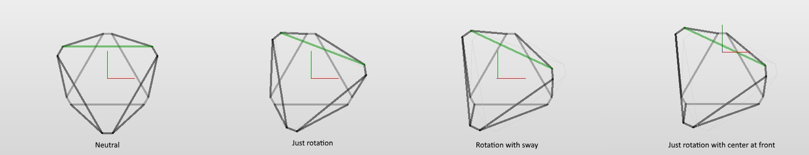

    In the next images we see a rig from top view.
    Left image is neutral position.
    Second image is just rotation.
    This rotation is generated by extra1. But since you want it to be traction loss, we need one more step to simulate the back end slipping.
    That's what we have with the 3rd image. We add sway.
    To achieve this, besides the normal sway, we need a sway related to extra 1.
    The 4th image is just rotation but with the center of rotation at the front, just for showing the result is the same.
    But in 4th image, center of rotation is at front, while in the others it's still at the real center.
    So resuming:
    We add extra1 in sway to compensate rotation and simulate traction loss with a rotation around a point at the front.
    In Yaw, we use extra1 and a bit of yaw. The yaw here is just to feel a bit of the corners. It has nothing to do with traction loss.
    For the scale, yes, it makes distances wrong. In reality, everything is relative.
    It's more to be sure we have precise movements, and that when we say 100 mm in sway, that's exactly what we want.
