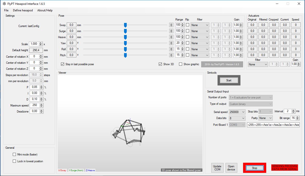

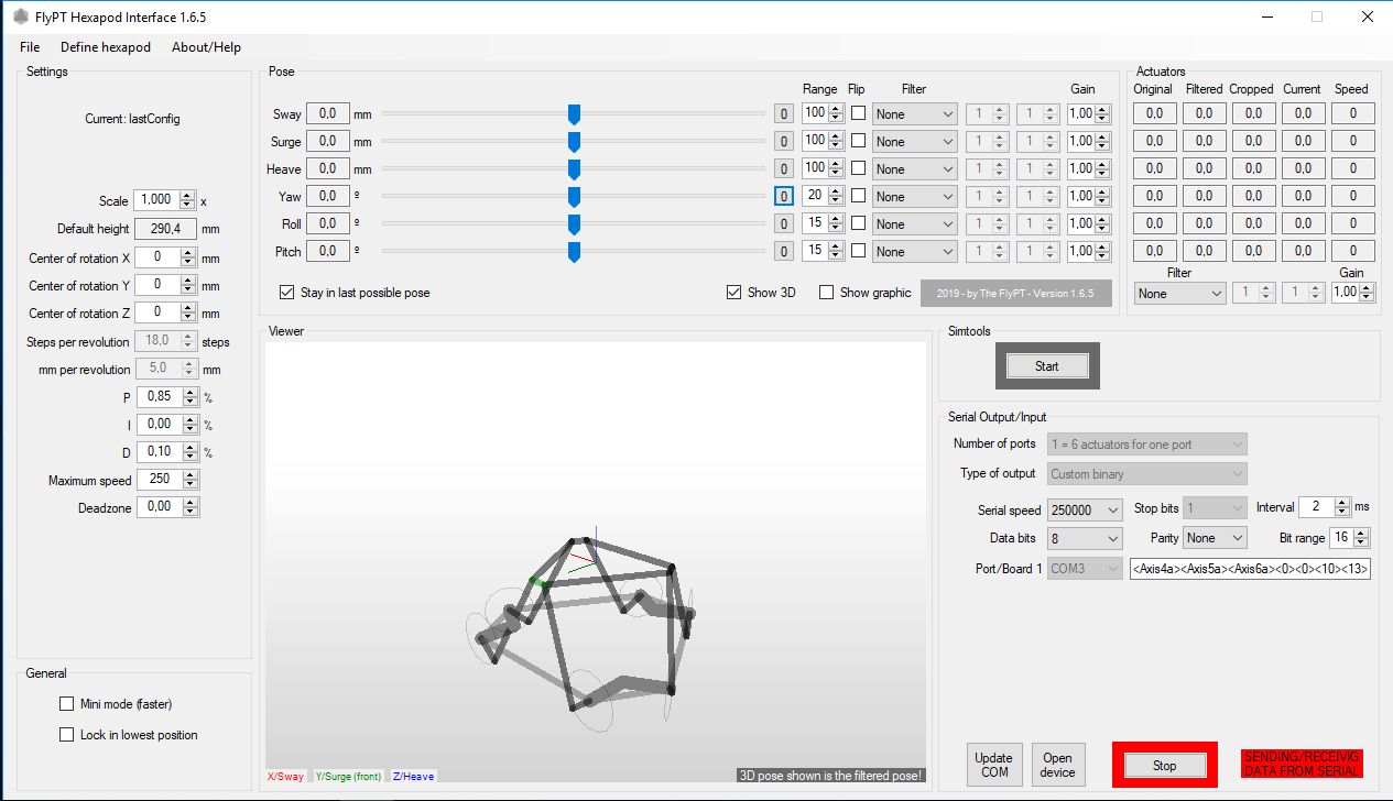

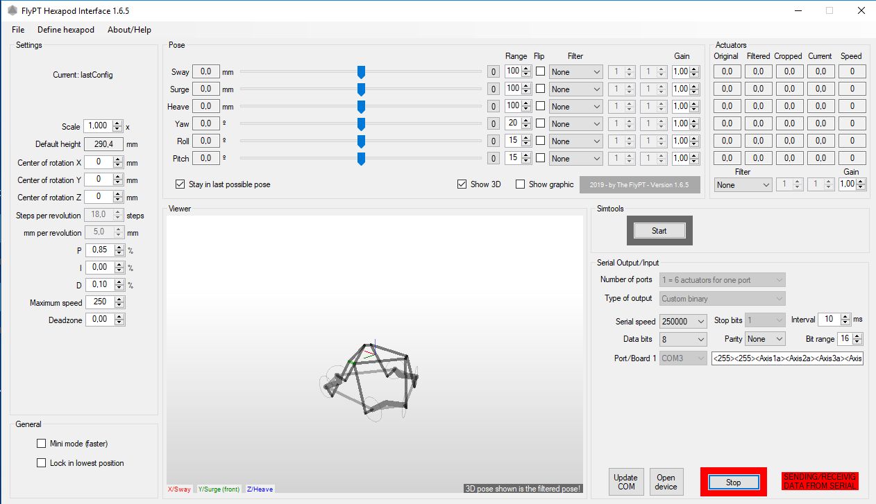

  13. Gabor Pittner
    Gabor Pittner Active Member
    Oct 25, 2018
    203
    Szekesfehervar Hungary
    1,396Coins
    +89 / 0 / -0
    Hi @pmvcda I tried to test with my Thanos's AMC1280USB board, but it didn't work unfortunatelly, I tried with this configuration that you wrote, and also what @Thanos has said. But FlyPT does not link to the board. :(
    However it works with hexpod interface.

  14. pmvcda
    pmvcda aka FlyPT
    Nov 3, 2010
    2,272
    Portugal
    15,902Coins
    +2,716 / 18 / -0
    I saw in @Thanos blog, that we need LF and CR chars in the end of the string:
    <255><255><Axis1a><Axis2a><Axis3a><Axis4a><Axis5a><Axis6a><Axis1b><Axis2b><LF><CR> <<<< This is wrong! For correct string, see first page of thread!
    We have to replace LF and CR by the corresponding bytes. So it should be:
    <255><255><Axis1a><Axis2a><Axis3a><Axis4a><Axis5a><Axis6a><Axis1b><Axis2b><10><13> <<<< This is wrong! For correct string, see first page of thread!
    Can you try?

  15. Gabor Pittner
    Oct 25, 2018

  16. pmvcda
    pmvcda aka FlyPT
    Nov 3, 2010
    2,272
    Portugal
    15,902Coins
    +2,716 / 18 / -0
    Can you take a screenshot of your settings
  17. pmvcda
    pmvcda aka FlyPT
    Nov 3, 2010
    2,272
    Portugal
    15,902Coins
    +2,716 / 18 / -0
    And try this:
    <255><255><Axis1a><Axis2a><Axis3a><Axis4a><Axis5a><Axis6a><0><0><10><13> <<<< This is wrong! For correct string, see first page of thread!

  19. Gabor Pittner
    Oct 25, 2018
    203
    1,396Coins
    +89 / 0 / -0
    Unfortunately still doesn't work :(
