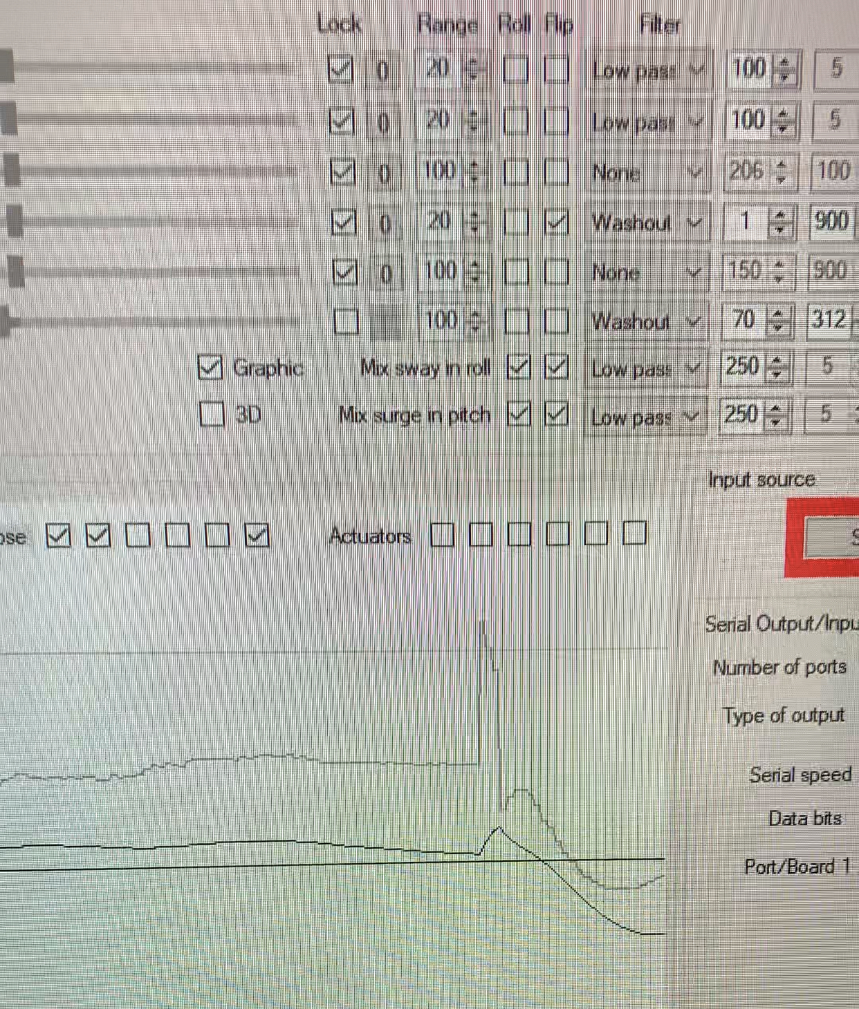

    It’s absolutely great we finally have someone who’s understanding the capital use of proper filtering.
    I am sure you agree, that’s the key to get into a convincing result.
    Although the result is already spectacular with ema dema I still have a small issue.
    It’s mostly about the longitudinal acceleration in xplane while the plane is on ground and deals with the friction while braking.
    Having a chance to chat about it with Austin, he did his best to tweak his ground model and statuated that the physics there correspond to what he is expecting.
    As I don’t have any knowledge about this topic I will try to present my issue in a very simplistic way:
    precisely on the moment when the plane stops, we have a opposite longitudinal force going up and down with a pretty big spike.
    Although your washout and smoothing do the job in a very coherent way I still have a pretty big „kick“ especially when I put the surge on the pitch axis.
    Do you see any other filtering method which could “round” or reduce this huge spike and keep the other smaller details present?
    Here is the curve:
    Trying to achieve what I want with your band pass but somehow not getting it.
    That’s why I was thinking about “second order” filters.

    I can take a look at other filters, but they need to be fast.
    I have the code for non exponential laying somewhere, but they are not going to add anything to the result.
    I might add them just for testing, but it might generate more confusion than help.
    I will look for some efficient 2nd order filters. But I don't want to guaranty anything :thumbs.
    Right now I have a big mess with inputs on the new interface version.
    I'm making it modular and trying to make it work for remote and with games (like XPlane I think) that need to receive info to send back what we want.
    Also, I want to have multiple inputs/sources if we want to (some games use it) and allow the input of more parameters.
    It might not be visible in the new version, but I want that change made internally.
    Should be in small steps, but this one is large, and I'm also working on a kind of auto calibration for the next version.
    Might not look interesting, but what I'm making right now, might solve the problem of XPlane, because in the future I will be able to treat inputs in a separated way, and mix them in the end.
    When I say treat, is apply filters. When I say mix, is mix the effects to obtain a result.
    So mix landing gear info with aerodynamics info generates a result. If XPlane allows (still have to take a better look at the telemetry).

    For xplane, I strongly recommend you take the main telemetry from “motion platform stats” which’s adding the longitudinal approximation of “center of rotation” unless you want to apply same formula internally to make it more crossover for other games.
    What would be good it is the similar approximation for the side axis as well (which xplane doesn’t have for the moment) which would shift the center of rotation from “between the seats” to the capitain seat.
    The landing gear force you can find under the checkbox 66
    As I said, Austin bug correction will go public in the near future, if you want to test it right now I can provide an unofficial build.
    Let me know if you need it
