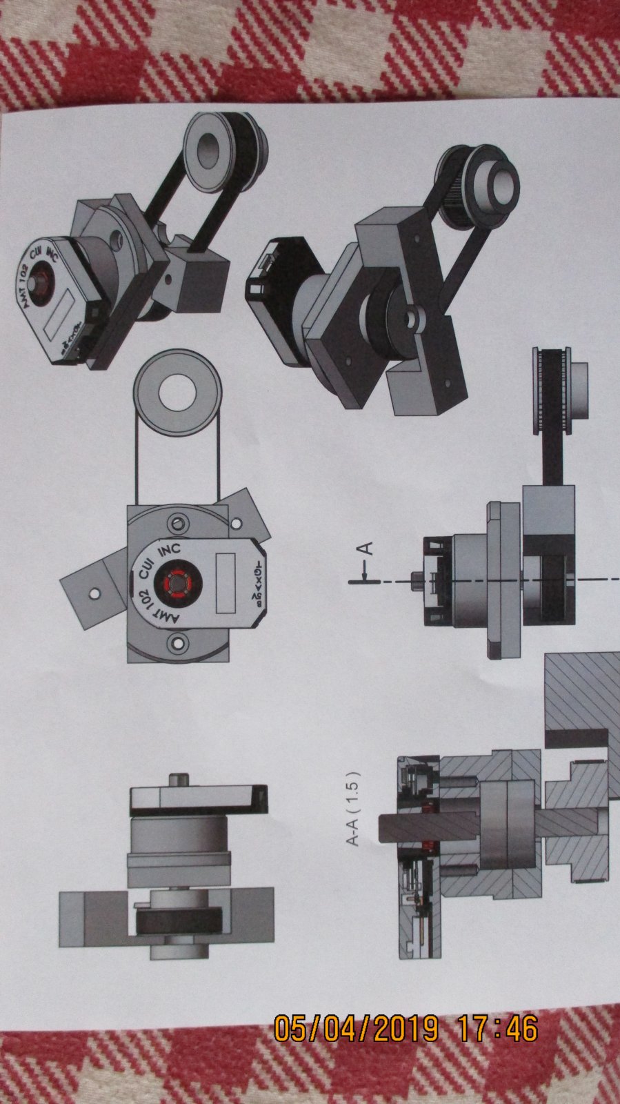

    The AMT-103V sensors are magnetic, and their resolution is 2048 CPR. The encoder2position modules could handle with no issues the 10000CPR quadrature encoders on real servomotors with no losing pulses in highest speed 500mm/s!!!
    https://www.cui.com/product/resource/amt10.pdf
    I'm sure its pull-up signal issue of your encoders or something. This is the reason I prefer the AMT-103V as they are pure TTL digital output with no rise or fall curves. Also its easy to add a 3D printed Axle-adapter to mount them on your actuators. I don't see how is going to be very hard.

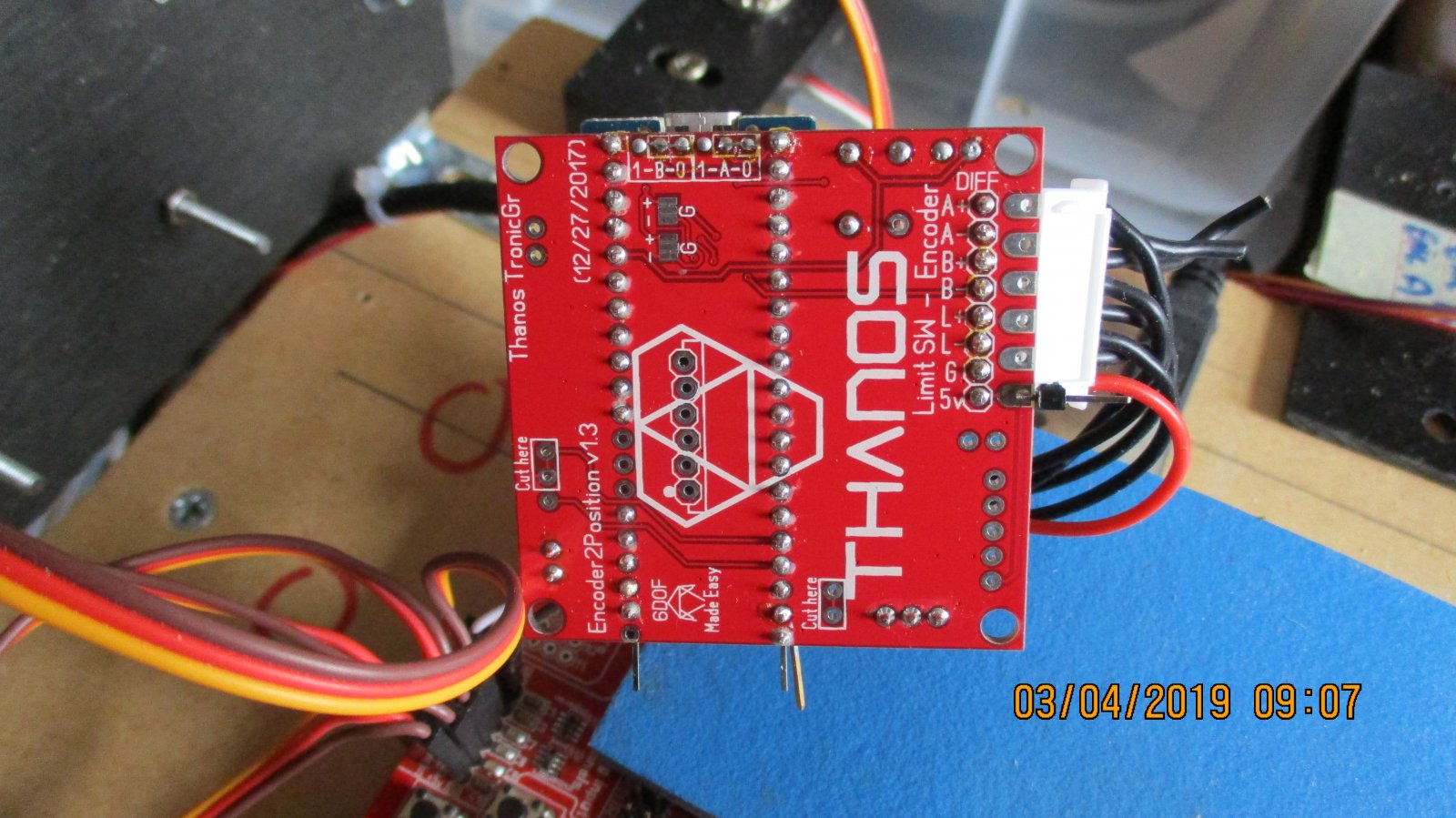

    Also on the back of the Encoder2Position modules, there are some jumpers marked as 1-B-0 and 1-A-0... make sure these are still jumped as B-0 and A-0. And make sure you are only connecting the A,B,Gnd,+5v...
    The 1-B and 1-A jumper position are for differential connections using both A+,A-,B+ and B- connections.

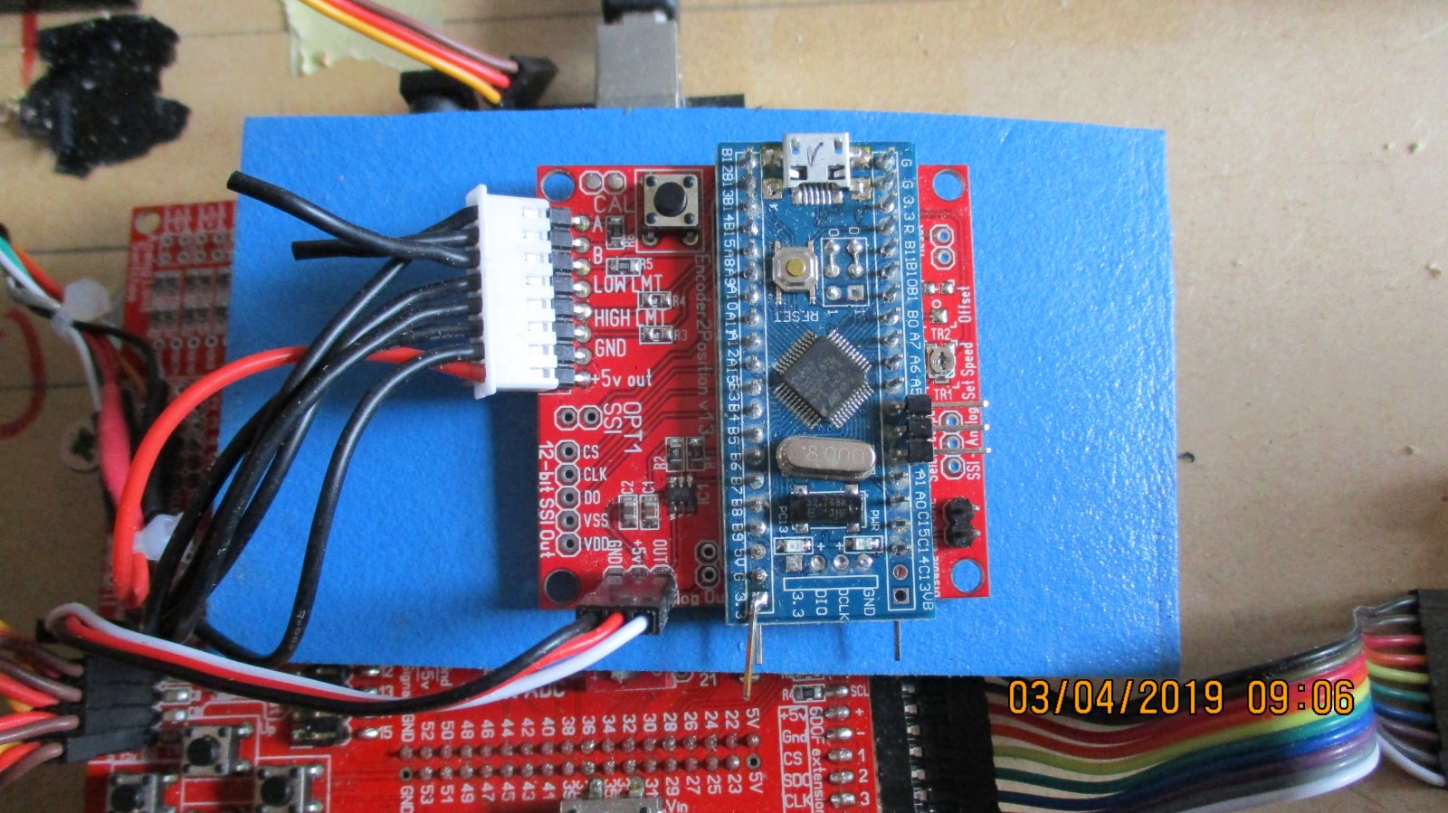

    Hu @Thanos thanks for update will check the Jumpers when i get home later , the spec of the device is the same as the ones shown in your link and by all accounts it should do the Job ,
    I will fit Pull up resistors to my Test encoder2pos and hope this gets rid of this problem .. it will boil down to me missing something in my setup but i can handle the embarrassment if i get this to finally work as it was intended .. i do remember that i had to fit pull up resistor when i was doing trials years ago with Kangeroo but thought that was kangeroo related

    NO... these on Amazon link are NOT TTL OUTPUT encoders... they will not perform the same as true TTL encoders (like AMT-103v or HEDSxxxx). They are using analog photodiodes directly with no correction circuitry for filtering with Schmitt trigger for digital conversion.
    https://en.m.wikipedia.org/wiki/Schmitt_trigger
    PLEASE SHOW ME HOW DO YOU WIRED THEM EXACTLY! Drawing or photos with some labels on the wiring perhaps... did you connect +5v? Gnd? A, B? Where exactly? Did you connect pull up resistors? Where and what value...
    Ps. If you want my opinion, these encoders will never work right with 5v, no matter what pull up value you try. They have slope rise and fall pulses shape, not clean square 90 degrees shift pulses and will confuse the encoder2position modules.

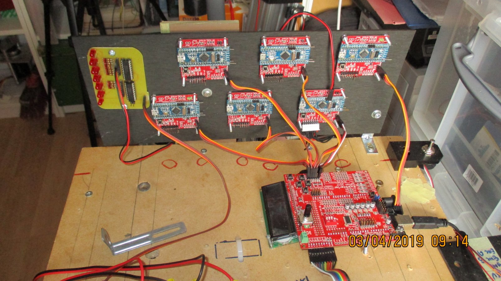

    Hi Again Guys this is my wiring for the test Actuator using Optical encoder with Encoder2Pos Interface Pcb Sabertooth & AMC128USB barebones setup

    One obvious mistake I see on the wiring on the photos, is that you wired the B- not the B+ !!!
    You need the A+, B+ connected if you are using the 8-pin connector!!
    You can leave the A- and B- unconnected.

    Hi @Thanos Sensors Ordered so should be here on Monday .. weird thing ! ordered them on UK digikey site and dam things are still being shipped form USA ???? any ways have found a solution to mounting these when they get here sett attached sketch of 3d printed parts ( 2 elements . top & bottom ) with 2 bearings inside to support shaft to which encoder will be fitted as shown and at one end and Toothed gear at the other end Plus a bridge piece as adjustable actuator mount The gear will be clamped to shaft and positioned to minimise any axial end float which may affect encoder.. dam Cad PC at home playing up so this will be my 1st Fusion 360 test to design and Create STL file for printing .
