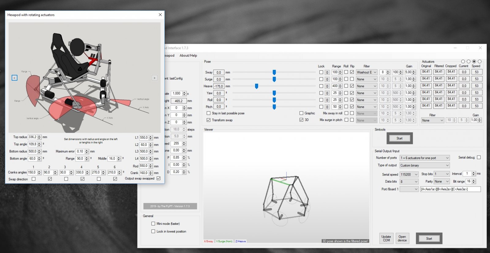

    In my software the 3D model is hard coded with the Inverse Kinematics so it’s fully independent from scaling.
    You seems to deal quite differently with this but I am sure you can manage.
    Hope I am not confusing.

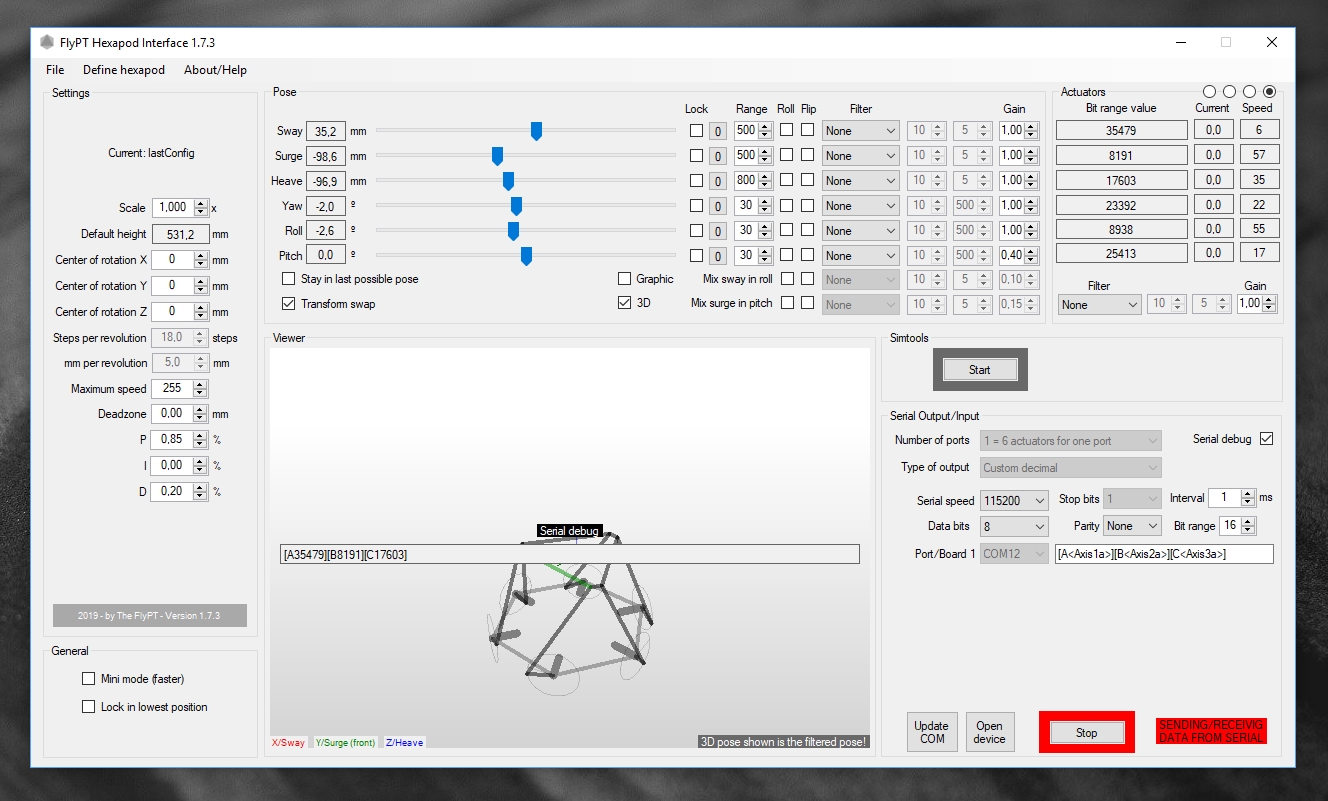

    Version 1.7.3
    Look at first post for download...
    -Roll back to old scale method (it was correct...).
    What I made, worked for linear, but not for rotating. I was scaling on the pose, not on the output.
    Implemented this thinking it could be faster. But didn't think at all... @hexpod , you are right.
    -Solved drawing problem on rotating rig.
    Front was not green when out of range.
    -Added swap for pose transformation (was on background, now enabled on interface).
    Unchecked, translations are in world coordinate system (by default and used until now).
    Checked, translations are in top structure coordinate system.
    After reading the "Writing a motion cueing software from scratch". It's a doubt I have asked before in my build thread, so here's the two versions for teting.
    -Added serial output debug (was on background, now on interface).
    If checked, shows bytes sent to boards.
    In binary, shows the byte value,
    in decimal shows the char.
    -Solved mixing problem (was not reset on loading, default was different from what was shown in interface until we changed the value).
    -Serial output. Can't find the error. It's working for me, on a board I have with me. Need more feedback.
    Could not test on my rig. Only tomorrow.
    And... some new bugs for sure!!!!

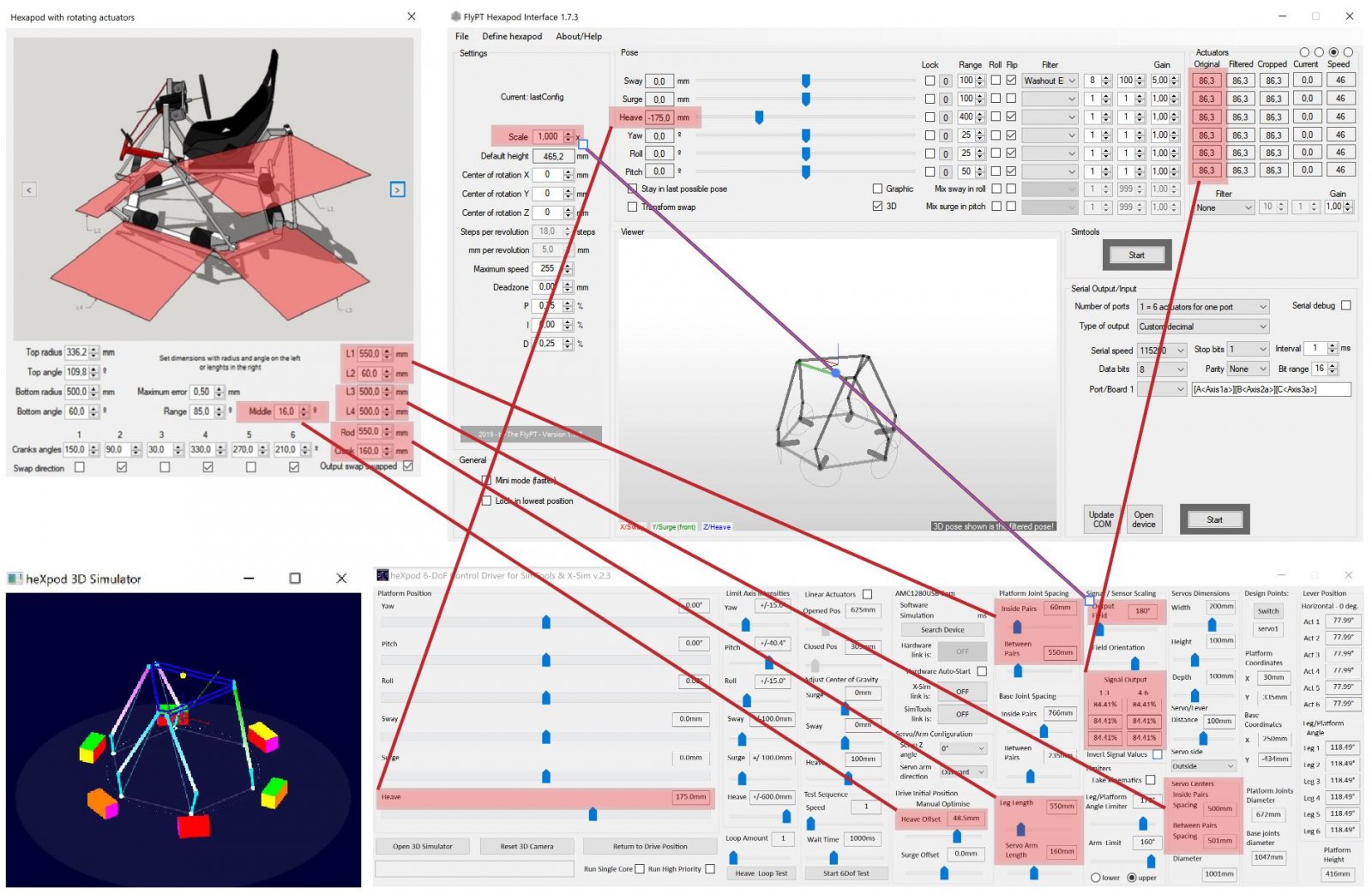

    It looks reasonable. congrats !
    I did a quick comparison.
    It seems you are dealing with scaling differently than me.
    With the same pose (175mm) I see a discrepancy of 0.3 deg. in the crank position, which is a little, and 1.9 percent in the output, which is A LOT !
    It could be there is a misconception or conversion mistake somewhere.

  8. pmvcda
    pmvcda aka FlyPT
    Nov 3, 2010
    2,272
    Portugal
    15,902Coins
    +2,716 / 18 / -0
    Small change in rounding:

  12. pmvcda
    pmvcda aka FlyPT
    Nov 3, 2010
    2,272
    Portugal
    15,902Coins
    +2,716 / 18 / -0
    Added more decimal places to the output display because of rounding.
    And you have 180º field in your app, but in mine you have 170 (2*85º).
    The % is relative to the range. So the result was different.

    I understand but what’s the concept behind using reduced 170 deg. range? (Security while using 180 sensors?)
    As you know already, in some circumstances, the actuator path between two extreme poses can demand a range exceeding 180 deg.

    I never tested your program, so I don't know how you use those 180º. Might be completely wrong on my thoughts.
    What I do right now:
    -Limit actuator extension/rotation to -range to range value
    - Calculate bit output considering:
    0 to max bit range value <=> -range to range
    -Multiply by scale the bit output
    Seems an error in step #5, because 2*range doesn't match the bit range.
    This "problem" comes from my rig, where I calibrate the rig from the start with absolute values and range is the number of steps, so I never get lost.
    But in my test code for using the rig in the traditional way, the value received in the board is then remapped (on the board) to the minimum/maximum of the actuators.
    It's working around this idea, and for linear it seems to work well.
    For rotating, I think we can make the same. It's up to the user to decide where is the min and max rotation, and what angle do they have.
    In a 0 to 1023 bit range, they can have min=100 with 10º and max=1000 with 30º, being the middle 20º, just as an example.
    So my basic idea of range is hardware limitation. like limited pot rotation or pot fixation in front of rod...
    But I can be wrong.
    I need to test with my rig, most my last updates where not tested. Scale might still be wrong or inverted...

    While using 0,5 scaling factor I see the bit range output reducing while the percent of travel remain same.
    I guess you scaled it to the crank travel.
    It would not be more comprehensive to scale the percentage on bit output?

    Since my idea of scale is to match values (mm) in the program with the rig, I thought % would be more suited to range in mm instead of bit value.
    The bit output is not really "visual", considering that 0 should be the middle value, it's not a good comparison in my mind.
