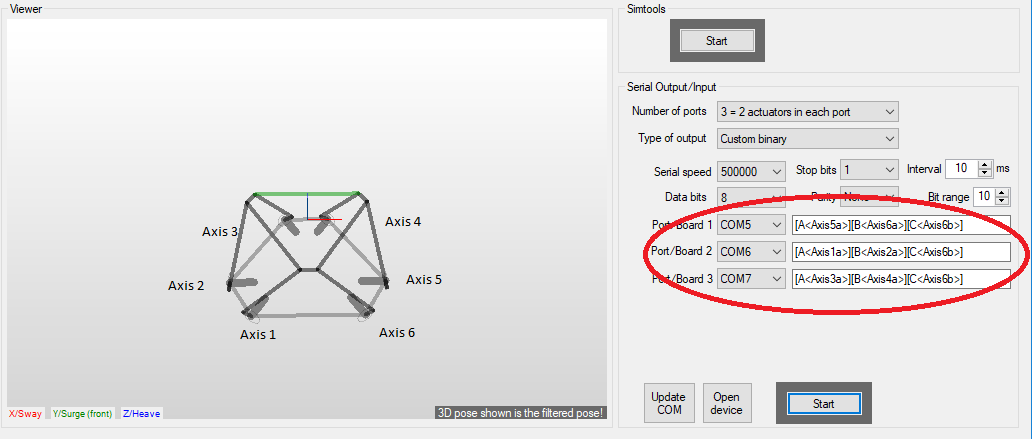

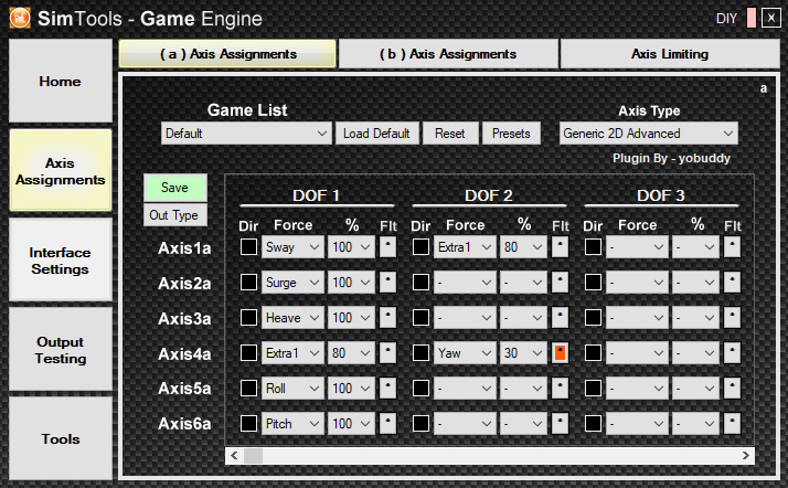

    AC motor, 6DOF
    Hi FlyPT
    today i tried yout wonderfull software
    But i guess I made more then one mistake
    Can you please explain me witch motor should be No. 1?
    I wrote my axis into this screenshot:
    How would be then the port settings?
    The other problem is al lot more confusing
    The movement of the grafic is correct, but my rig rides completely different
    I tried to control heave but the rig maks a yaw move
    Aktually I can say:
    Sway moves like pitch
    Surge moves like Roll
    Heave moves like Yaw
    Yaw moves like Heave
    Roll moves like Surge
    Pitch moves like Sway
    My Axis Settings in SimTool are the same as you made in the first post in this threat
    Hopfully you can help me
    Kind regards
    Peer

    Sorry for the late reply.
    The green bar you see in the 3D representation, is the front of the rig, where you are looking at when seated in the rig.
    First actuator at your front right is #1 and they increase in the clock direction until #6, the first one on your front left.
    This is the numbering for the interface.
    If you put "<Axis1a>" in the serial string, this represents the actuator #1 in the interface, with the above logic.
    If what you have in your picture is your numbering, then:
    #1 in interface is <Axis1a> in serial and it's your actuator #4
    #2 in interface is <Axis2a> in serial and it's your actuator #5
    #3 in interface is <Axis3a> in serial and it's your actuator #6
    #4 in interface is <Axis4a> in serial and it's your actuator #1
    #5 in interface is <Axis5a> in serial and it's your actuator #2
    #6 in interface is <Axis6a> in serial and it's your actuator #3
    So to send data to your actuator #1, you use <Axis4a>
    So to send data to your actuator #2, you use <Axis5a>
    So to send data to your actuator #3, you use <Axis6a>
    So to send data to your actuator #4, you use <Axis1a>
    So to send data to your actuator #5, you use <Axis2a>
    So to send data to your actuator #6, you use <Axis3a>

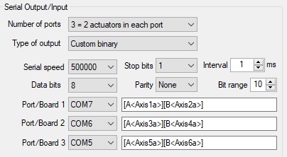

    From your settings, you are using 3 Arduinos with SMC right (from your thread)?
    If so, that's two actuators in each board.

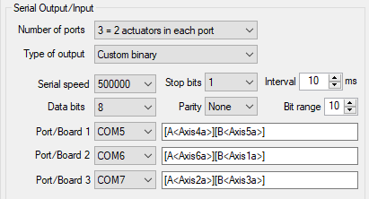

    Then your connection string should be:
    [A<Axis5a>][B<Axis5a>][C<Axis6a>] on the board that controls the actuators #1 #2 and #3 of your rig
    [A<Axis1a>][B<Axis2a>][C<Axis1a>] on the board that controls the actuators #4 #5 and #6 of your rig
    You have <Axis6b>, that might be a copy paste error by youbuddy on your thread

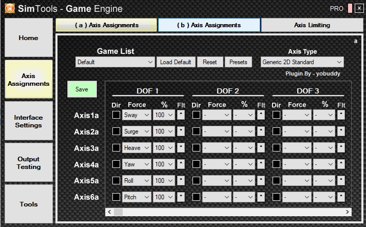

    Also, for testing, configure simtools, with just:
    And use the interface sliders to verify if everything is correct.
    When everything looks correct, you can test some mixing on simtools

    Thank you very much for your help.
    But it doesn´t help.
    I´ve used now these settings:
    But there is still the wrong action when i use the blue fader:
    And i got another probem
    I don´t know why, but however the maximum angle was ignored while i tried to use heave and surge was not back on "0"
    So the arm goes over an brokes the connection to the poti.
    I think there is a failure in my seetings so the max circle is to big.
    Now i first have to fix this hardware problem.
    After that i will test again
    have i nice weekend
    Peer

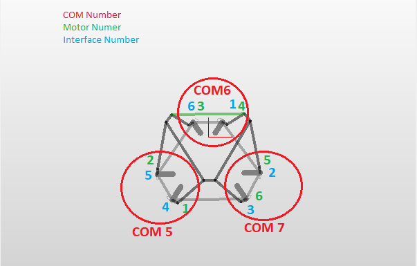

    Are you sure that COM5 is for actuators 4 and 5
    COM6 for 6 and 1
    and COM7 for 2 and 3?
    Because they seem swapped.
    EDIT: Wait, let me take a look at SMC software...
    EDIT #2:
    Ok, SMC3 accepts 3 motors in each board.
    You are using two in each board.
    So maybe you should send the 3rd axis with zero:
    [A<Axis1a>][B<Axis2a>][C<0>]
    You have to be sure, that for each board, you have the actuators connected correctly.
    First what I said above and next if you have physically connected actuator 4 on your rig to arduino in the Axis1a pins and actuator 5 on arduino Axis2a pins.
    Same for the other boards.
    Hope I explained what I mean.

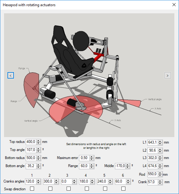

    Hi
    my setup is like this:
    So it should be OK
    I found 1 mistake in the middle angle
    It was 0°, but this means the crank is on the outside.
    When i change the value to -170° the grafik semas to be right.
    *short test break*
    OK, it works
    The biggest problem was in front of the monitor ;)
    The angles of the Cranks where completely wrong.
    Also the revers settings was wrong
    With this settings, it looking very good (still have to repair one motor)
    Now the movement looks realy good with this interface.
    The 3D grafic looks like this:
    Thanks so much for your support.
    Kind regards
    Peer

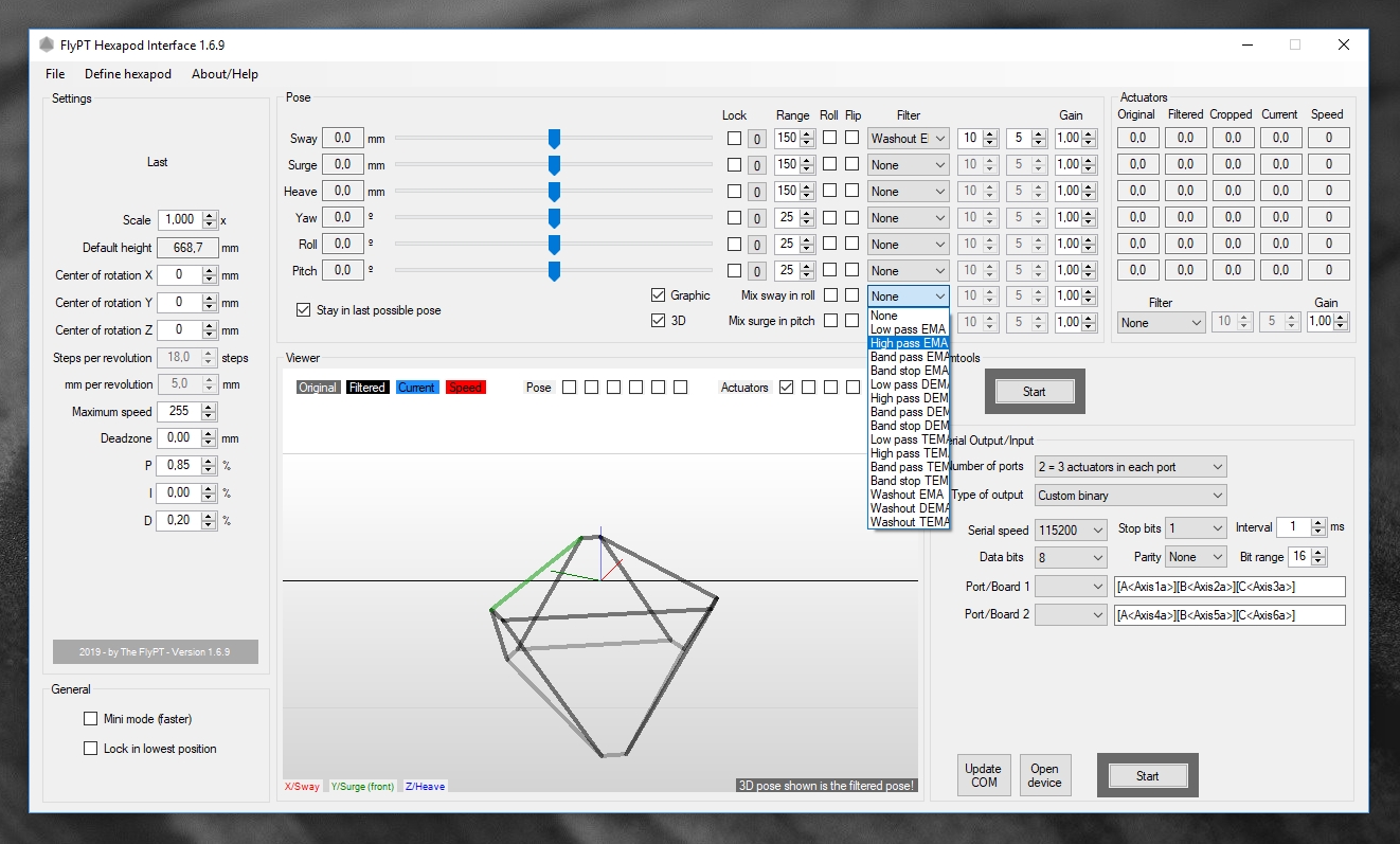

    Version 1.6.9
    Download on the first post of this topic
    Been working on something new... That made me change many internals of the interface.
    So here's the new version, with more filters:
    -New washout filter calculation.
    -Using the filters, it's possible to reproduce a simple motion cuing algorithm.
    -Faster pose calculation with changes to add more DOF in the future
    -Small optimisations in drawing
    -Solved spikes in filters when we changed types
    -Corrected problem when going to lowest position
    -Now works when minimised
    -Roll over changed.
    If filtered value reaches limit, it's cropped and stays there, although internally it's still calculated, so it might take some time to see the value moving again.
    You should apply filters like washout or high pass to avoid reaching limits.
    -Optimised interface visualisation code, way less if's and loops.
    -Graphics records data only when visible, so everything is reset if you hide it.
    -Changed scale. Now scale is applied only to the final output. It was causing problems on the actuators (and lowest position).

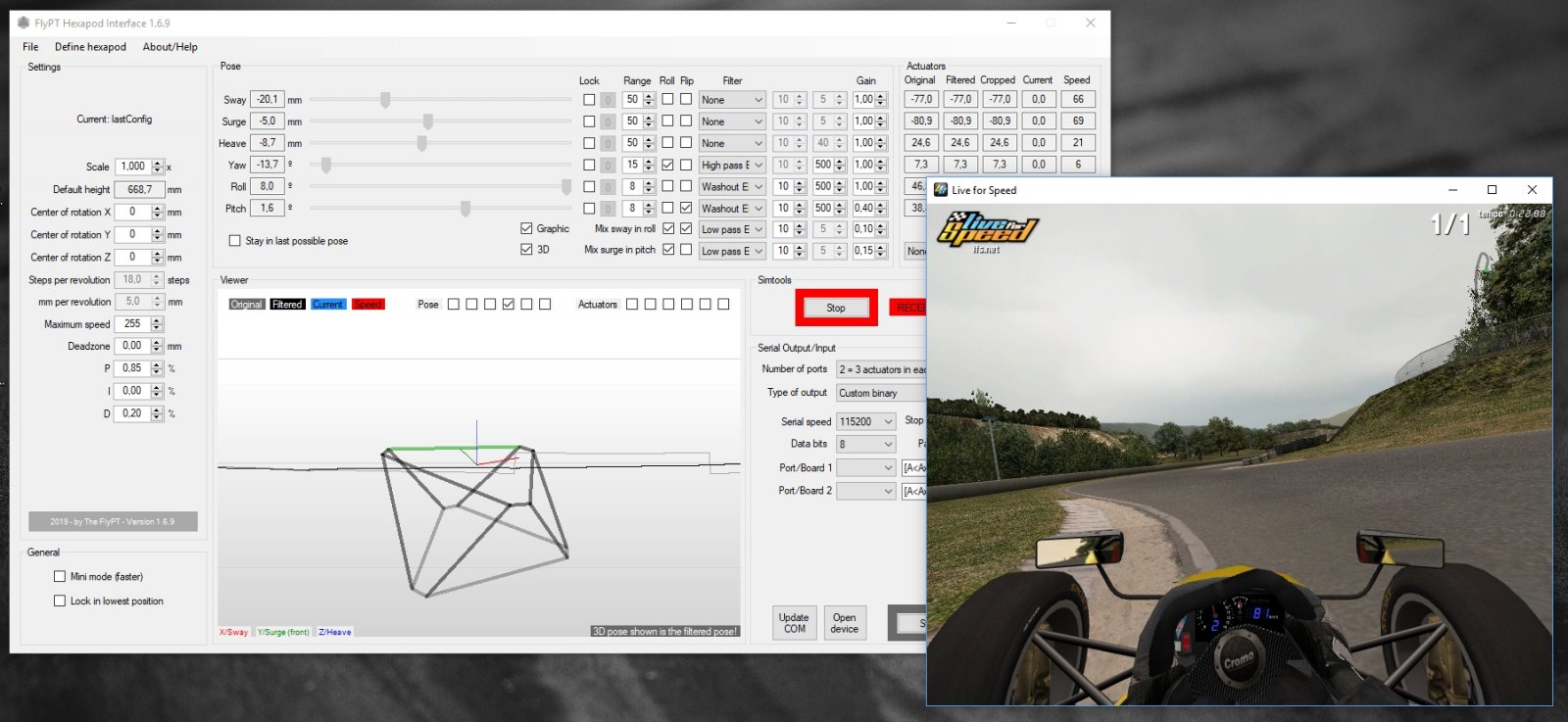

    An example of settings for LFS:
    This is working for me, with my current setup in Simtools.
    It's just to give an idea of proportions and filters I'm using, specially in mixing yaw with roll and pitch with surge.
    (Note: We can see the yaw roll over in action on the graphic)
