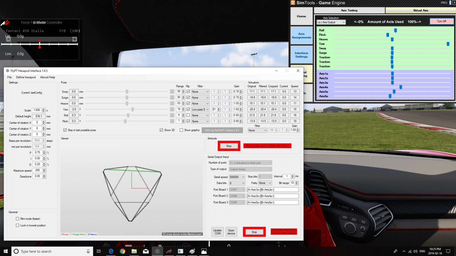

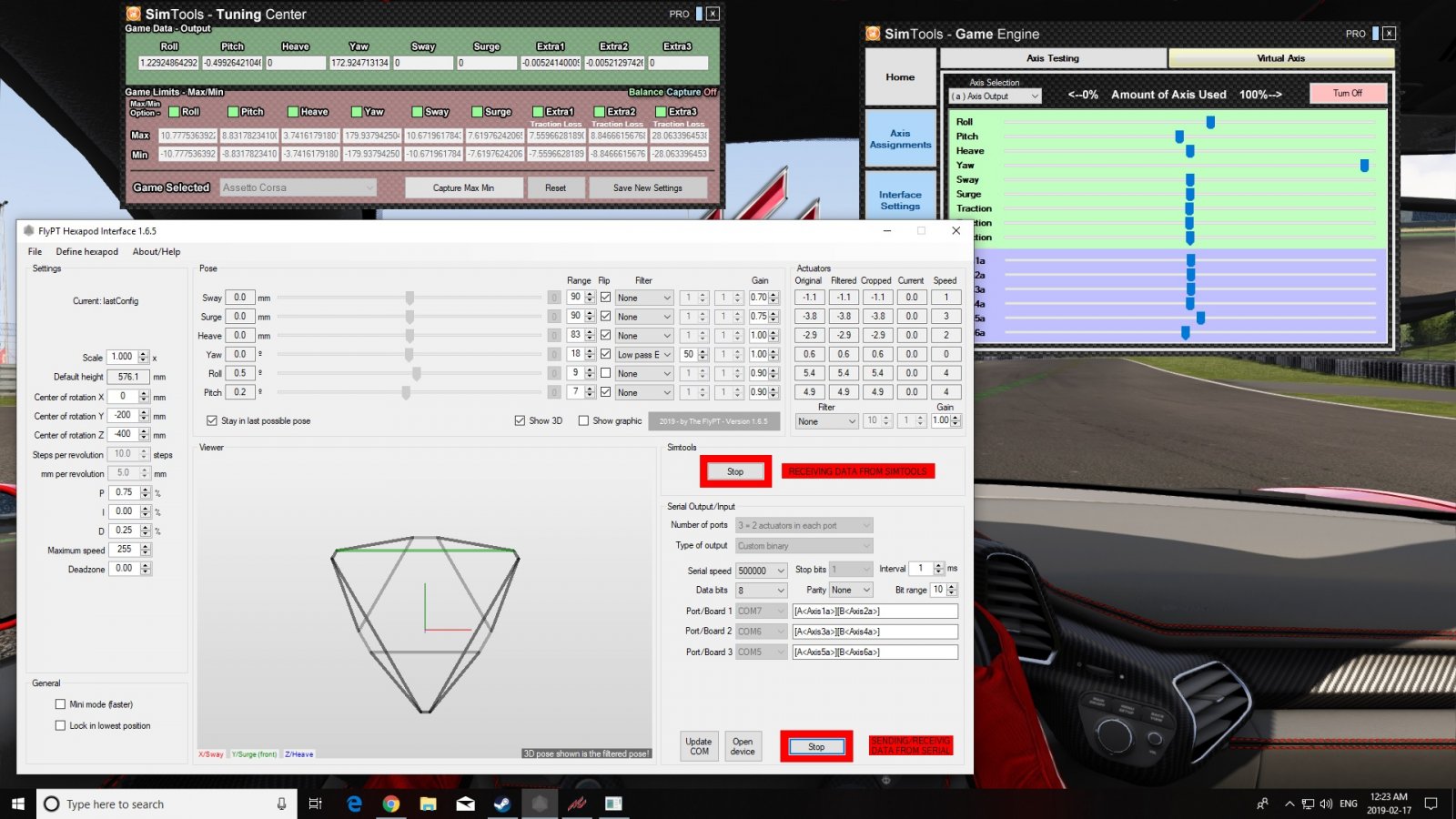

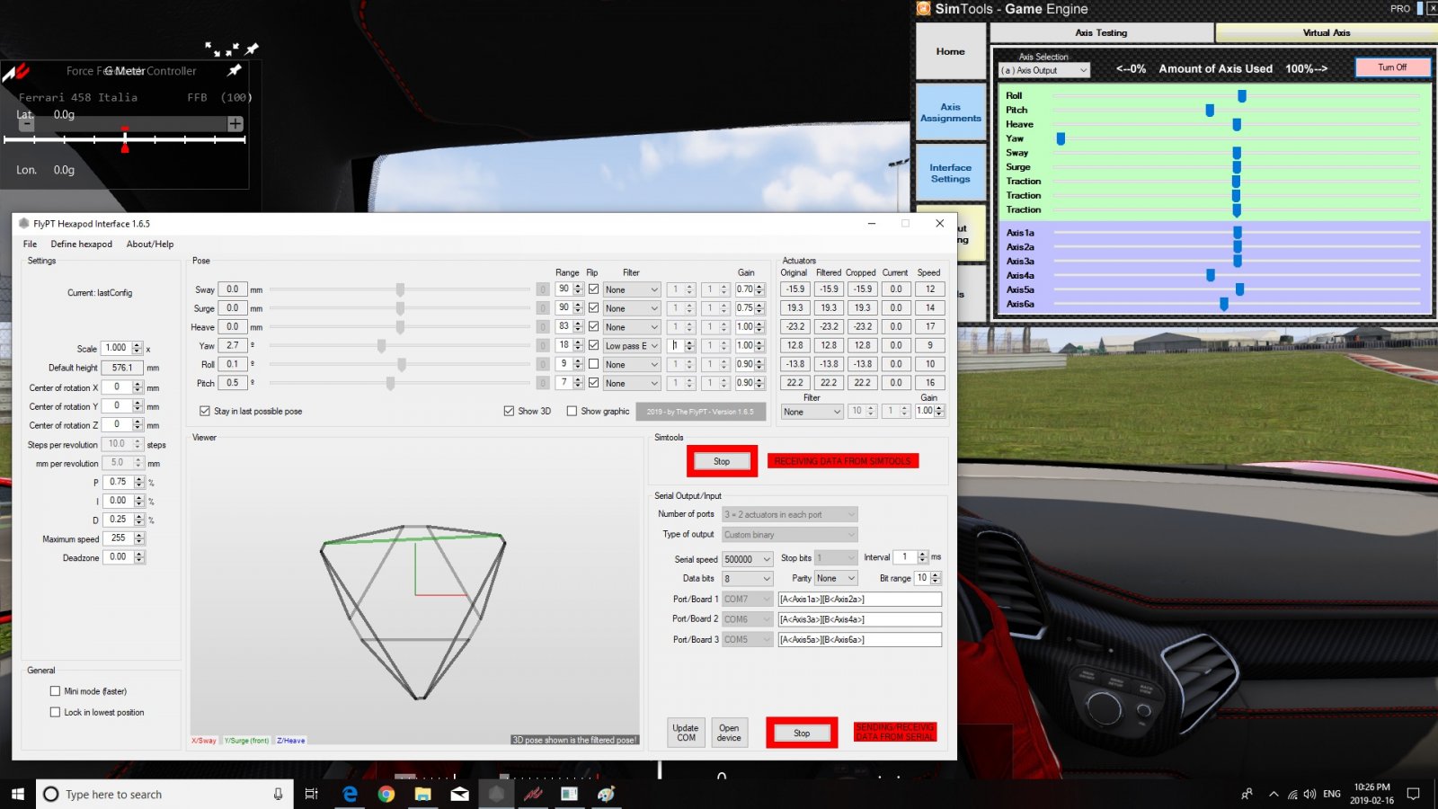

    Hello @pmvcda , I had little time, so I made my list of all the thing I had to test. Of 11 things, I got 2 done, because I am stuck at my yaw problem.
    I'm almost sure it has nothing to do with your interface, and everything to do with the washout of simtools not working, whatever it's suppose to do. I know I should no post it here then, but I like to show you what I have just in case you have a idea of what I could do, and I did not look for the simtools complain department yet.
    The 2 next image show data from Aseto Corsa when the car is stopped. One has a yaw value far into the negative and the other far into the positive. The washout should bring the rig back to the center, but it doesn't. It stays there and there is a violent correction between the two value. I've tested many values for the washout, without any change in the result.
    But what I found really curious, is that on pause, the rig goes bask to the center, slowly, for the yaw. Even though it does not for the virtual axis. So strange.
    I've tested on NoLimit2 since now I know how to add the telemetry, but it does the same. So, it not related to the game.
    I guess I have only a few options left:
    - Filter yaw to the death.
    - Uninstall and reinstall Simtools.
    - Contact Simtools.
    - Remove yaw altogether.

    I'm not at home, so I can't make test's right now.
    But can you show a screenshot of the washout filter.
    I think it's more of a settings problem.
    I would remove the low pass filter in the interface, because it might interfere in what you expect of the washout.
