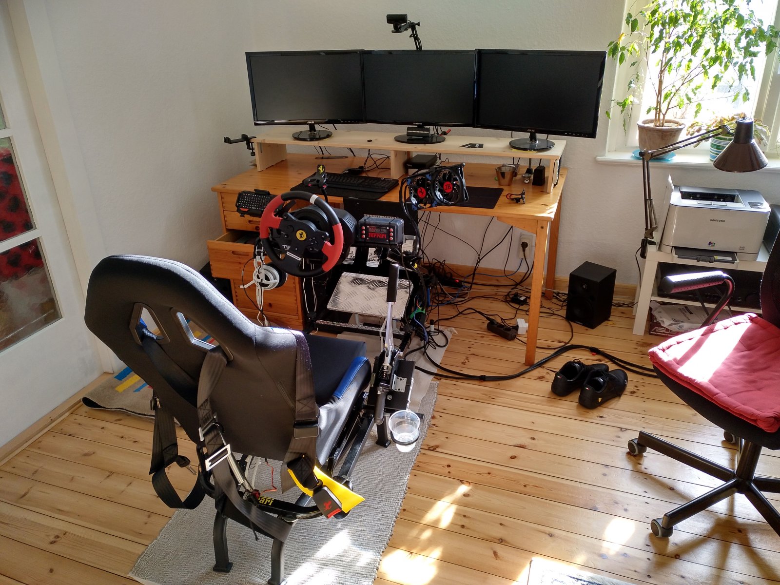

  3. Jonas Canopee
    Jonas Canopee Tech & fitness geek, daddy, car enthusiast
    Feb 14, 2019
    17
    Graphics designer
    Berlin, Germany
    145Coins
    +15 / 0 / -0
    Hi, First of all: it's a great project & program even if it's split up. I just recently bought simtools and the xsim subscription because I didn't manage to realize the harness tightener on my own and I found lots of helpful info and a good arduino sketch I could base my own one on. Because everything (except for wheel and pedals for most builds) is custom hardware everybody's diy Sims are very different as you know well. Reading about simtools before I started my build about a year and a half ago I was repelled by the still existing 2PCs approach and tutorials on the net. Not that I don't own another desk- and laptop (I'm a nerd) it just seemed too complicated. I designed the outside of a commercial driving sim working as a graphics designer in a german company and we worked closely with the Bosch and Audi engineers who were on the project, there was only on PC there although you could display telemetry on a laptop/tablet via WiFi or Bluetooth. I look forward to hearing about new developments as I'm enjoying the newly gained immersion with the feeling of actual breaking through the harness tentioner, not only ABS stutter from DC rumble at the break pedal. I saved a few insights from my work and I am willing to share with you. Have a relaxing Sundays!
