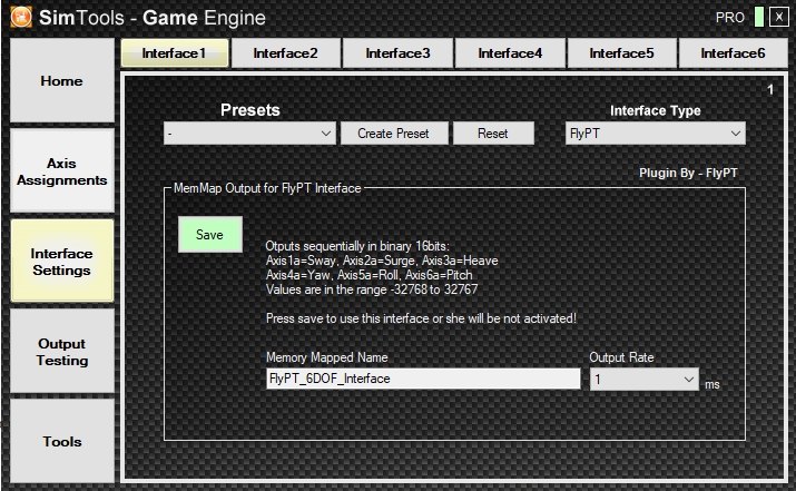

    STEP 2 - Configure Simtools
    We need Simtools to send to the interface, the pretended pose.
    The information is sent with a memory mapped file that is read by the interface.
    To make it output in a recognisable format for the interface, you should install the FlyPT plugin:
    To install, just drop the plugin dll file in the download, over the plugins update.
    Go to the interfaces and select FlyPT.
    Don't forget to press Save, to be sure the interface is activated.

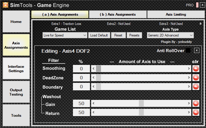

    A standard axis assignment could be:

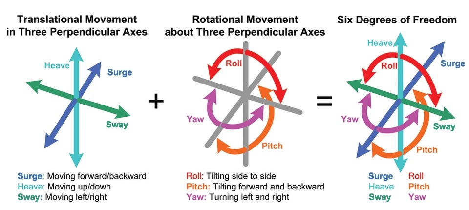

    The interface uses Axis1a to Axis6a to receive the pretended 6 components of the pose.
    You can select two orders (check box over the sliders).
    FlyPT order with (unchecked):
    <Axis1a> = Sway
    <Axis2a> = Surge
    <Axis3a> = Heave
    <Axis4a> = Yaw
    <Axis5a> = Roll
    <Axis6a> = Pitch
    SimTools order (checked):
    <Axis1a> = Roll
    <Axis2a> = Pitch
    <Axis3a> = Heave
    <Axis4a> = Yaw
    <Axis5a> = Sway
    <Axis6a> =Surge
    Where each component follows this rule:
    You can mix anything you want in each axis output or apply the Simtools filters.
    But Axis1a will always be looked by the interface as sway.
    In the example above, I'm using Extra1 instead of Yaw, because it's an assignment for a car sim that uses traction loss in Extra1.
    Traction loss is a rotation around a point, usually in front of the car. That's why I had Extra1 also on sway, so the rotation is made around a point in front.
    I'm also mixing a bit of Yaw, with washout:
    In a car game, Yaw is world orientation and since I can't do 360º rotation on my rig, I make her go to zero slowly with washout, to have all the range available in the next turn.
    The important thing to retain is that those 6 axis output, are the pose components as described above.
    And in a flight sim, they can be different to a car sim.

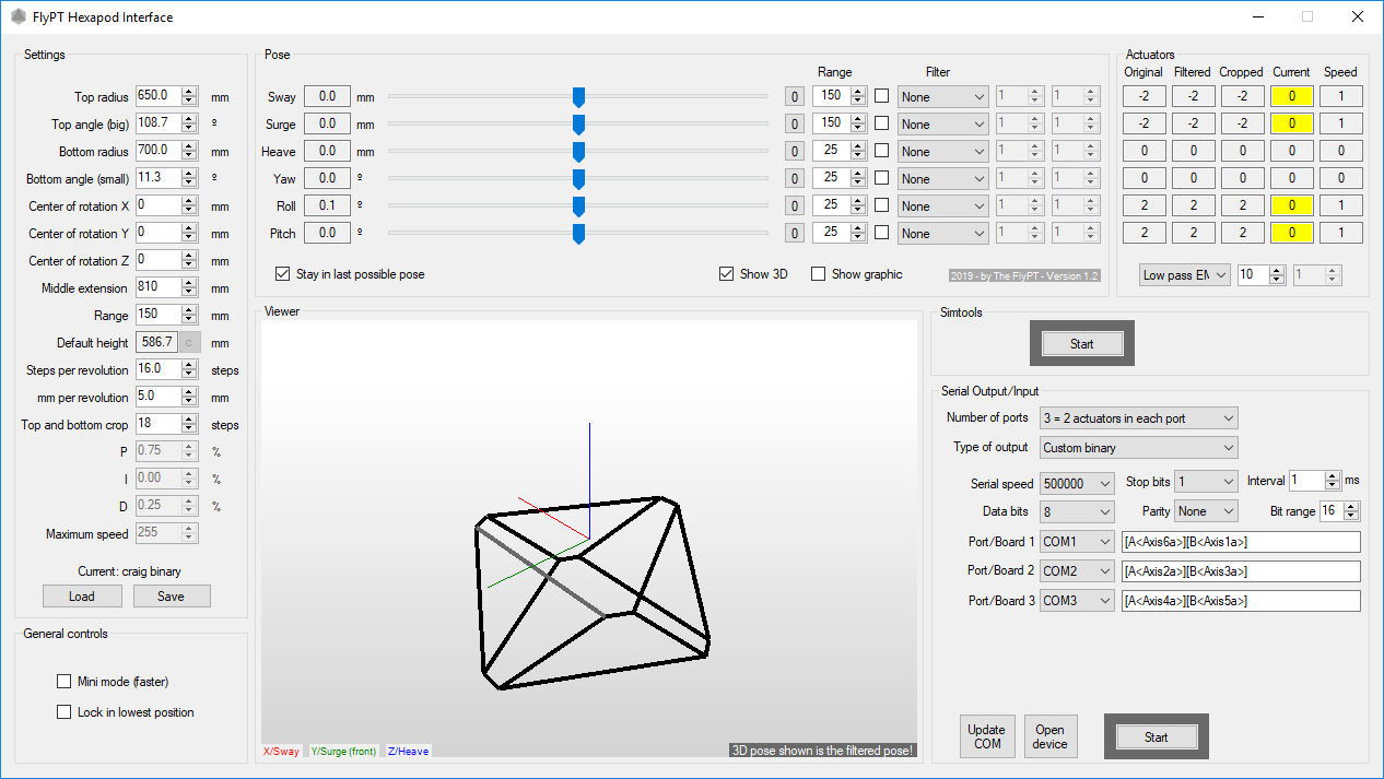

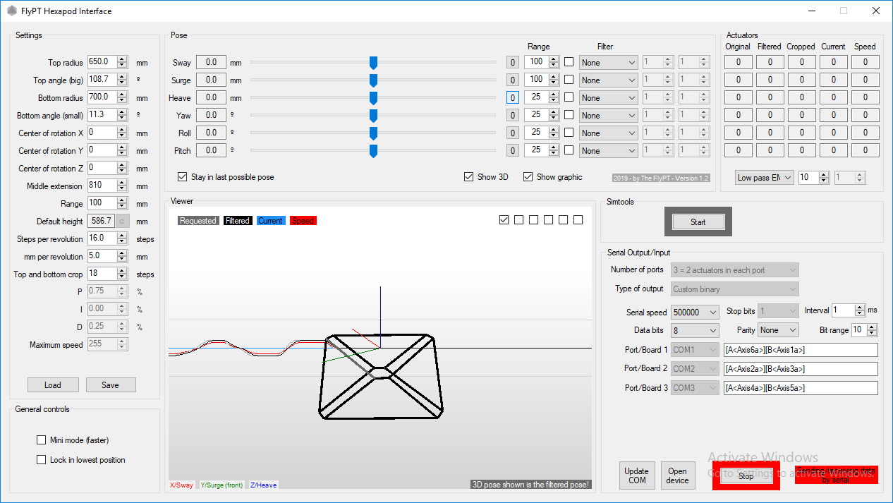

    Now we can start the interface.
    We can start by testing the connection with Simtools.
    For that, turn on output testing in simtools and then go to the interface and press "Start" Simtools connection.
    You can now move the sliders in Simtools and they should be reflected in the interface.

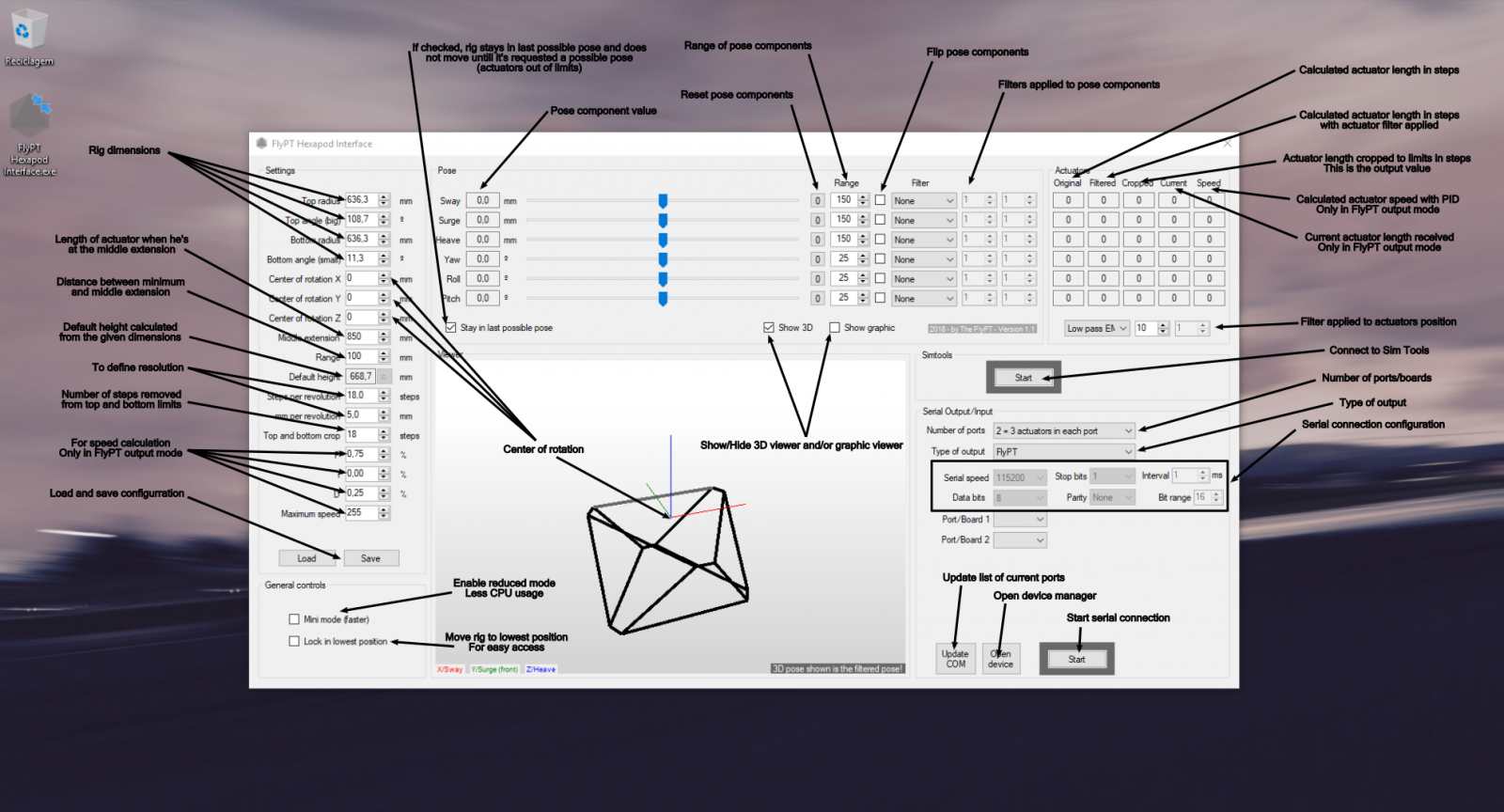

    STEP 3 - Define the dimensions
    If everything is OK, let's define our rig in the interface.
    Click in "Define Hexapod" and choose your type of actuators.
    The basic dimensions, can be given by radius and angles or distances.
    If you change in one mode, the others are calculated from what you introduced.
    If you are going to measure in the rig, it's easier specifying the dimensions (L1 to L4).
    Look at figures to guide you.
    Remember, those measures should be made between the center of rotation of the joints.
    Now, if you have a rig with linear actuators, you should specify the middle extension of the actuator and it's range.
    Again, look at the figures for guidance.
    Range should be given in such way, that limit switches are not activated when you request the actuator to go to the minimum or maximum position.
    Middle extension is going to define the default position of the rig and respective default height.
    Default height is the vertical distance from bottom joints center to top joints center.
    If you have rotating actuators, there's some more info to be introduced.
    Vertical angle, is the angle made by the rotation axis around the z axis (where they point).
    Swap direction is to say that the crank points to the opposite side.
    Middle angle is the position of the angle of the crank used as zero. This is relative to horizontal position.
    Range is the number of degrees we can rotate to each side.
    Rod and crank define the lengths of those arms (always joint to joint).
    Maximum error is a special parameter. We calculate the angle of rotation by "search", and specifying a low error, makes the program search for more time, for a more refined position. But that makes things slower.
    A big error is faster, but has less precision.
    We now have all dimensions defined.

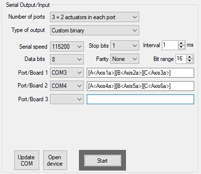

    STEP 5 - Connecting to the hardware
    The connection to the hardware tries to replicate what we have in Simtoools.
    First we have to define how many boards we use to control the actuators.
    This is like using multiple interfaces in Simtools.
    The options are:
    1 board to control the 6 actuators
    2 boards, each for 3 actuators where board 1 controls actuator 1 to 3 a and board 2 actuator 4 to 6.
    3 boards, each for 2 actuators, where board 1 controls actuator 1 and 2, board 2 actuator 3 and 4 and board 3 actuator 5 and 6.
    6 boards, one for each actuator
    We now choose the type of connection.
    The FlyPT type is the original and was made for a specific code on the boards (in my case ESP32 boards).
    As said before this mode besides sending the pretended step on the actuator, sends also the speed and receives the current position.
    There are no parameters for this connection, they are always the same.
    Only change allowed is the number of boards used.
    You should select the COM for each board. Be careful to not switch the order of boards/actuators (see above).
    If the port is not listed, press update COM.
    Any problem, click Open device to open the device manager and look for the current COM ports.
    The custom serial modes are similar to the ones used in Simtools.
    They can be decimal or binary. If you can use binary, it's the preferred format since it requires less bytes.
    In this modes you should specify the connection parameters.
    Use the values you used when controlling the actuators directly from Simtools (interval=output rate).
    Like in the FlyPT mode, please select the COM ports for each board, and pay attention to the order.
    You should also specify the output string, similar to the one used in Simtools.
    Press Start to connect to the hardware, but please keep your emergency Stop at hand in case of any problem!

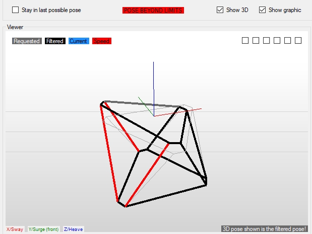

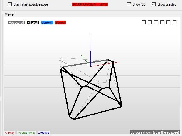

    Out of limits
    When the calculated length of the actuators is out of range, a message is shown and the actuators are drawn in red on the 3D visualization if you allow the actuators that are in range to keep moving (top left check box):
    In this case, the thin Gray lines represent the last possible pose you had.
    If you don't allow the actuators to move if the pretended pose is impossible then the Gray lines are the pose you are asking, but since it's impossible, the rig remains on the last possible one:

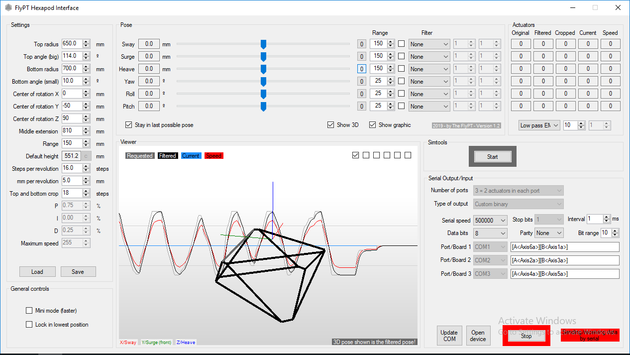

    Visualisation
    There's a basic rendering of the hexapod in the window.
    The position you see is the one before applying filters to the actuators.
    You can also see a graphical representation of the actuators positions:
    The top right check boxes represent each actuator.
    Blue line is the current position (only in FlyPT mode).
    Red line is the calculated speed taking in account the current position (only in FlyPT mode, in other modes it's calculated considering current position equals zero).
    Gray line is the requested position by Simtools or the sliders after applying the pose filters.
    Black line is the requested position after applying the actuators filters.
    The more info to show, slower and more CPU intensive!
    The application records positions, only when the graphic is visible. So if you hide the graphic and show again, he continues from the last save, loosing everything that happened between hiding and showing again.

    Hi @pmvcda I have it setup and tried testing using Binary I looked at my settings didnt realise what it actually was until now and changed the bit range to 10 aswell
    Anyways it shoots the actuators off to the end emergency stop button and limit switches did their job :)
    Think I have it setup right I dont know to be honest.

    What is the smallest and largest extension of your actuators?
    I'm a bit lost with your values, because the rig in default position is beyond the limits.
    I also think you should use 10 ms interval for the SMC3 but I'm not sure.
    It should be the same you where using in simtools
    EDIT: Saw this post from you: https://www.xsimulator.net/communit...r-driver-w-softstart.9277/page-19#post-169517
    If that works, it should be the same on the interface.

    Found a bug... :oops:
    If you change steps per revolution, there seems to be some bad positioning.
    Try to save the configuration.
    Close the interface.
    Now Open the interface again. It should load your last config.
    Enable the graphic for one actuator and see if it moves around the center line while changing the heave.
    Try to connect to the rig and test it.
    If the problem continues, it could be the byte order on the serial output (a doubt I had while making the software). That's an interface problem I have to correct.
    If that's the problem, that's only in binary mode, but that's the one you should use.

    What do you mean by smallest and largest extensions ? I have total range of 340mm but i cut that down to 300mm for testing ?
    If i use the graph everything seems fine its is looks like it is working correctly when I start it , the wave goes up and down around centre as it should with heave
  14. SilentChill
    2,645
    20,581Coins
    +3,566 / 34 / -0
    This shows the graph looking good, when I power on now all actuators are travelling down to the lowest position until they hit the limit switches
  15. SilentChill
    2,645
    20,581Coins
    +3,566 / 34 / -0
    I have changed some values and the rig still wants to go to the bottom limits on all actuators . Everything looks good on the graph but as soon as I turn the power on they slam to the ground

    New version 1.3
    Go to first post to download the latest version.
    Solved (I think...):
    -Corrected byte output. Was able to test up to 115200 baudrate (because of Bluetooth feedback from my boards).
    I'm not sure if the problems in the previous posts are related to speed also.
    Please test.
    -Corrected horizontal lines defining the range in the graphic.
    They had always the same constant value, even changing parameters.
    -Forced actuators dimensions update when changing actuators resolution. It was updating only after reopening the program.
    In doubt, restart program. It will open with the last config and updated values.
    Known problems:
    -Big resolutions or lower resolutions need different scaling for graphic.
