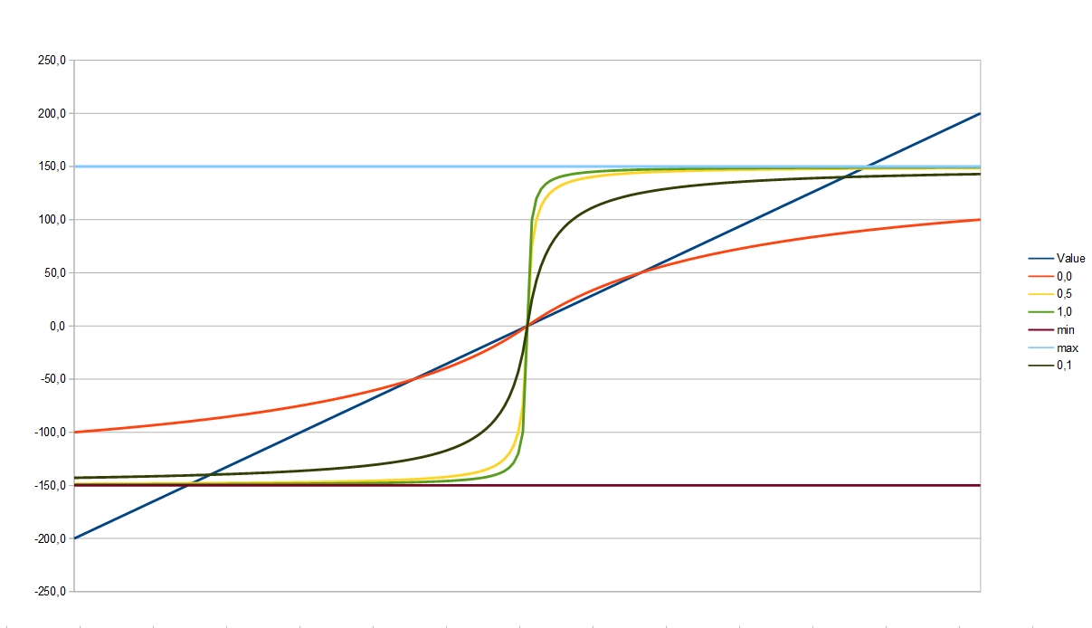

    Added for testing, a new filter --> Logistic
    This filter uses a formula with a fast approach to the logistic function.
    What this makes is make the values fit inside a range. Range works as a limit.
    Range is defined in the right field of the filter (so it can be different from the range of the actuator or pose component)
    The slope is defined on the left field and the value is multiplied by 1000. So if you want a slope of 0,1, you need to specify 100 (100/1000=0.1).
    This is the graphic of the function:
    Range is between -150 to 150.
    In blue the input value, goes from -200 to 200
    In other colors, the logistic function in action with different slopes. (0.0 is 0.01 - stupid rounding)
    The slope values shown in the graphic are the real ones. In the program, don't forget they are multiplied by 1000.

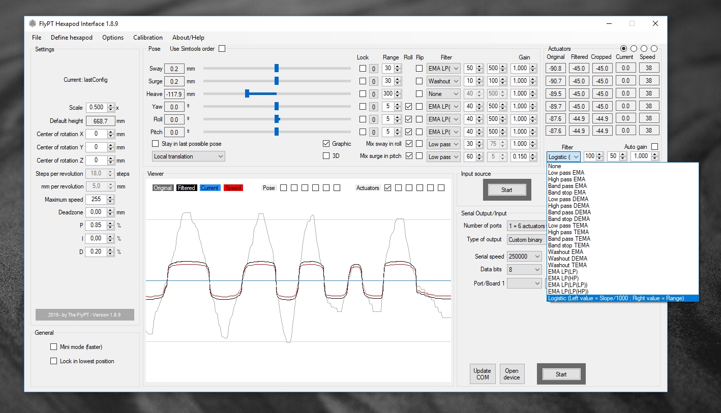

    On the first image, you can see the filter in action on the graphic.
    Download in first post of the thread.
