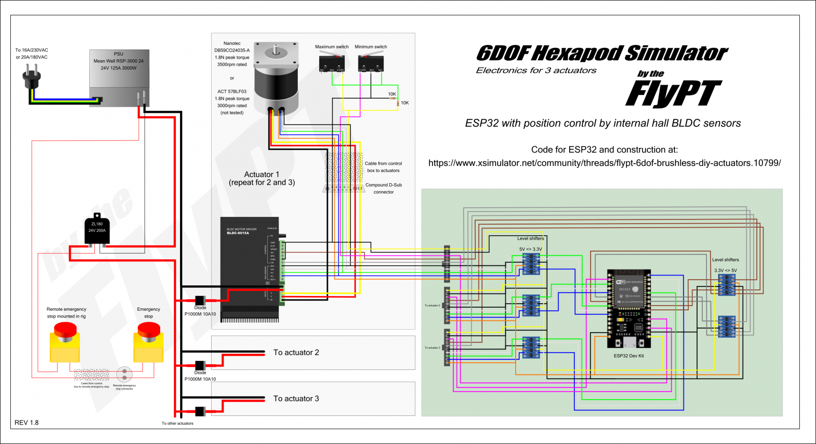

    I think there's no problem, the controller goes up to 50V and 45A peak. Just stay under the 45A peak in the motor.
    Are you speaking of the DB80 range?
    My rig works without batteries.
    But with the batteries, I get more punch, because all motors at the same time going up is to much for my 3000W 125A PSU. My motors can ask for 40A peak each, so that for 6 it's 240A peak for all the rig.
    The batteries help, besides protecting the PSU.
    I just connected them in series, and then in parallel with the PSU. Might put something to charge them with a switch. Still something I need to do.
    I have a diode to protect the PSU. Look at the schematic in the first page. They are next to the controllers, one for each controller. In reality, I mounted just one.
    I need to update that schematic.

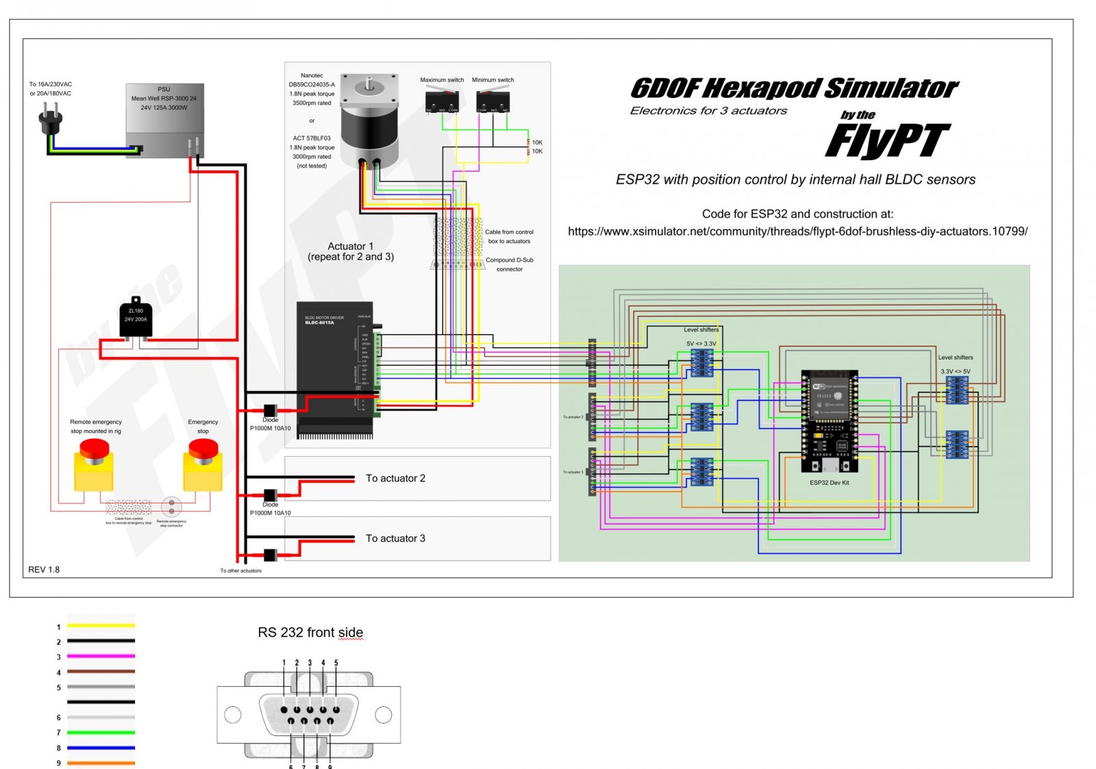

    Just to note, the resistor setup for the switches on the first page is incorrect as having looked at it in more detail you're making a voltage divider so the resistor going from ground to the green wire (NC switch) should actually be going from the yellow wire resistor to ground with the green wire coming off in between them. I've updated the wiring diagram below to reflect this. (Hope you don't mind).
    If anyone is having issues with the min max switches please try this resistor setup.

    Thank's, I will update the drawing in my post.
    It's working in my rig, I just made the drawing wrong! :oops:

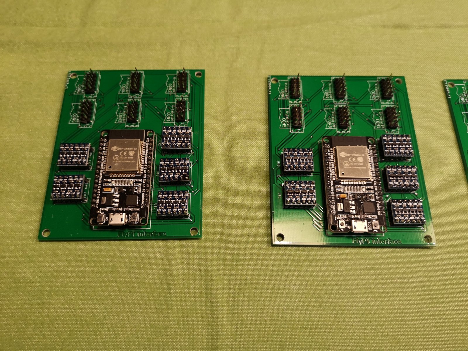

    I've decided after doing quite a bit of soldering and been left with a bit of a mess I might get a couple of PCBs made up. Could you possibly reshare you files as they don't seem to be available anymore.
    Also @Gabor Pittner are you able to share your files yet or are you still tweaking them?
    Very much appreciated and about half way through printing all my parts, made a few modifications though due to using Chinese bits and different sized aluminium extrusion so needed M6 bolts.

    I designed the PCB board with Eagle by Autodesk. I share all files with you in attachement:
    It is tested and works correctly. I use it already.
    • Like Like x 5
    • Useful Useful x 2

    Are you using the latest code?
    Please review the switch schematic! Take a look at this: https://www.xsimulator.net/communit...hless-diy-actuators.10799/page-26#post-192260

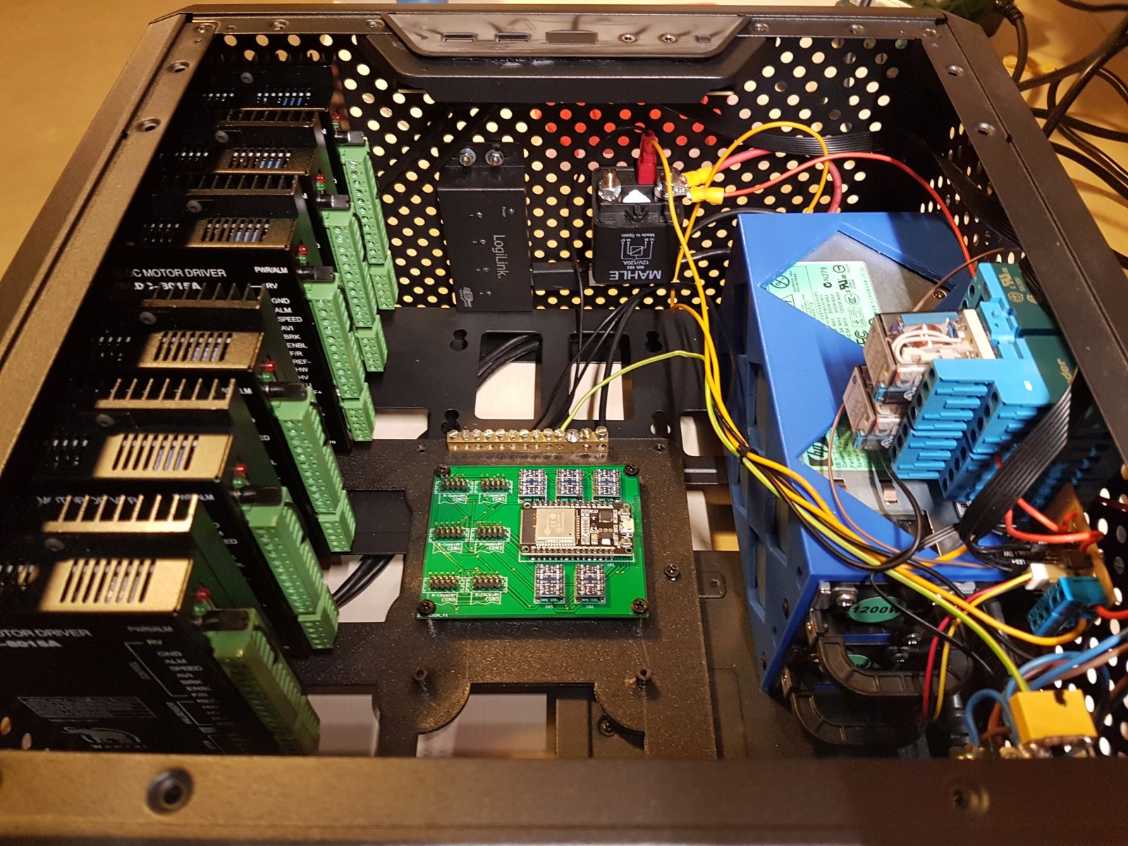

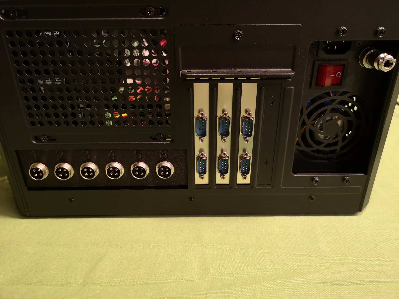

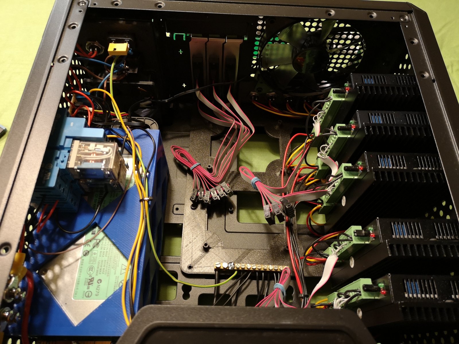

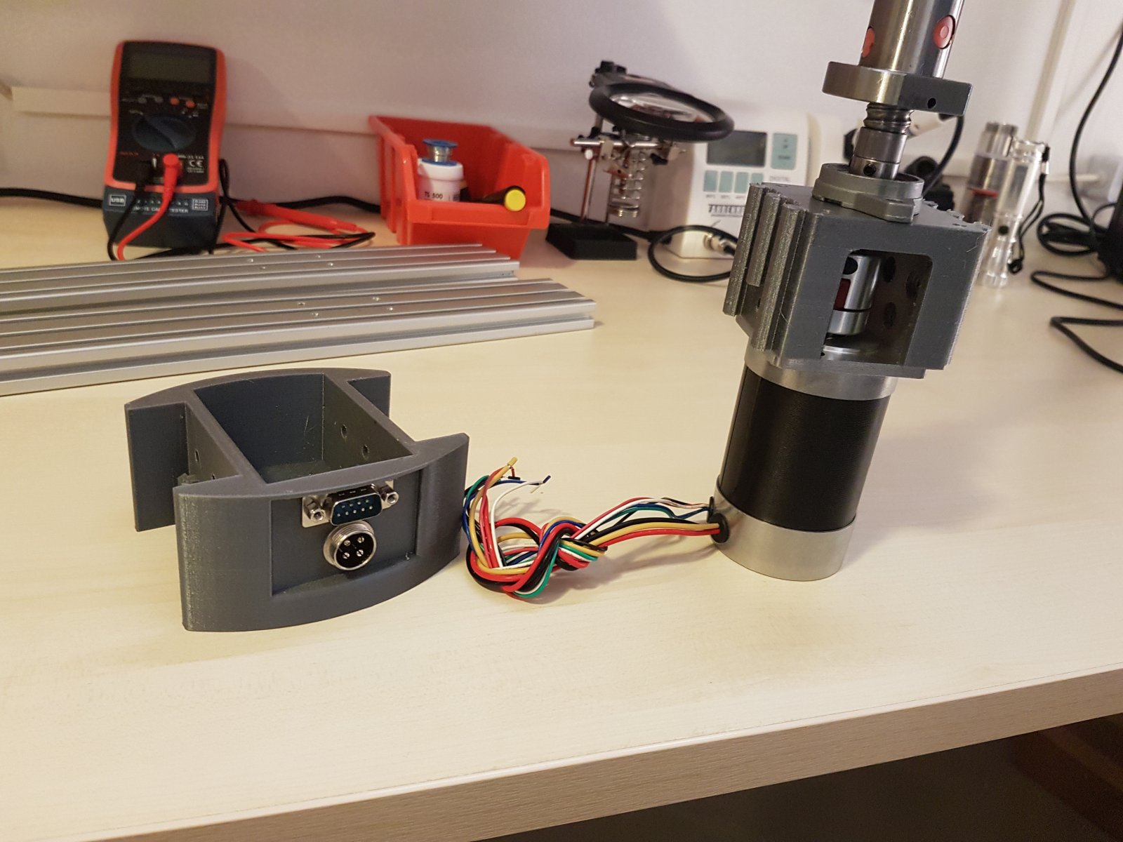

    I use 10pin com port connectors both for actuators and for motor drivers. Every channel have two connectors in parallel connection.
    I used 2-ports com port ribbon cable to actuators like this:
    https://www.ebay.com/itm/2-port-Mot...445443?hash=item2aa2a67943:g:3g8AAOxyQyJRm5yL
    I use them for motor controllers too but cut the RS232 connectors. The RS232 connector is used for actuator side, and the ribbon is used for motor controllers. Between the controller box and actuators I used nullmodem cables. You can see the wire colors order in the pictures below.
