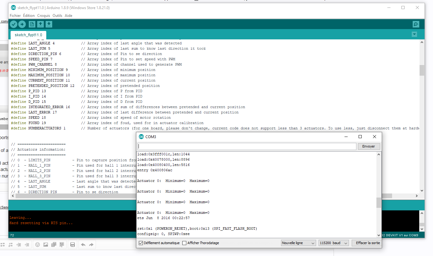

    I try this new set up like your but I have some problems !( With ESp32 position control by internal BLDC sensor ).
    What happen :I push button ( EN) on esp32 , the actuator start in the middle to minimum switch fast , stay there like (3 sec) and after goes up fast to maximum limit switch and stay there but don't come back in the middle .
    The resistances are still 10 k .

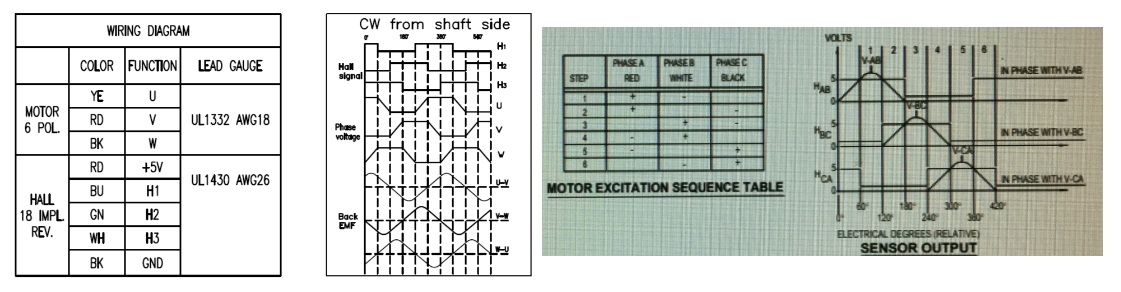

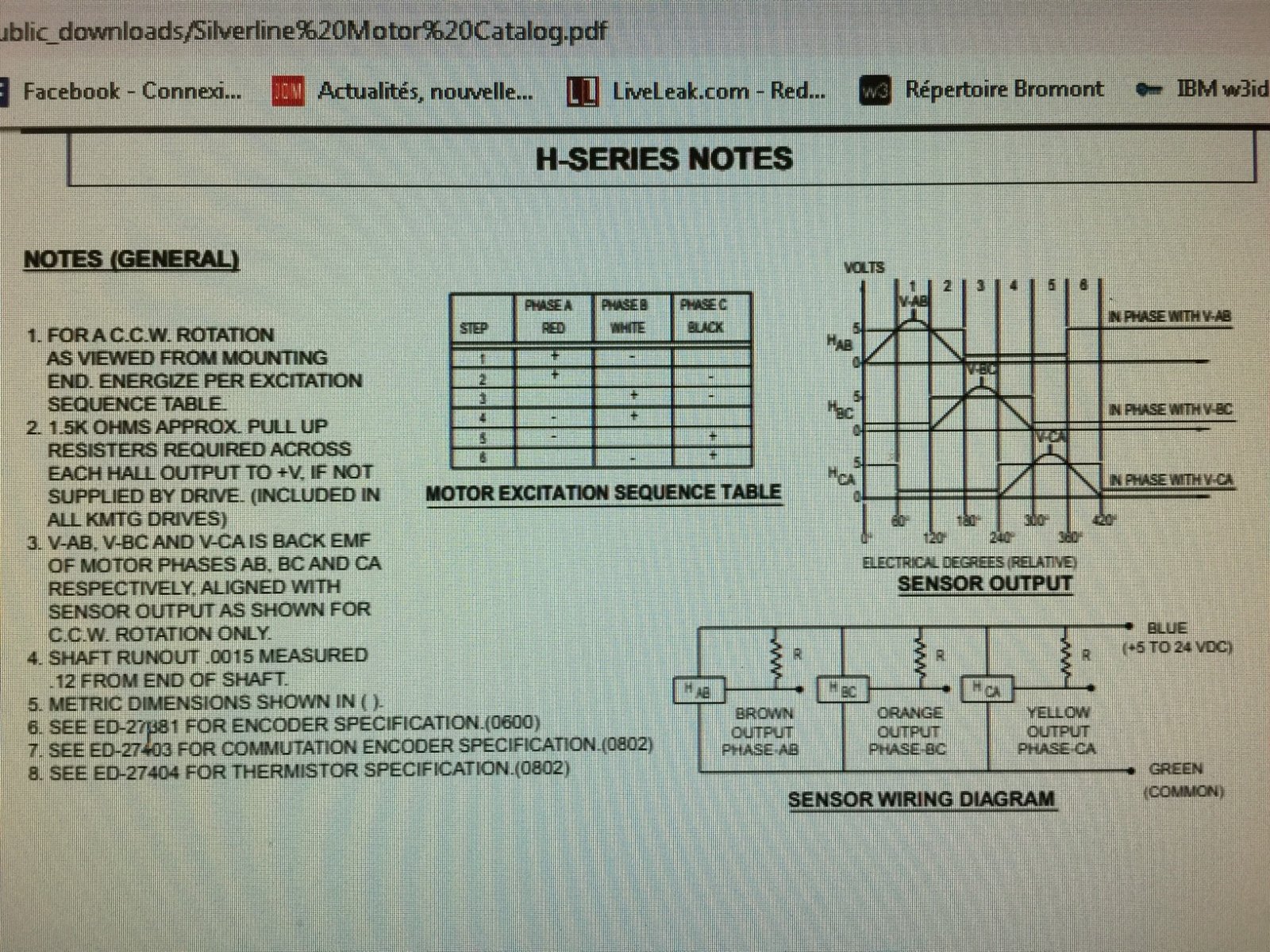

    Things who are diferents than yours :
    1- Level shifter 3.3v /4.6 v other side ( I don't have 5.0v) and the spec is 5v to 24vdc see pic . Before my drive was pushing 6 v....and now 4.6 v...
    2-Travel microswitch minimum to maximum is 500 mm ( I thing I have a little bit more travel than you).
    3- Diagram of Halls is diferent too . My set up is : (Phase A-B Hall 1 brown / HW gray , Phase B-C Hall 2 orange /HV green , Phase C-A Hall 3 yellow / HU blue ) .
    I will try to learn your code c++ on Esp32 :rolleyes:
    Thanks !
    Diagram Kollmorgen H-344-h-0000

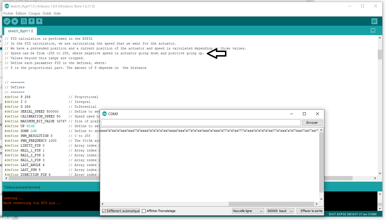

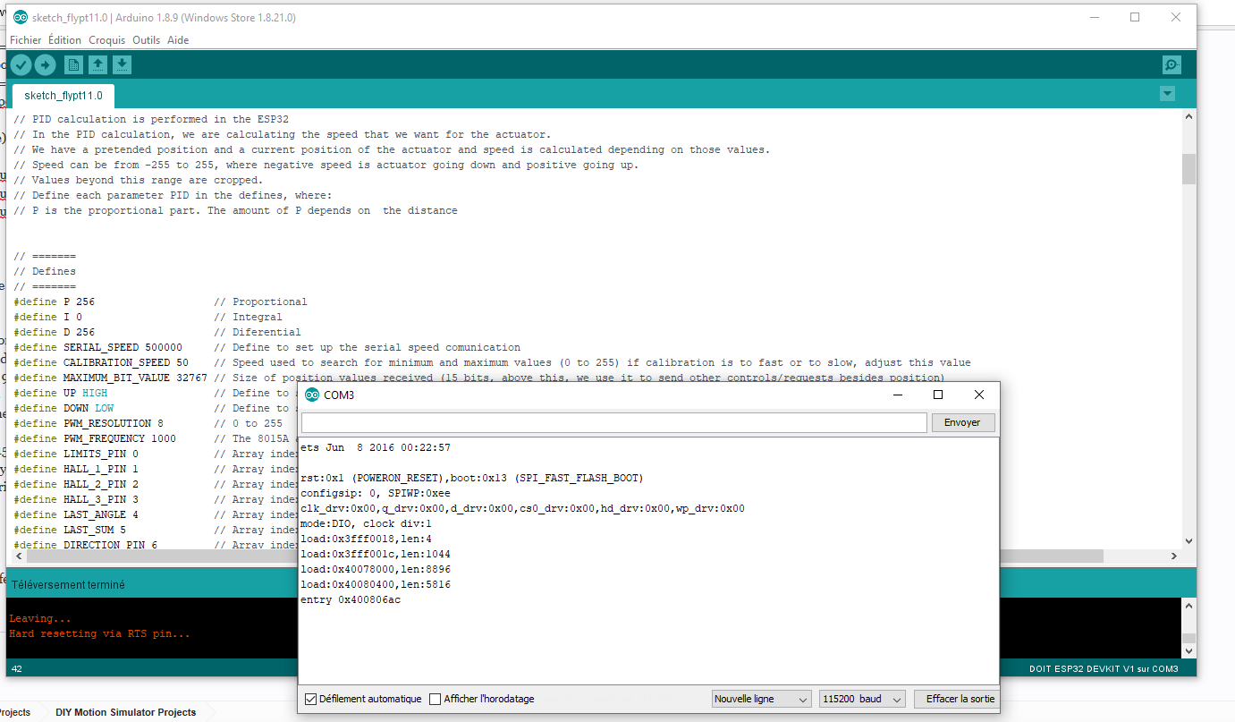

    I'm a bit busy these days.
    I will post a new code today.
    Please use that one for testing. It's faster and that way we are in he same version.
    If the calibration speed is to fast, you can lower it on the defines.
    In the version you are using, after the reset, the behaviour should be:
    - Led blinks for 5 seconds before starting calibration
    - Actuator goes down looking for minimum
    - Actuator goes up looking for maximum
    - Actuator goes to the middle really fast (position zero) and waits for serial commands
    In the new version (11.0.is) the behaviour is:
    - Actuator stays down at minimum position and waits for serial commands
    The new version is faster and uses a different string format.
    Give me some minutes to clean it up and I will post it.

    @Flymen ,
    The diagram is the same, but colours change:
    Code:
    Mine   ------------------------   Yours
    Red       5V      5 to 24V        Blue
    Black     GND                     Green
    Blue      H1         CA           Yellow
    Green     H2         BC           Orange
    White     H3         AB           Brown
    Mine is what I have in my motors and on the diagram

    Hi ,
    I'm lost…
    I have this feedback on the serial monitor of the Arduino IDE when the actuator goes down and up with version 11.0 !!
    *Jun 8 2016 ???
  6. pmvcda
    pmvcda aka FlyPT
    Nov 3, 2010
    2,230
    Portugal
    15,659Coins
    +2,665 / 17 / -0
    In the code you have 500000 speed and in the serial monitor 115200.
    Try using the same value
    What you see there is the Esp32 booting, and the date is related to that.

    With the same value !!

    Try to change serial speed to 115200 in the code and the serial monitor of the Arduino IDE
    Why?
    Because at startup, I think that's the speed you get until you change it.
    All those symbols you see are the boot message received at 115200.
    After that and after the calibration it should show the minimum and maximum travel of each actuator at the serial speed you specify in the code.
    So keep it at 115200 to see all the messages.

  13. Flymen
    May 19, 2018
    344
    Montreal, Canada
    2,476Coins
    +193 / 2 / -0
    DC motor, 6DOF
    Good news ! is better !:grin
    Now I can see something like that !!
    Actuator 0: Minimum=0 Maximum=0
    And the actuator board is number 3 who working ….. but he goes down, wait 3 sec after goes up and wait at 2 inch below the maximum microswitch …. it 's like the reverse than you finaly ..:think
    I will try something others… and I will send you a video

    This video show the sequence electric of Hall sensor output 1 AB-2 BC-3CA when the actuator goes down ( C.C.W ) .
    Fluke Yellow no 1 , Fluke Black no2 , and gray no3.
    Video:
    It like the table : electrical degrees relative ( see pic.)
    Q- Your table have the same timing or phasing ?
  19. pmvcda
    pmvcda aka FlyPT
    Nov 3, 2010
    2,230
    Portugal
    15,659Coins
    +2,665 / 17 / -0
    The sequence is the same, but one is CW and the other CCW (they are always the same)
    This is my sequence compared to yours:
    Maybe try swapping H1 and H3 again.
    But even exchanged they should show something.
    That's what I find strange. I don't see any problem on the code.
    Could it be on the limit switches?
    Are you sure they are correctly connected?

    And show me the output of the serial monitor.
    It's already for 1 actuator at 115200
    It should show the position while it searches for her.
    Do you have a separated motor to try it without switches?
    Depending on result, it's the next step.

       limitValue = (analogRead(actuator[0][LIMITS_PIN]) + analogRead(actuator[0][LIMITS_PIN]) + analogRead(actuator[0][LIMITS_PIN]) + analogRead(actuator[0][LIMITS_PIN])) >> 2;
       Serial.println(limitValue );
    It should show for the first actuator, the value we receive from the switches.
    If you press the min switch you get zero
    If you press the max, you get 4093
    If you don't press the switches, you should get something in the middle
