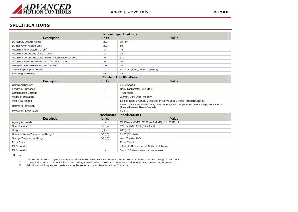

    Hi ,
    I don't see a difference , No change always the same ….
    Control Specifications of my drive for Switching Frequency is 33 kHz and your is up to 1 kHz ?
    I did that but no change : #define PWM_FREQUENCY 33000 ( you = 1000) // The 8015A accepts up to 1 KHz
    I lost the light at the end of the tunnel …..:(

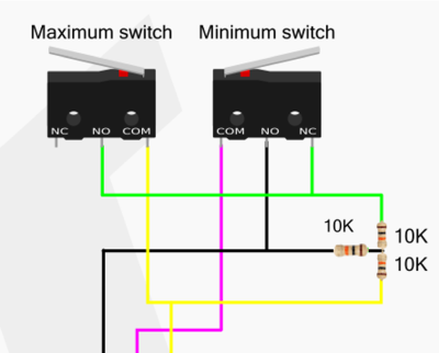

    On the wiring diagrams there is a minimum and maximum switch, just to check the minimum switch goes at the motor end of the actuator.
    Looking at the internal hall sensor wiring diagrams. There are 2 different ones, one for 1 actuator and one for 3 actuator. I've tried building the 3 motor design, with only 1 attached though and doesn't seem to work. Do I need to assemble all 3 and attach them for it to work?
    Also I saw on a few pages previously that the switches could be wired up wrong. Is the correct way the one posted by @Flymen on page 19?

    The switches work for me. I think the diagram is correct.

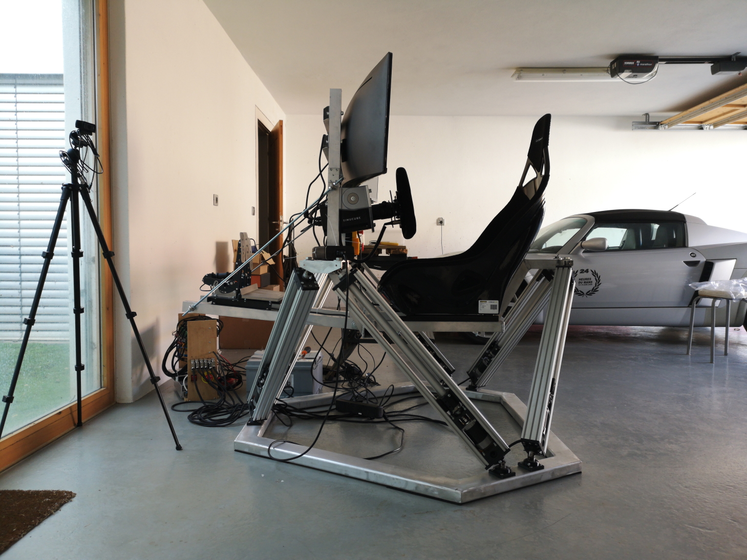

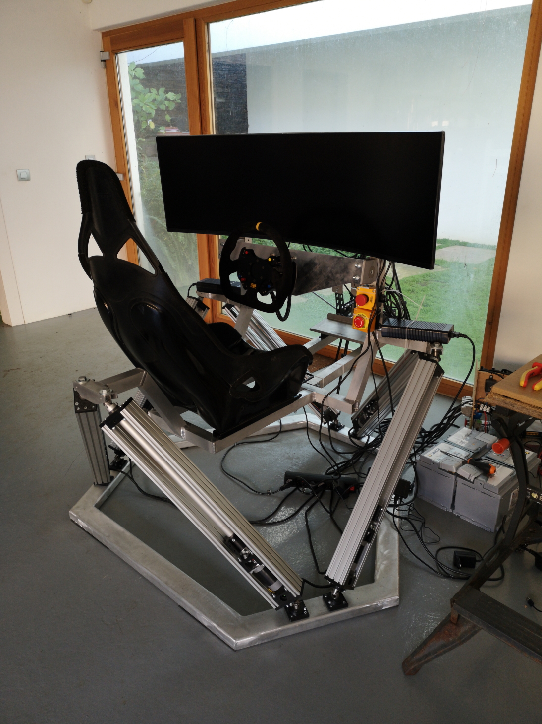

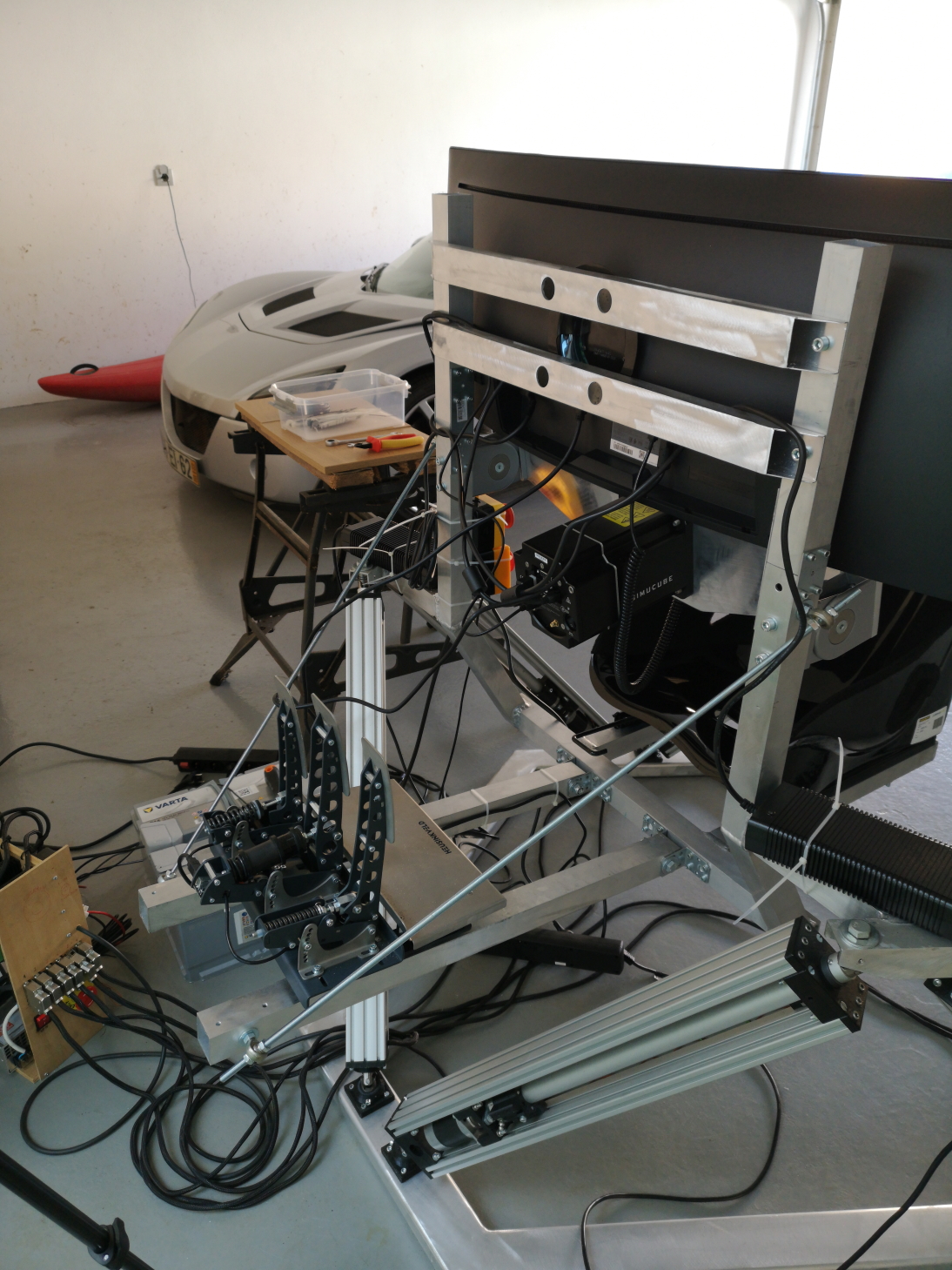

    Some updates on the current state:
    Needs cable management...
    There's something new here, the batteries.
    With the increase in weight, the PSU was always at full power and I was afraid to run into problems with the back current, so I used two batteries.
    The PSU now runs silently, and there's more power for sudden moves. General behaviour seems better, but it has a cost €€€.
    I have to adjust the PID, because of the extra load. Need to differentiate the up from down movements, to give more power to the up compared to down. The extra load is starting to make problems,but I think it's not going to increase much more.
    Video soon, when cables are organised.
    Also need a good box for the controllers.

    Looking good. I thought you were going with VR not a screen, that would save some weight.
    Thanks. Will give that a go when I have a chance. Don't worry about taking time as will take me a while too. ha.

    I'm all for VR, but I can't use it to much time. I get nauseas easilly.
    Also, it was stolen by my kids, not only the vive, but also the PC where it's connected o_O
    The nauseas problem is most because of a GTX980, I know I can make it better, but for all the setup and tests, the monitor is practical. And the rig is on the garage, while the vive is inside the home.

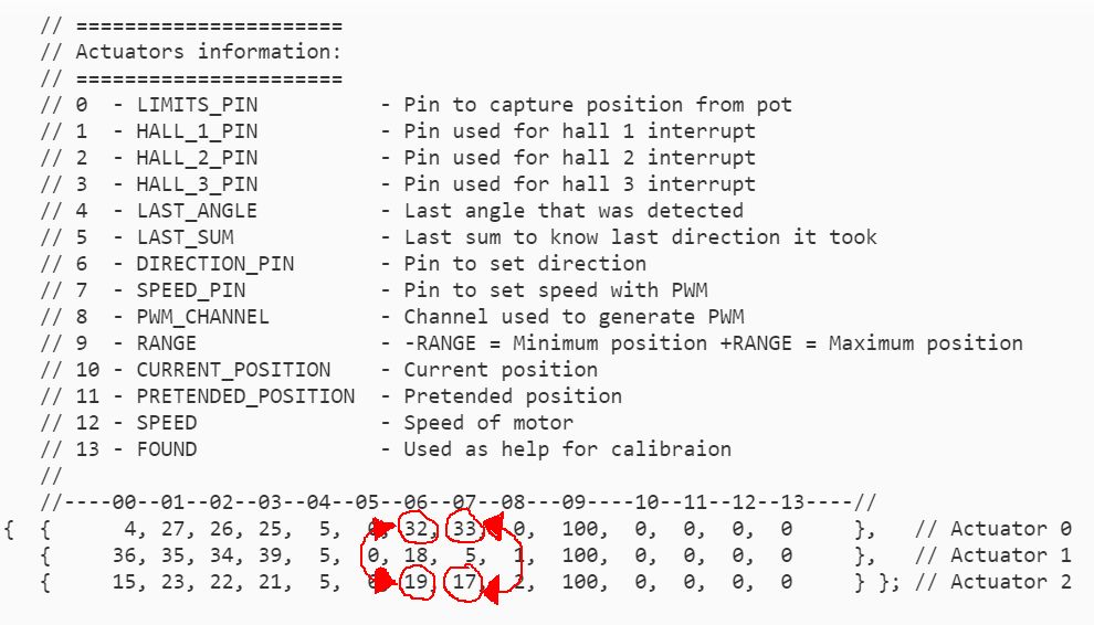

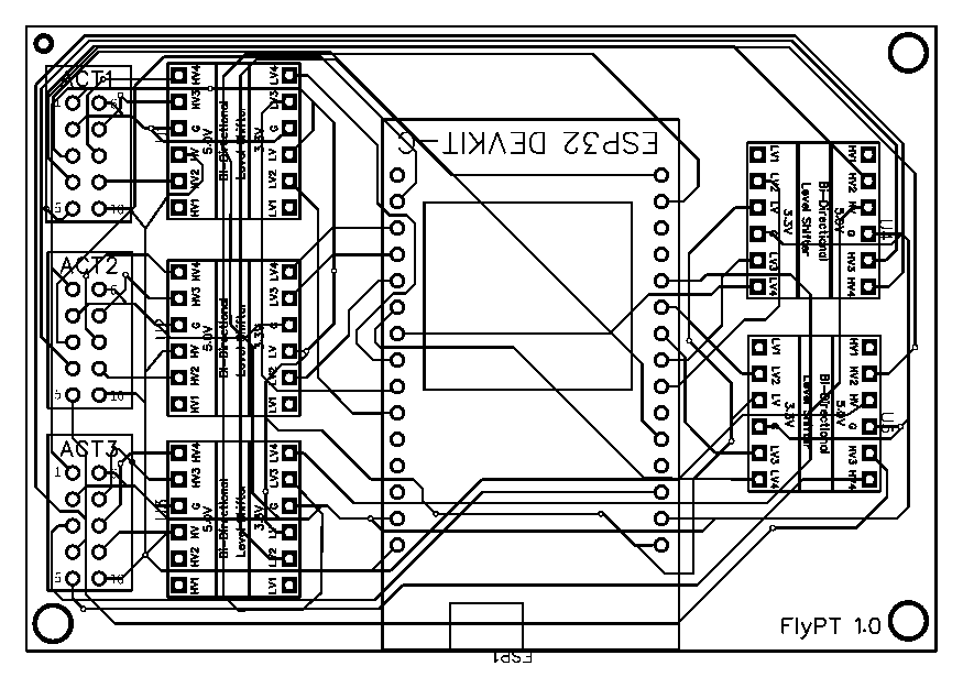

    Was pointed to me by @Gabor Pittner , that I have the direction and speed pins swapped between actuator 1 and 3 (0 and 2 in the array).
    When I made the drawing, I swapped it. Really sorry for the error.
    To solve it, we need just to swap the pins in the code. So I updated the code in the first page to reflect it.
    -The change is this: (picture by @Gabor Pittner )
    So all the code is now updated to solve the problem. In my boards it's different, but anyone following the schematic, should use the latest code version.

    Hi @pmvcda !!
    (First of all I want to say many thanks for your help!!!! my FlyPT configuration is work well now, I plan to start my own topic to document this project too.) :thumbs
    At first I've been struggling with limit switches, so I changed a bit the circuit. Put one more 10k resistor between resistors and GND wire. The result is fine. Now the voltages on the control wire :
    Normal state 1,65V
    Maximum switch is activated 3,3V
    Minimum switch is activated 0V
    I tested it with your limit switch test code, and it works well, the values are:
    Normal state = about 2000
    Maximum switch is activated = 4093
    Minimum switch is Activated = 0

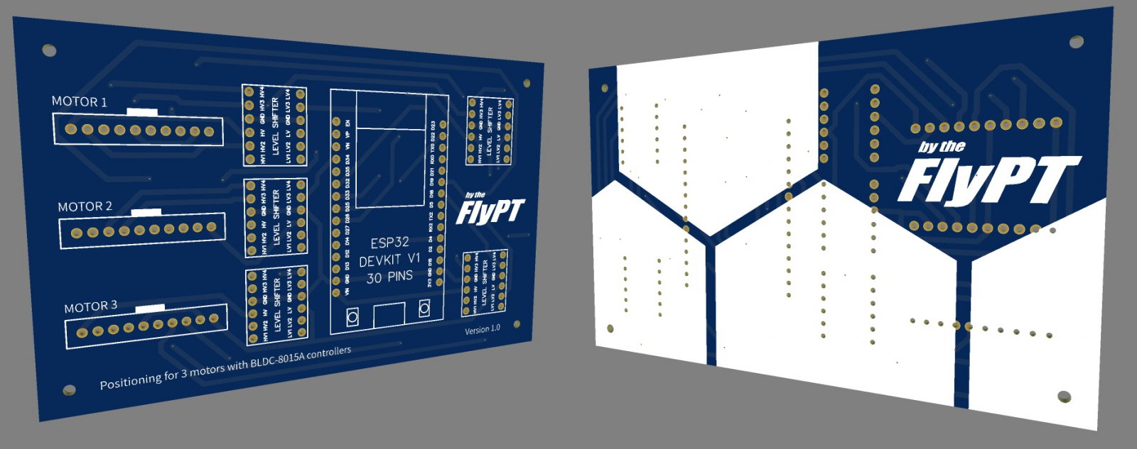

    Waiting for the PCBs.. Lets see if i messed it up ;)
