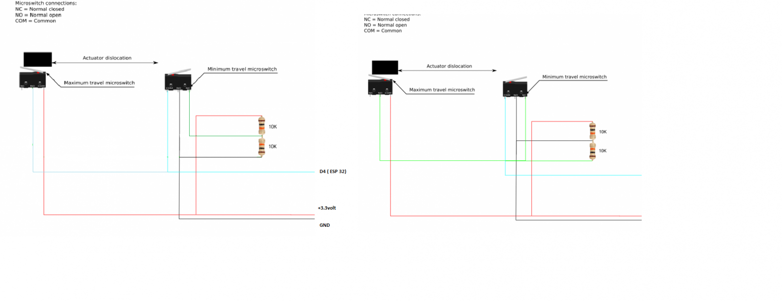

    ok thanks for testing switch with code ! Iwill try it tomorow
    what I did is : on the purple wire ( return minimum microswitch ) I have : non active switch ( both) 0.723volt and maximum active : 3.3v and minimum active 0.0v and this direct to esp32 input.

    2,272
    Portugal
    15,902Coins

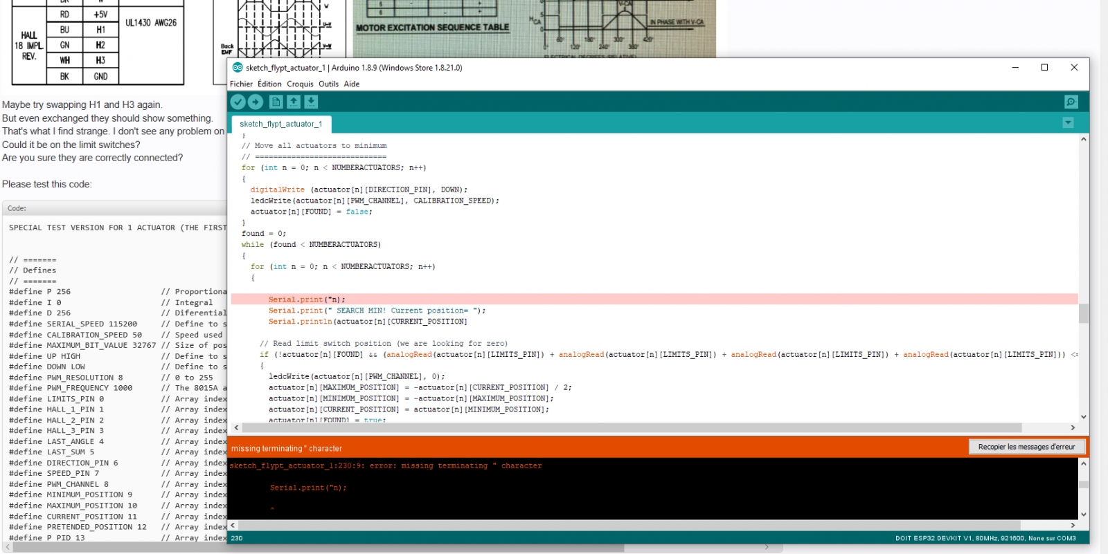

    Is that with the last code I sent you? The one before the switches code?
    It should show positions on the serial monitor.
    I mean the code in this post: https://www.xsimulator.net/communit...hless-diy-actuators.10799/page-18#post-186922

    If you press the min switch you get zero = sorry, but nothing , it moves between 54 and 56
    If you press the max, you get 4093 = it moves between 54 and 56
    If you don't press the switches, you should get something in the middle[/QUOTE] = it moves between 54 and 56
    Could it be on the limit switches?
    check 3 time = ok
    Are you sure they are correctly connected? yes
    On the EsP32 at Pin D15 , do you have this set up ?
    If you press the min switch you get : 0.0 volt
    If you press the max, you get : 3.3 volt
    If you don't press the switches : 0.723 volt
  5. pmvcda
    pmvcda aka FlyPT
    Nov 3, 2010
    2,272
    Portugal
    15,902Coins
    +2,716 / 18 / -0
    Hi, D15 is for actuator 3, that's why you dont get readings, I changed the code to use only actuator 1.
    And that is pin 4
    Connect the actuator on another port, the one that uses pin 4

    No switch pressed gives you zero?
    There's something wrong there.
    What resistances are you using?
    Please measure that pin in the 3 situations

    On the EsP32 at Pin D4 ,I have this set up ?
    If you don't press the switches :0.0 volt ( yes, here … something wrong ) :think

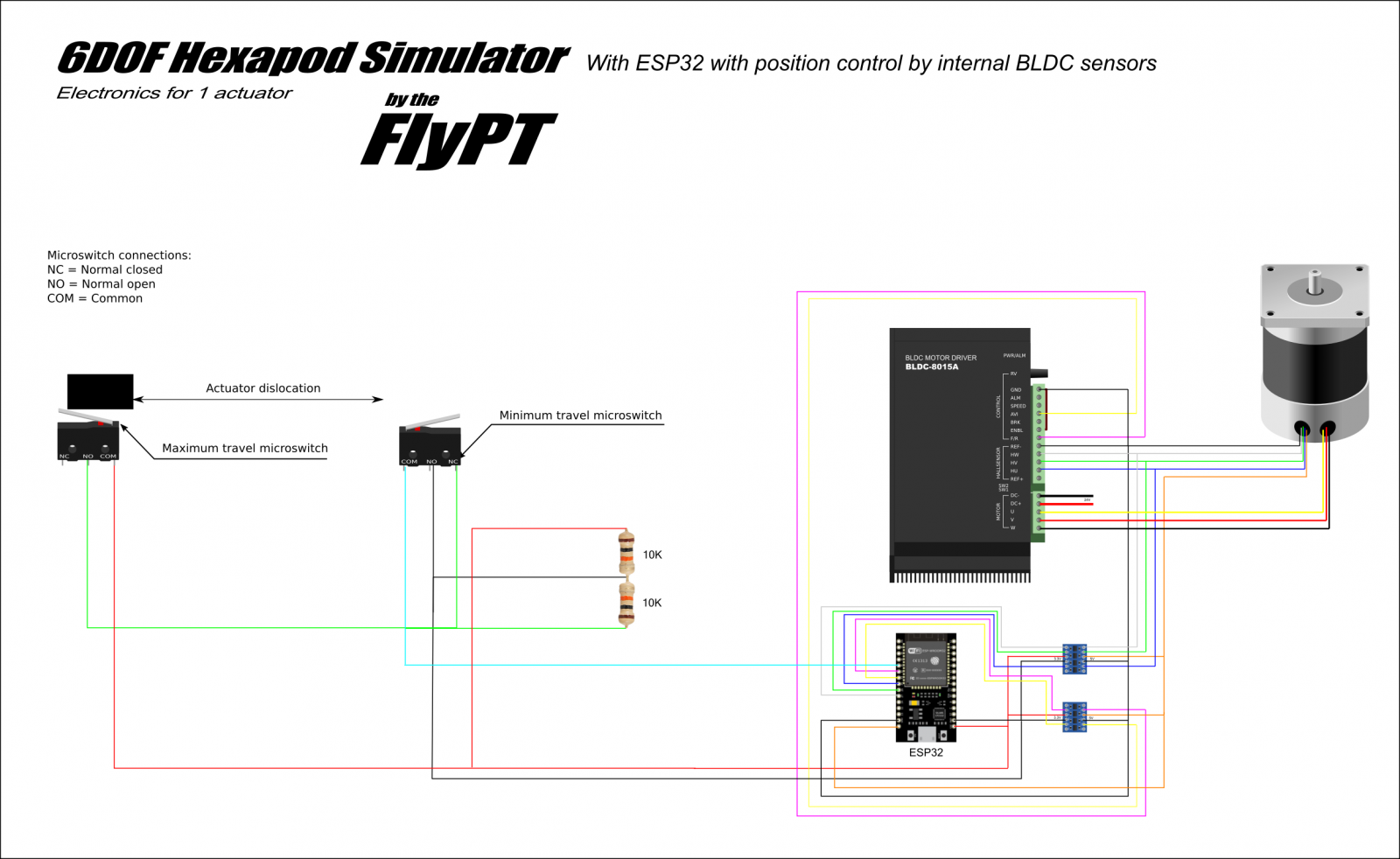

    Hi ,
    Missing something !!
  16. Flymen
    May 19, 2018
    353
    Montreal, Canada
    2,491Coins
    +195 / 2 / -0
    DC motor, 6DOF
    Hi ,

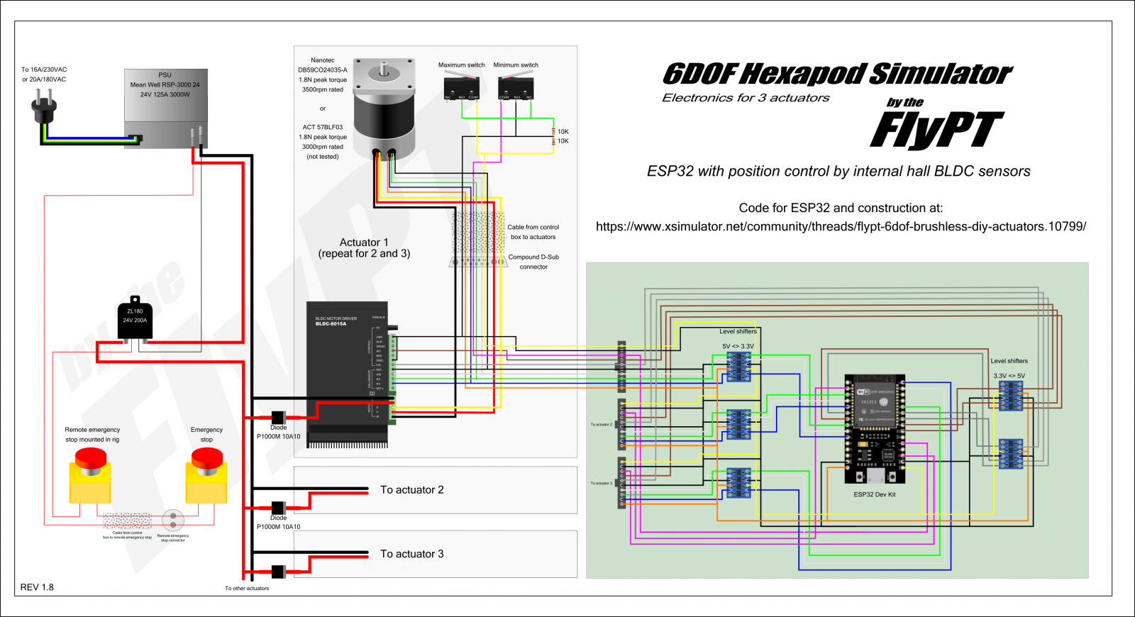

    On your electronic plan , I can see two diferences : Electronics for 1 /Electronics for 3
    Elec ..for 1 : input D-35 ( com /minimum travel switch).
    Elec.. for 3 : input are D-4 , D-36 and D-15 ( com /minimum travel switch) .
    My question is :
    If I want build just one exemple , I must take Electronics for 3 Plan (actuator 1) like D4 and not D-35 ?
    Thanks !

    Use the 3 actuators version!
  18. Flymen
    May 19, 2018
    353
    Montreal, Canada
    2,491Coins
    +195 / 2 / -0
    DC motor, 6DOF
    Hi . It me again !!!:grin
    what you told me :
    It should show for the first actuator, the value we receive from the switches.
    Can you check this ? Maybe I'm lost but … Shema( see pic ) : Left side with correction and Right side the old one .

    That's OK in the video. Use it that way.
    I might have an error in the schematic, I will take a look. Maybe tomorrow, because...
