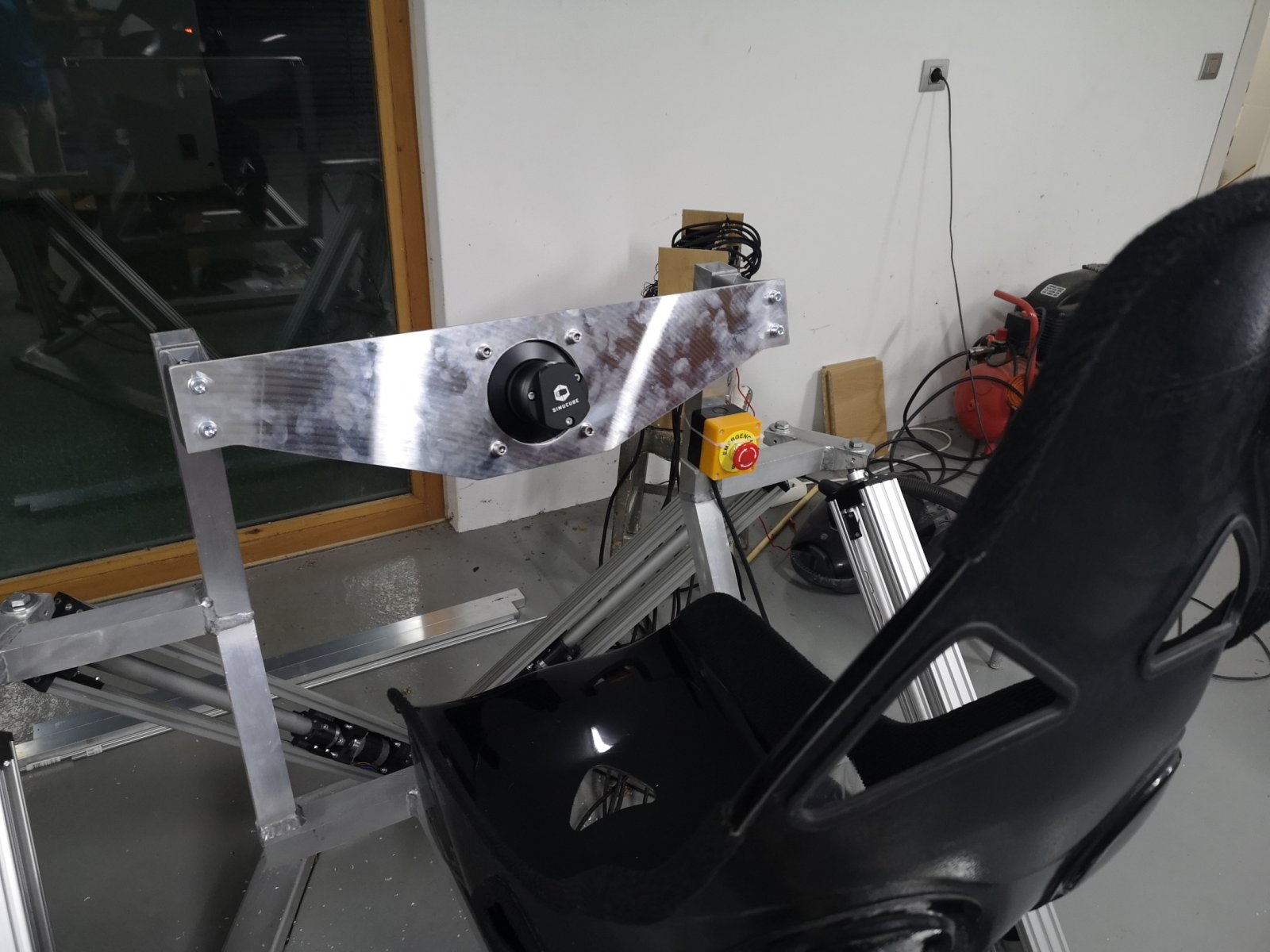

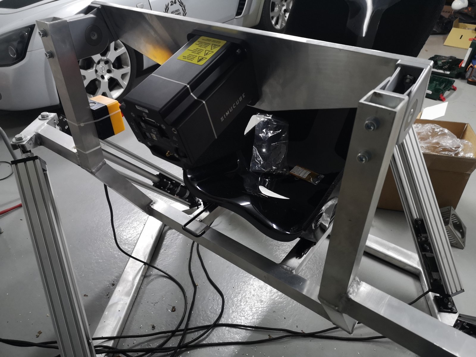

  17. pmvcda
    pmvcda aka FlyPT
    Nov 3, 2010
    2,272
    Portugal
    15,902Coins
    +2,716 / 18 / -0

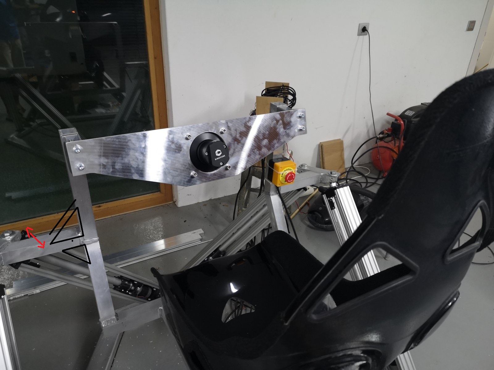

    Besides replacing the grass in the garden :roll by artificial one, here's what I'm making right now:
    That dashboard was a pain to cut and open that hole... needs some paint.
  18. Flymen
    May 19, 2018
    353
    Montreal, Canada
    2,491Coins
    +195 / 2 / -0
    DC motor, 6DOF
    Nice set up !!!:thumbs
    For your info and if you like a hard surge ( brake or gas ) like me:grin, braze those parts ( black plates ) because for my mine , i have a lot of swing (see red cross). Behind also.
  19. SeatTime
    2,572
    Yes, agree - re-enforcement required. When I had a frame on my 6DOF of a similar design - but made of box steel, the steel failed at exactly that spot and it was not the weld that failed.
  20. Trip Rodriguez
    Trip Rodriguez VR Pilot
    May 8, 2016
    683
    Lake Ariel, Pennsylvania
    3,978Coins
    +331 / 7 / -0
    Could you guys elaborate on what spot you are talking about? I'm a little slow on the uptake!
    I was looking for "black plates" but didn't know what I was looking for otherwise.
