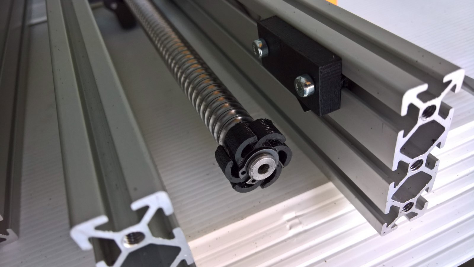

    Hello Starter PMVCDA, in the meantime I thank you for your technical support and for your answers. Unfortunately I'm Italian, I've already seen 3 times, all 14 pages of posts. I translated your posts, I realized that they are DIY cylinders, aluminum profiles, I saw that you used DC 12V motors, you used Sabertooth, you made 3D components for potentiometers, used screws to recirculate balls. I read everything because of the translation. But I think I understood 90% of things.
    I will wait for you to try the brushless motor controllers, I will be curious to know if those controllers are able to withstand the declared current (15A, 500W).
    I want to ask you something else: if I wanted to use the motors that have the output shaft with different coupling (see figures) which flexible joint (coupler shaft) could I use?

    I used 24V brushless motors (NANOTEC DB59)
    I don't even speak about a Sabertooth...
    For controller I use the BLDC8015A.
    Started using pot's, but removed them and I use only the internal hall sensor of the BLDC motor for positioning.
    There are couplings of different sizes. So yes you can use them.
    You have there (2nd) a motor with a key. Maybe remove it to use a standard coupling.
    The others are all compatible with current couplings. Maybe not ideal, but they work.
