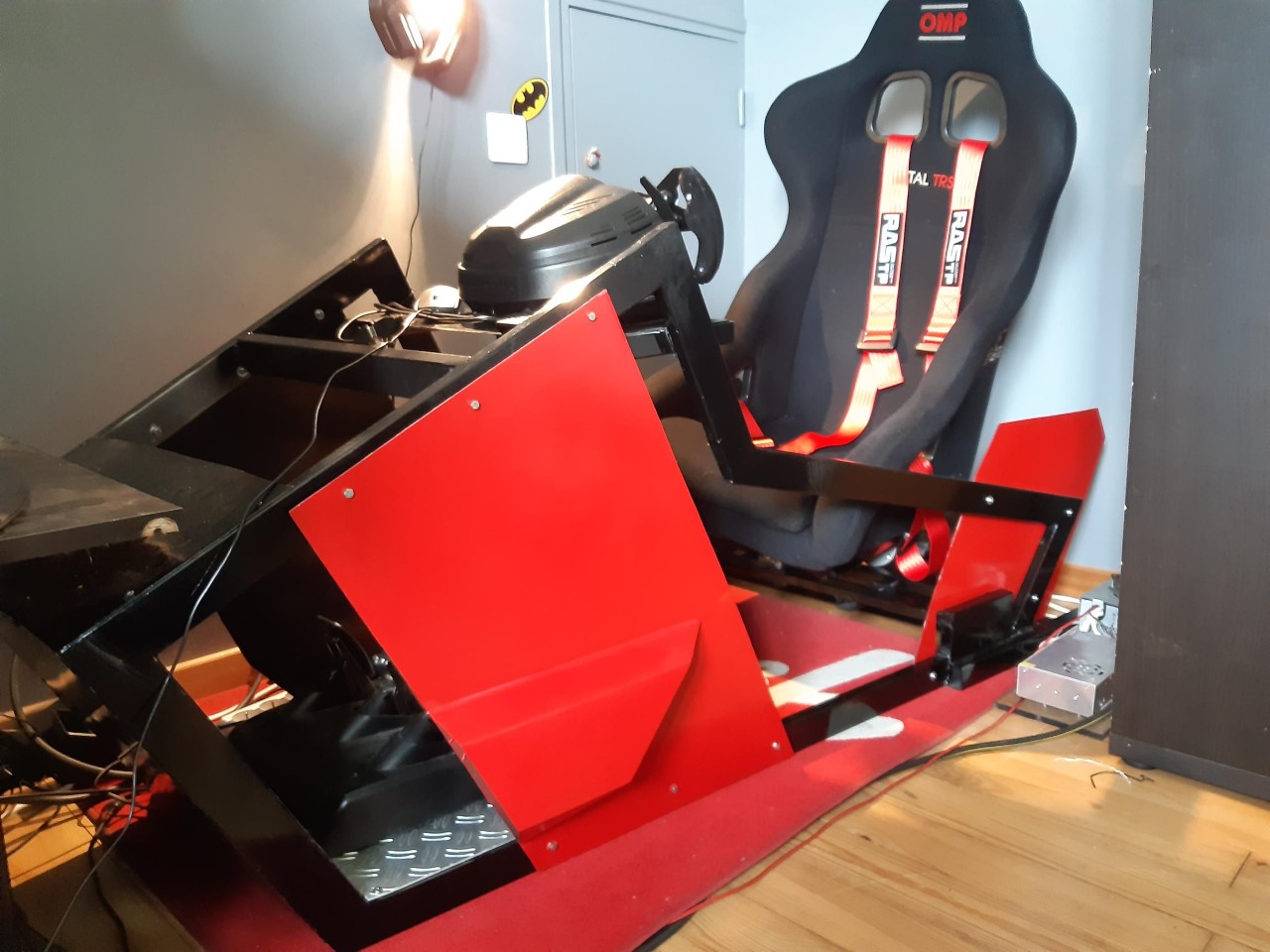

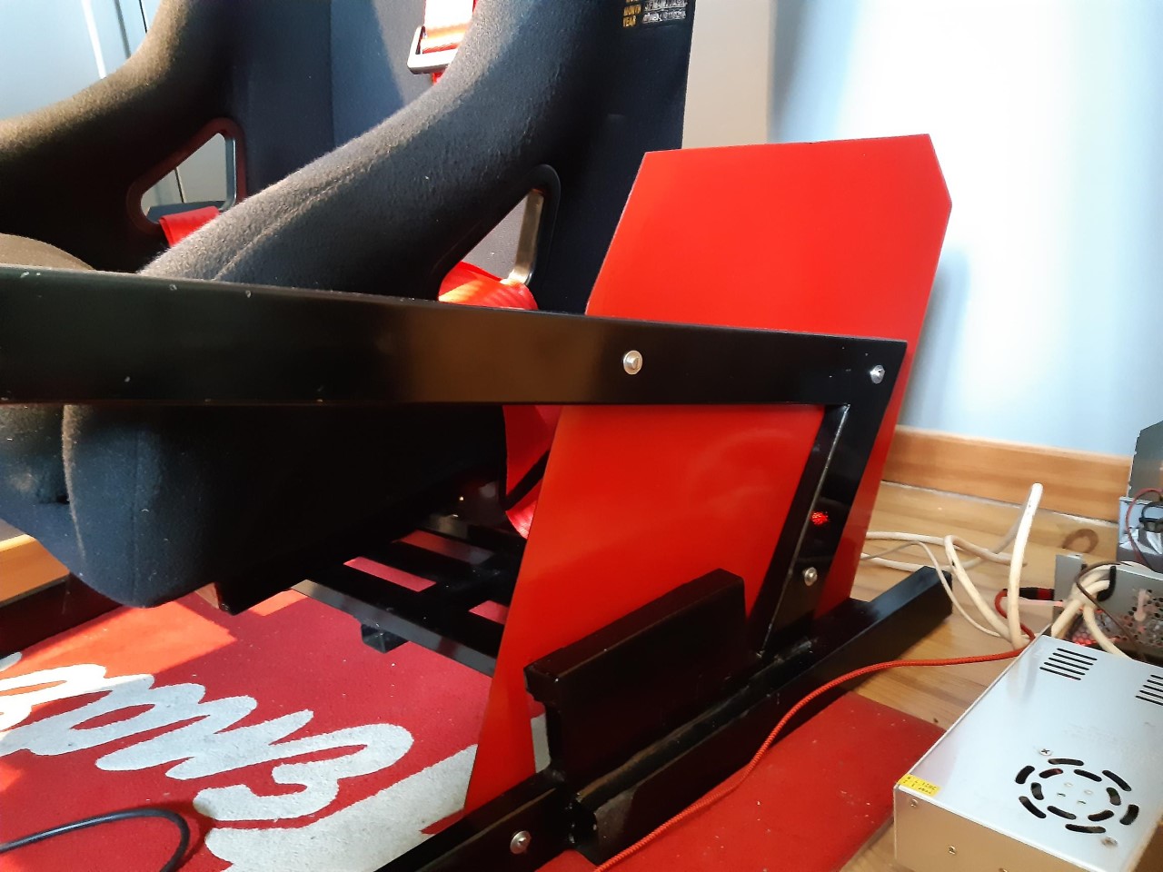

    I advanced in the aesthetics of my simulator by installing the sides, it looks more like the starting idea

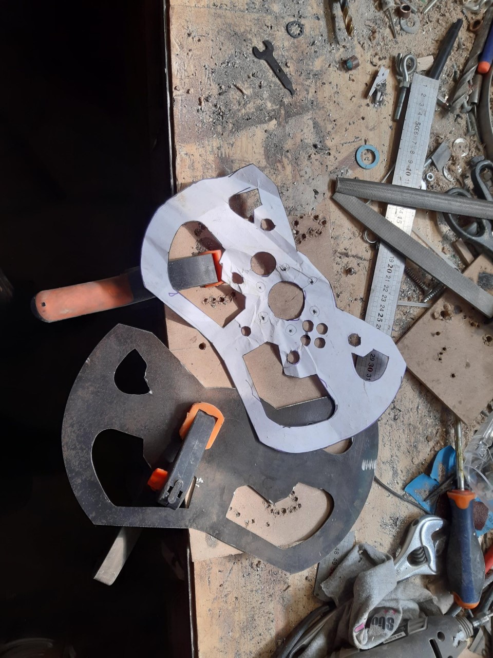

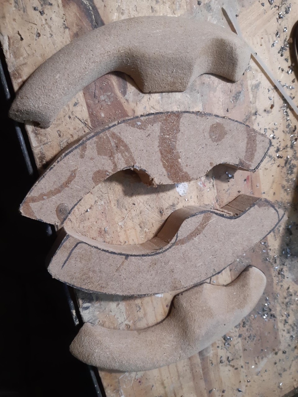

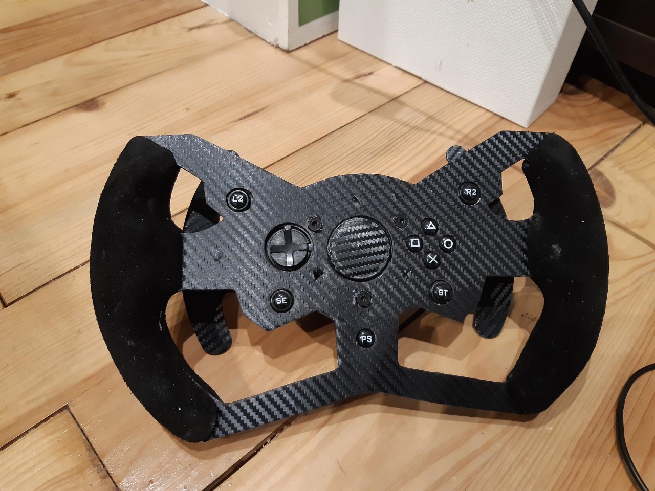

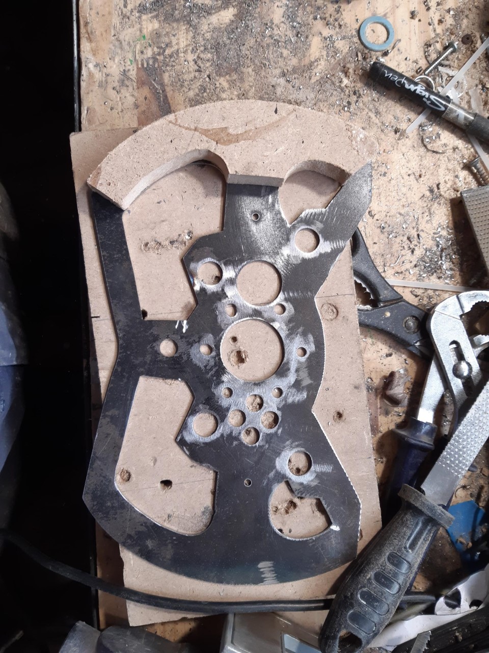

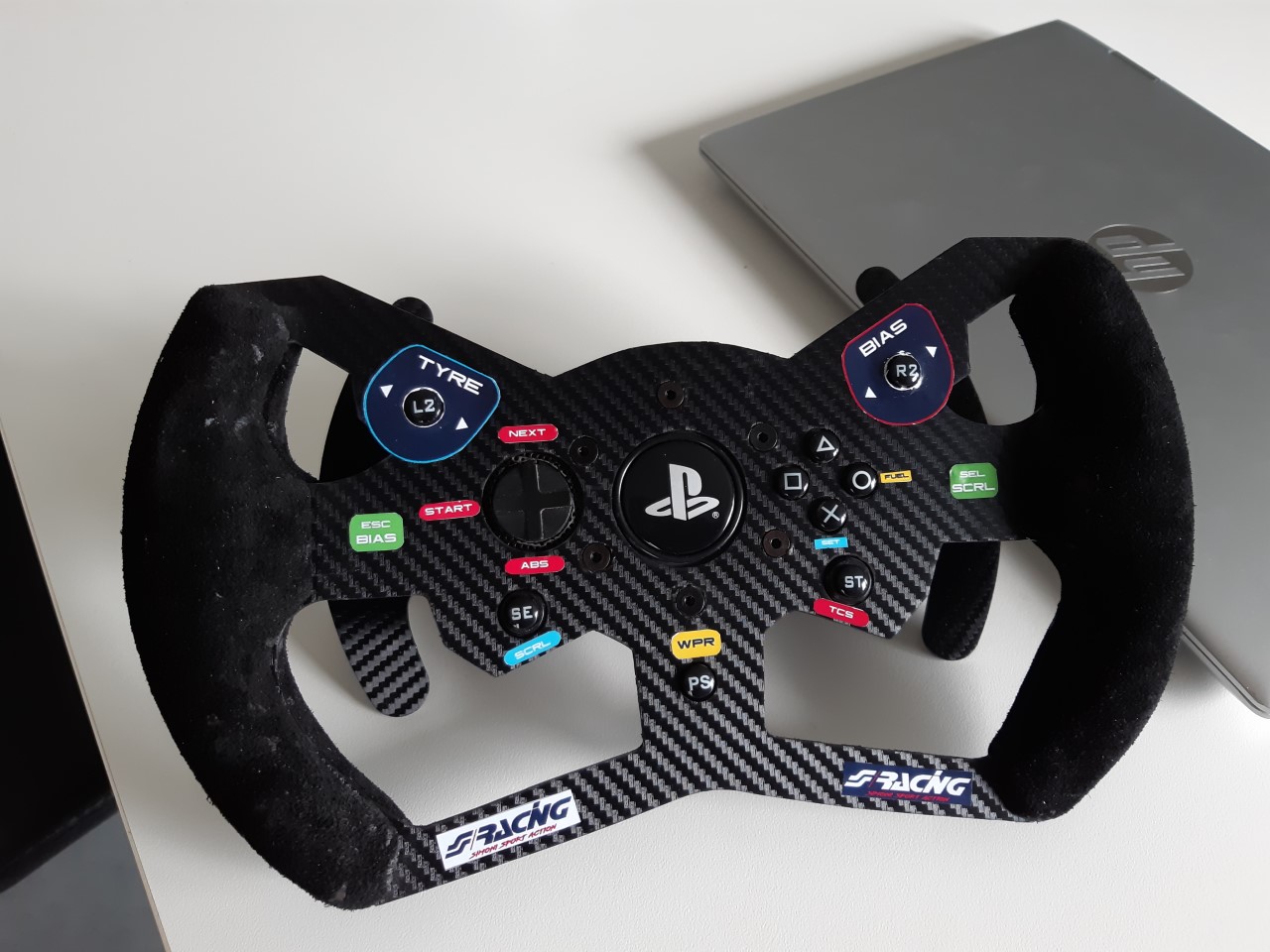

    What could be better than a DIY steering wheel to accompany a DIY simulator

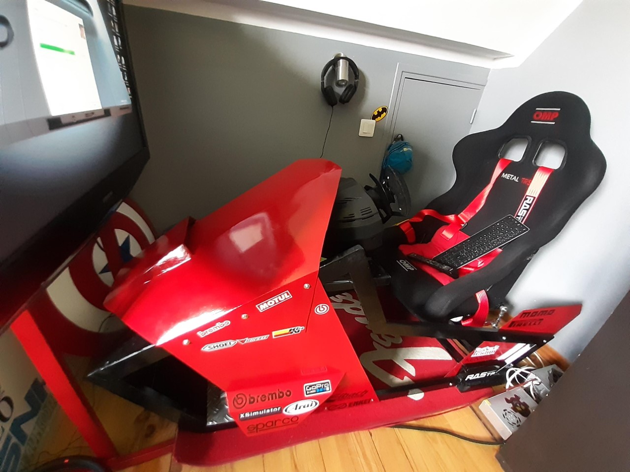

    I'll show you the final version of my project

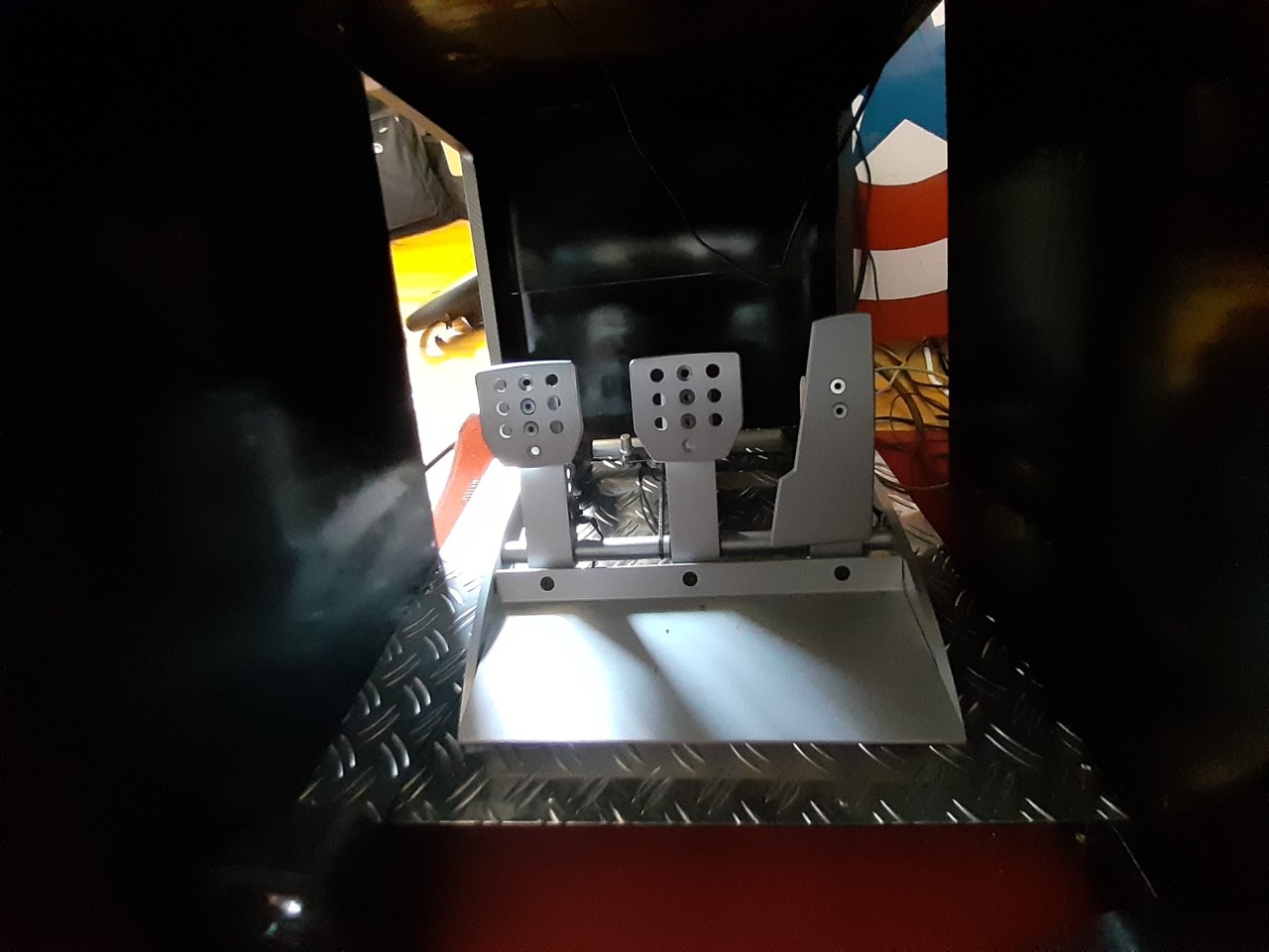

    And the small crankset that I bought myself used but which works perfectly, and with the loadcell it adds to the immersion

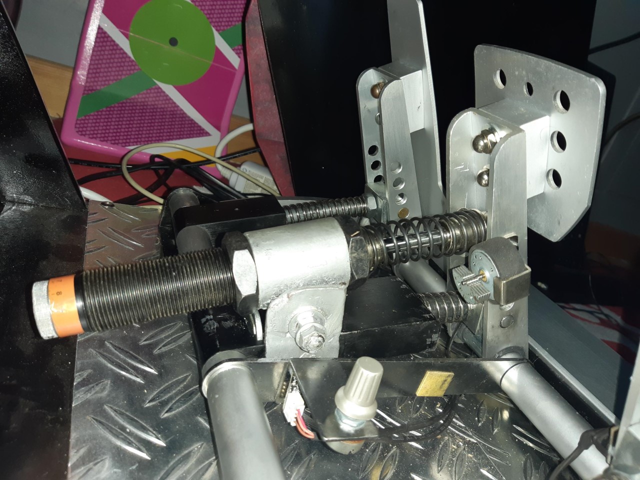

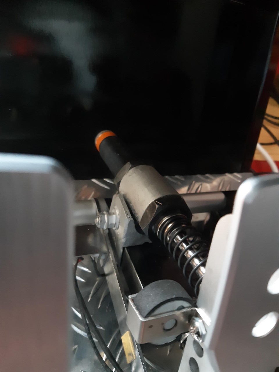

    I made a part to adapt an adjustable damper on my pedal for the brake pedal as well as the replacement of the spring on the accelerator pedal, all in order to always add a little more realism to my simulator

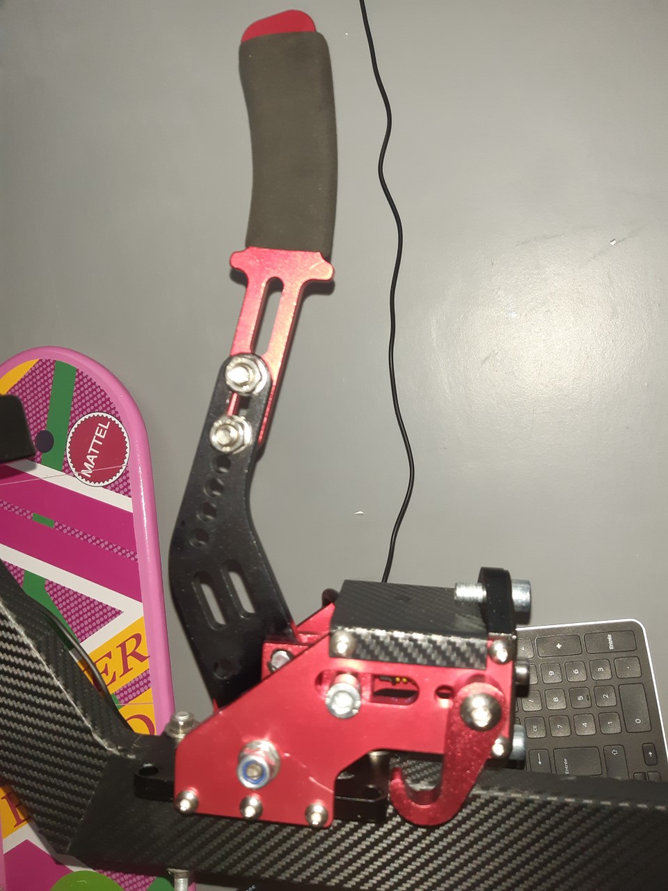

    I had also started the realization of a handbrake but it could not have worked when "all or nothing" but I found one in 16bit for barely 40€ and aesthetically much nicer
