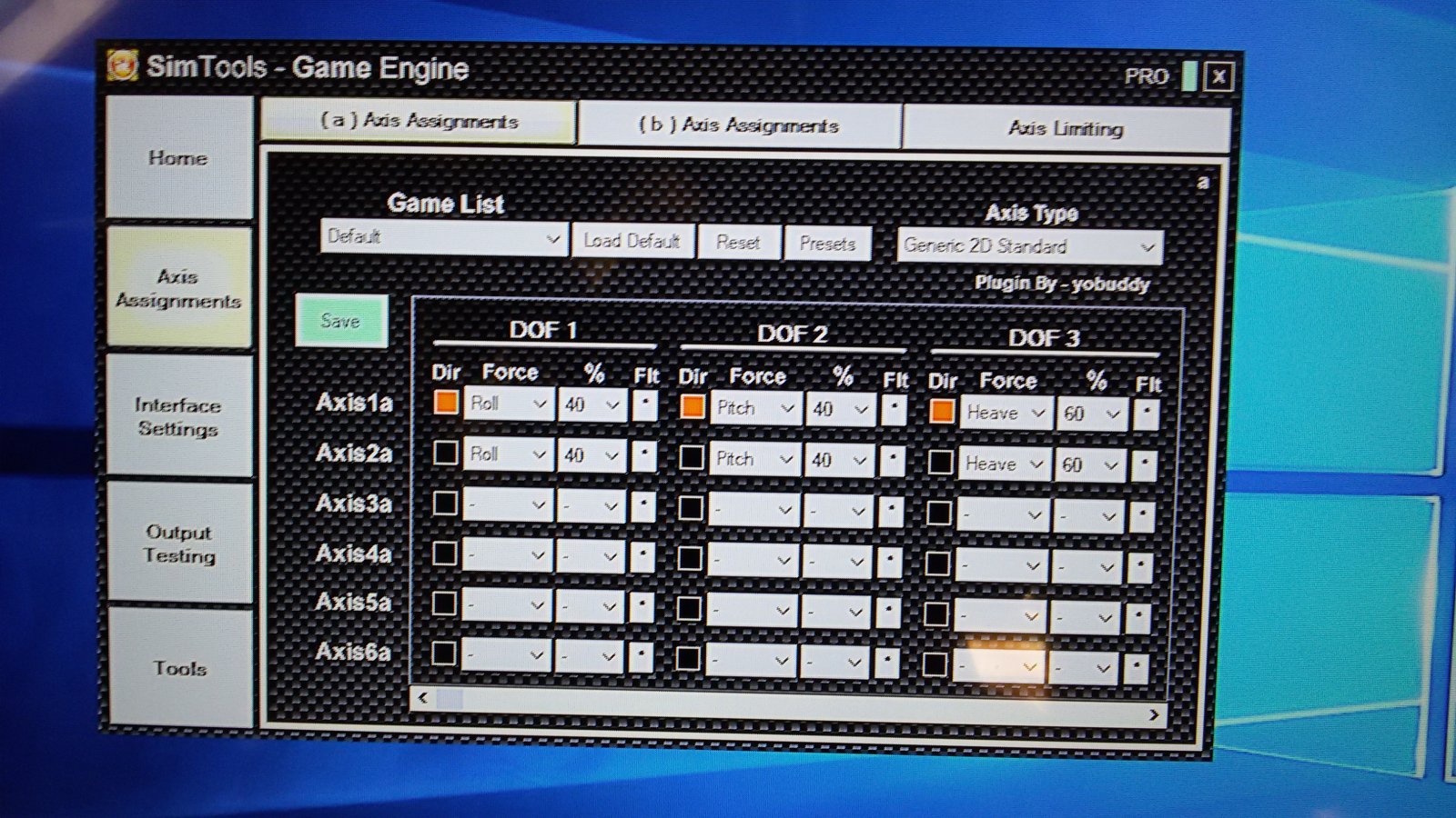

    I installed the plugin and I selected F1 game.
    I made the acquisition of the MAX and MIN limits and saved it.
    Using the Output Testing the SIM does not react and tends to move even without controlling it.
    Now check again that the default profile is configured well to move the SIM with the Output Testing.
    I realized the work following the nice tutorial of RacingMat:
    https://www.xsimulator.net/community/threads/from-atoz-2dof-arduino-wiper-playseat.4616/
    The motors respond as expected from the tutorial and I have only changed the max and min value of the POTs within the software, in my case the amplitude of the rotation angle of the motors is 180 °.
    The configuration of the interface1 is for Arduino and I have attached the photos.

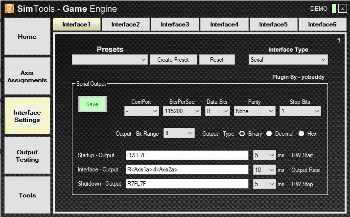

    I think you got the "Inferface - Output" setting wrong, it should be: [A<Axis1a>][B<Axis2a>]

    If you are using @RacingMat's code your Interface Output should be R<Axis1a>L<Axis2a>

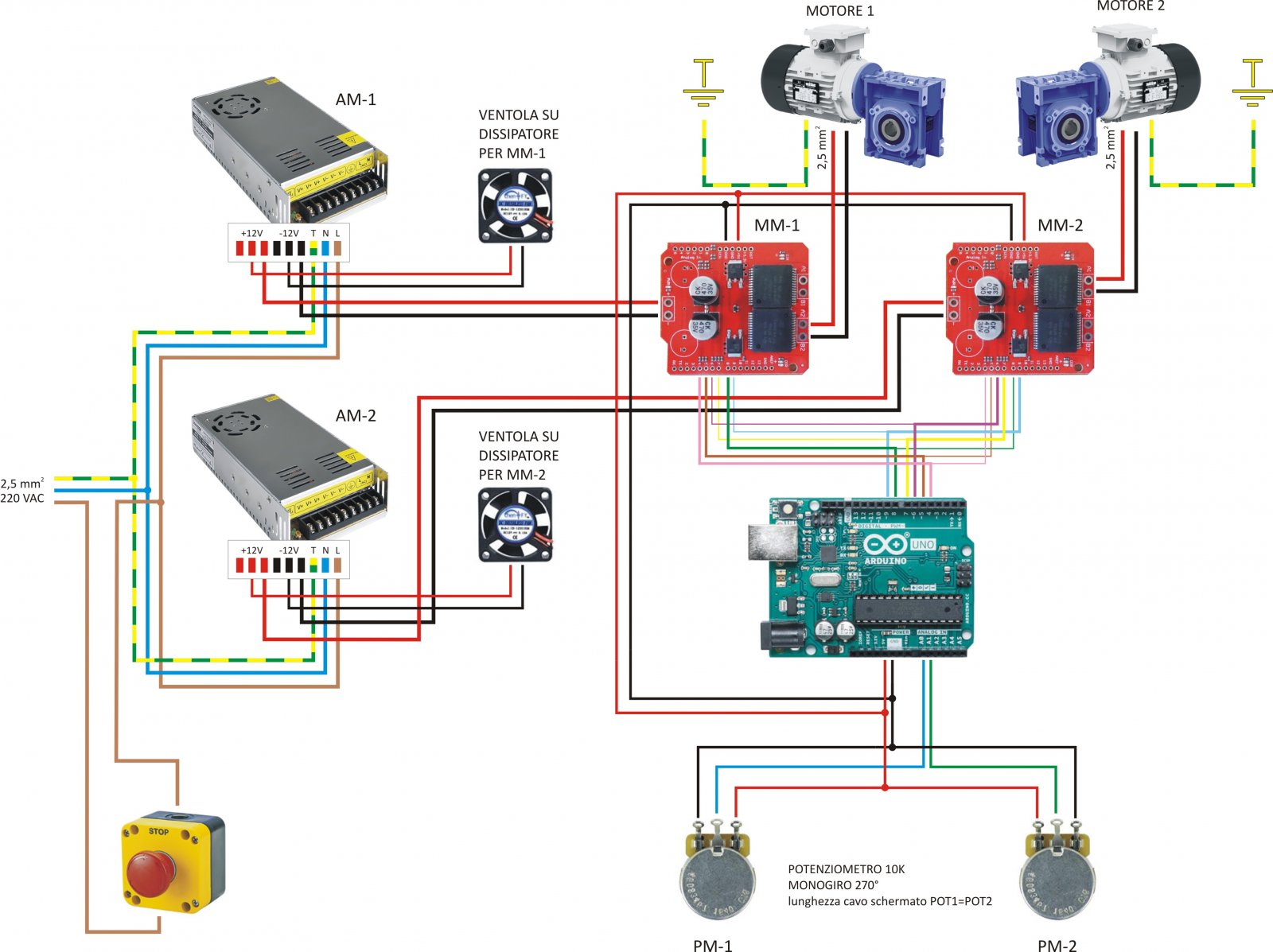

    I followed the RacingMat tutorial
    Windows 10
    Sim Tools 2.2.5
    Arduino1
    MMS VNH2SP
    COM3 port Set as data of interface1 (POST#3)
    Interface OUT [R <Axis1a>] [L <Axis2a>] or R <Axis1a> L <Axis2a> (try both)
    Power supply 220V.
    12Vdc motors - 235W - 26A - 2000 rpm.
    Reducer i = 30
    The wires that connect arduino to the MMS of finer thickness I had to connect them because the circuit did not work.
    So connected by measuring with a votlmeter I found to have the 12V on the outputs of the MMS.
    I connected the cards in parallel.
    I had some doubts about this variation to the tutorial but the tests I performed gave a positive result.
    (I have an explanation on this variation that has depended on the quality boards, if interested I can deepen).

    You should not have spaces in your Interface Output settings, Output Bit Range should be 8, so your settings should be like this with ComPort 3:

    Ciao noorbeast,
    I tried the suggestions, it is as before the SIM moves randomly without giving commands.
    I also tried without spaces:
    R<Axis1a>L<Axis2a>
    R<Axis1a>l<Axis2a>
    Your string:
    R<Axis1a><l<Axis2a>
