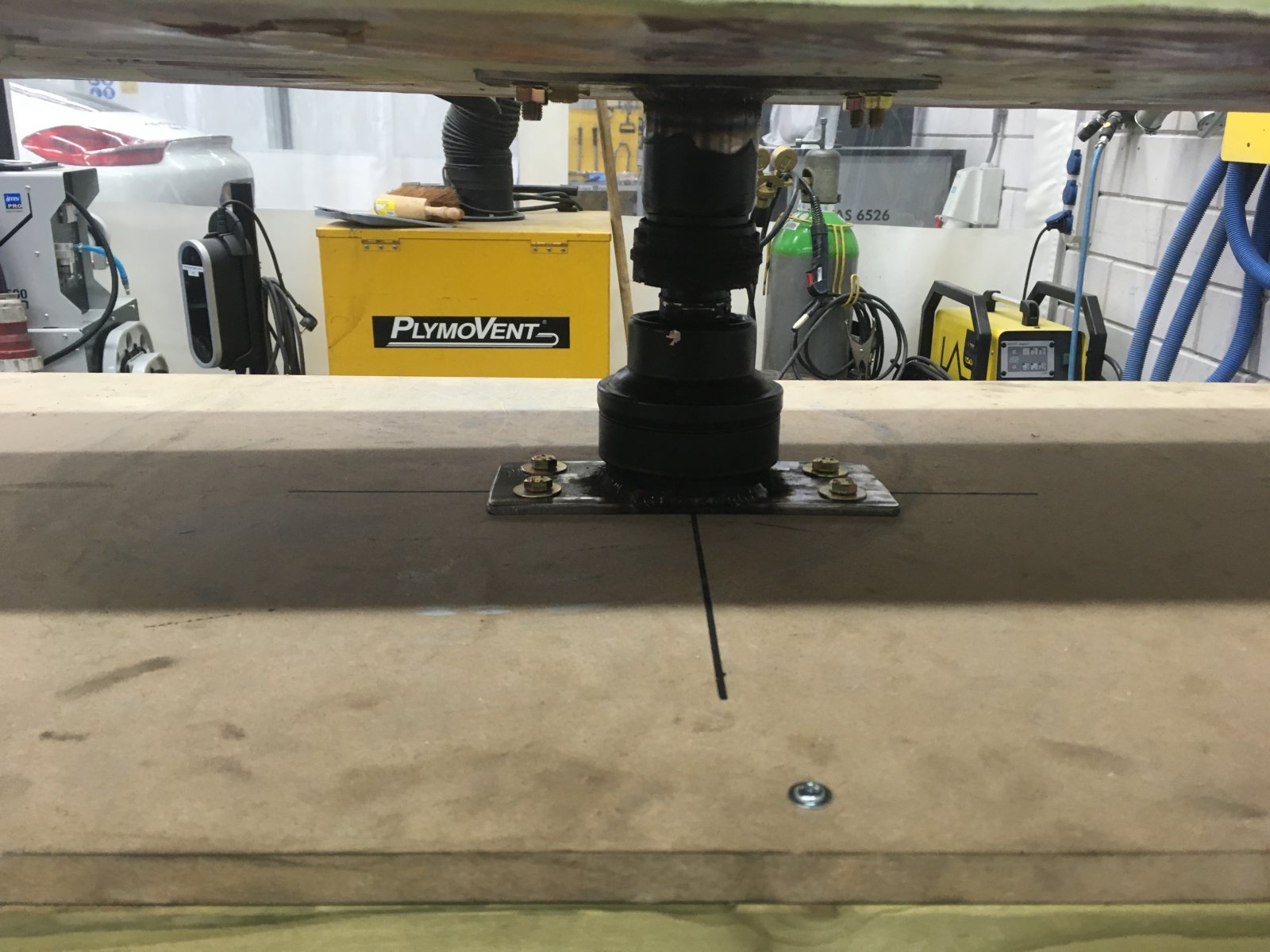

    hi guys,
    I normally play Project Cars2 on my ps4.
    I am trying to build a motion seat with my colleague
    We are now testing a bit and collecting stuff for a 2 dof motion seat.
    We want to try this first if this will work.

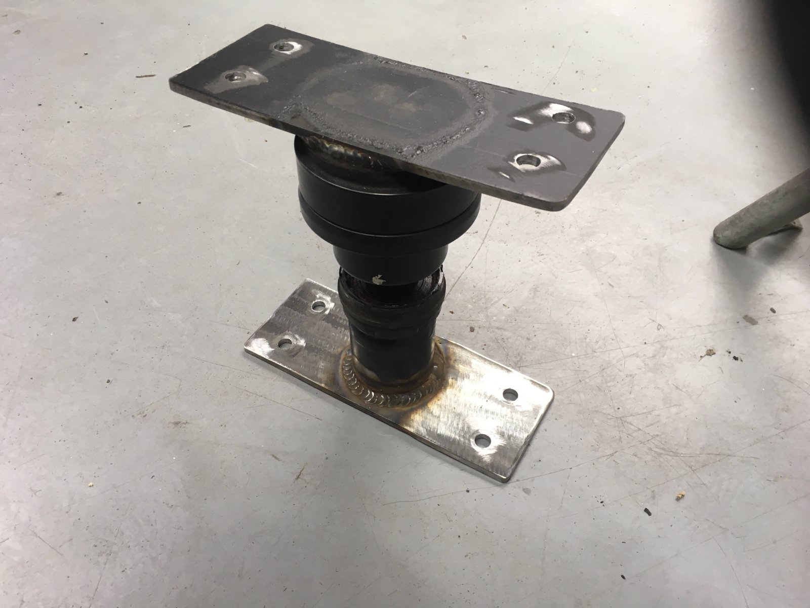

    Wooden base:
    Universal joint (porsche shaft)
    Base and top
    2 wiper engine
    These are all parts that we had around.

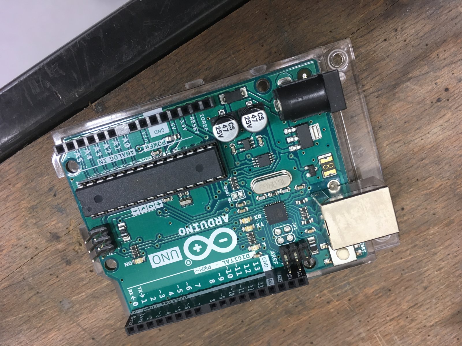

    Today I ordered the arddiuno uno.
    So somewhere this week we start with connecting the wires.
    Keep you informed ;)

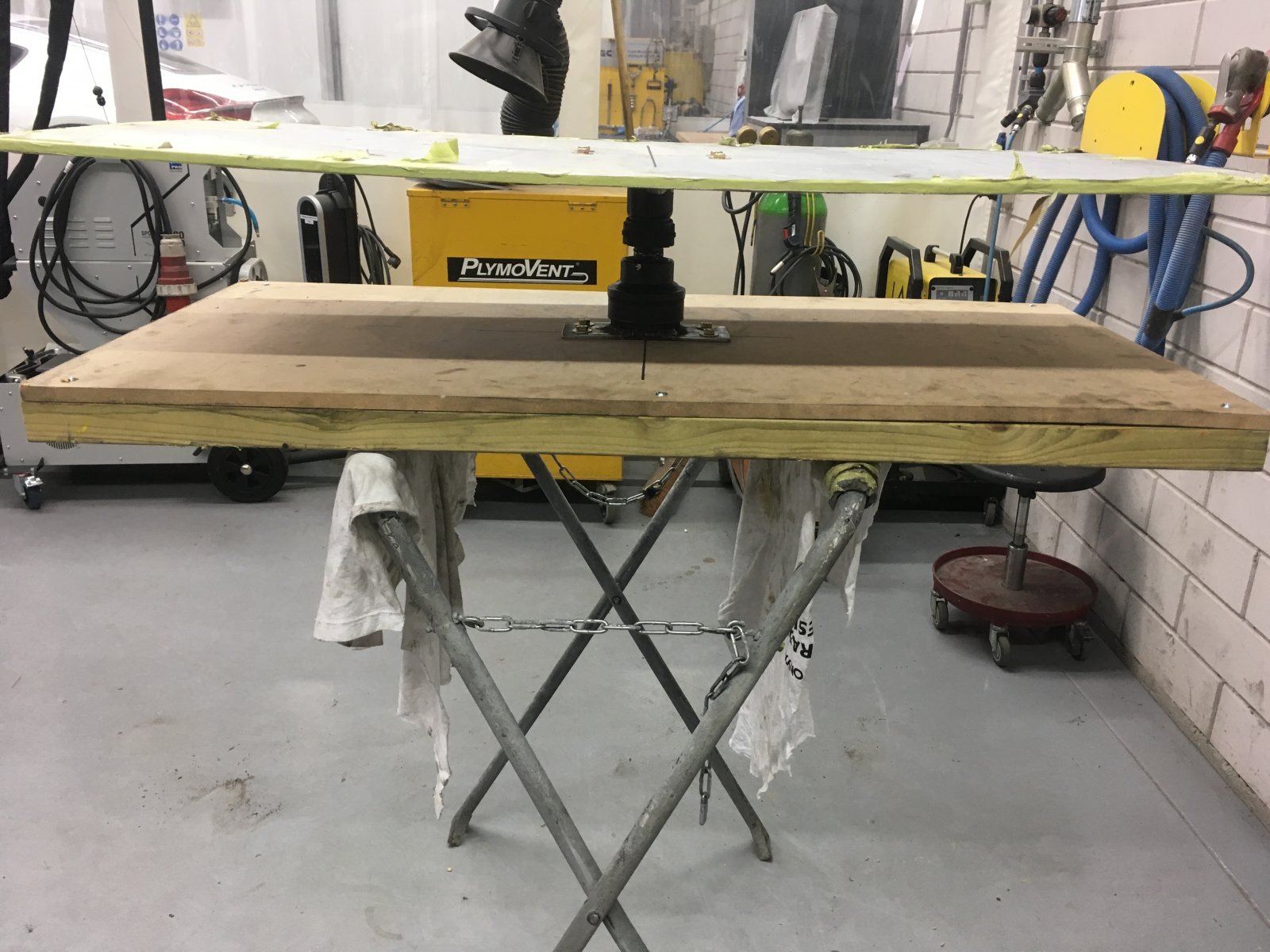

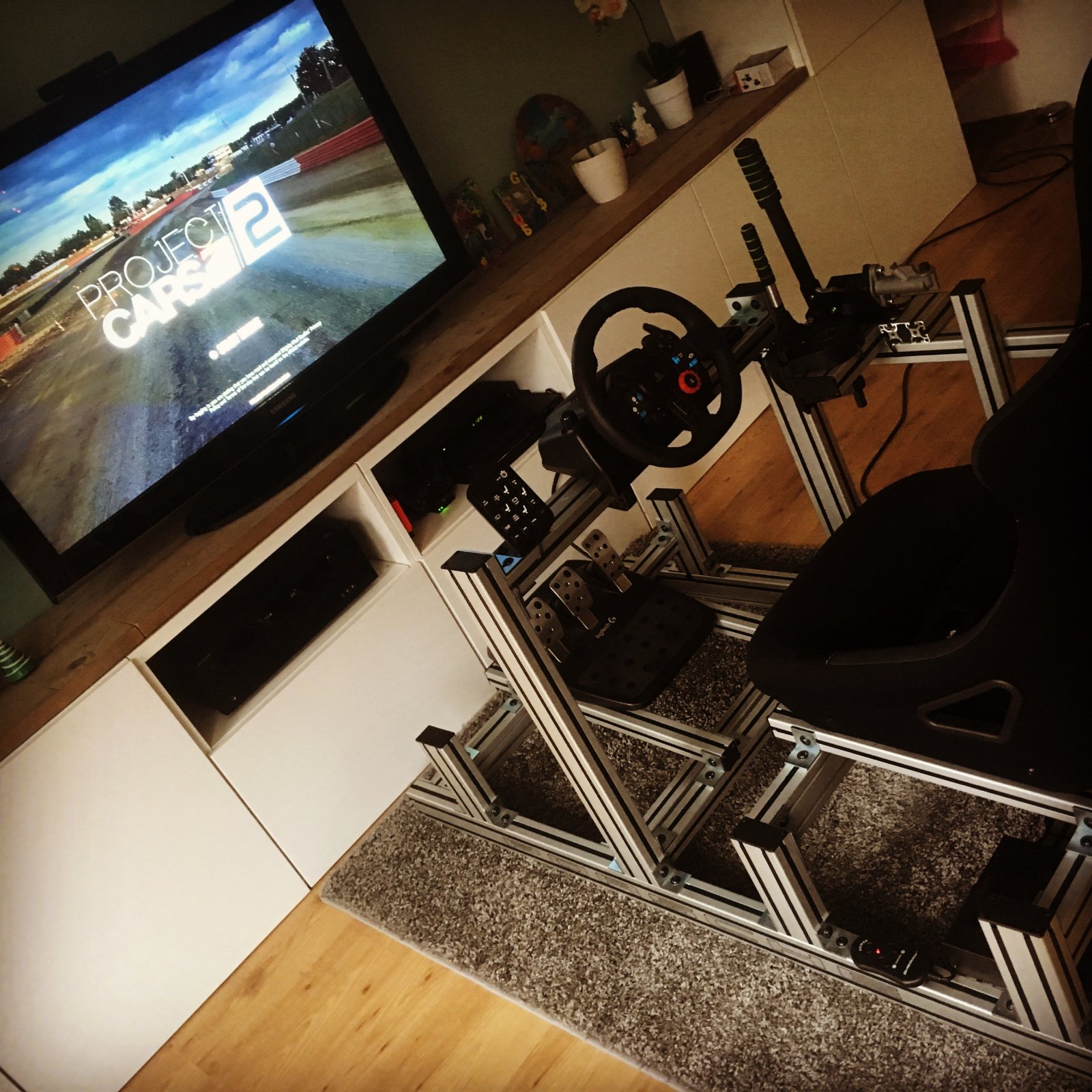

    This is my rig how i got it now.

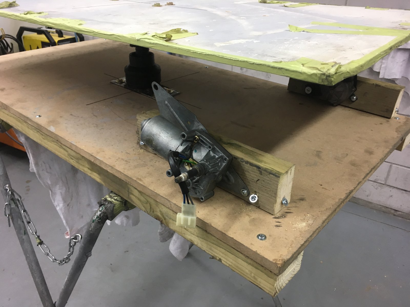

    got some new parts in today.
    the wires will arrive tomorrow.
    then we can start connecting this weekend

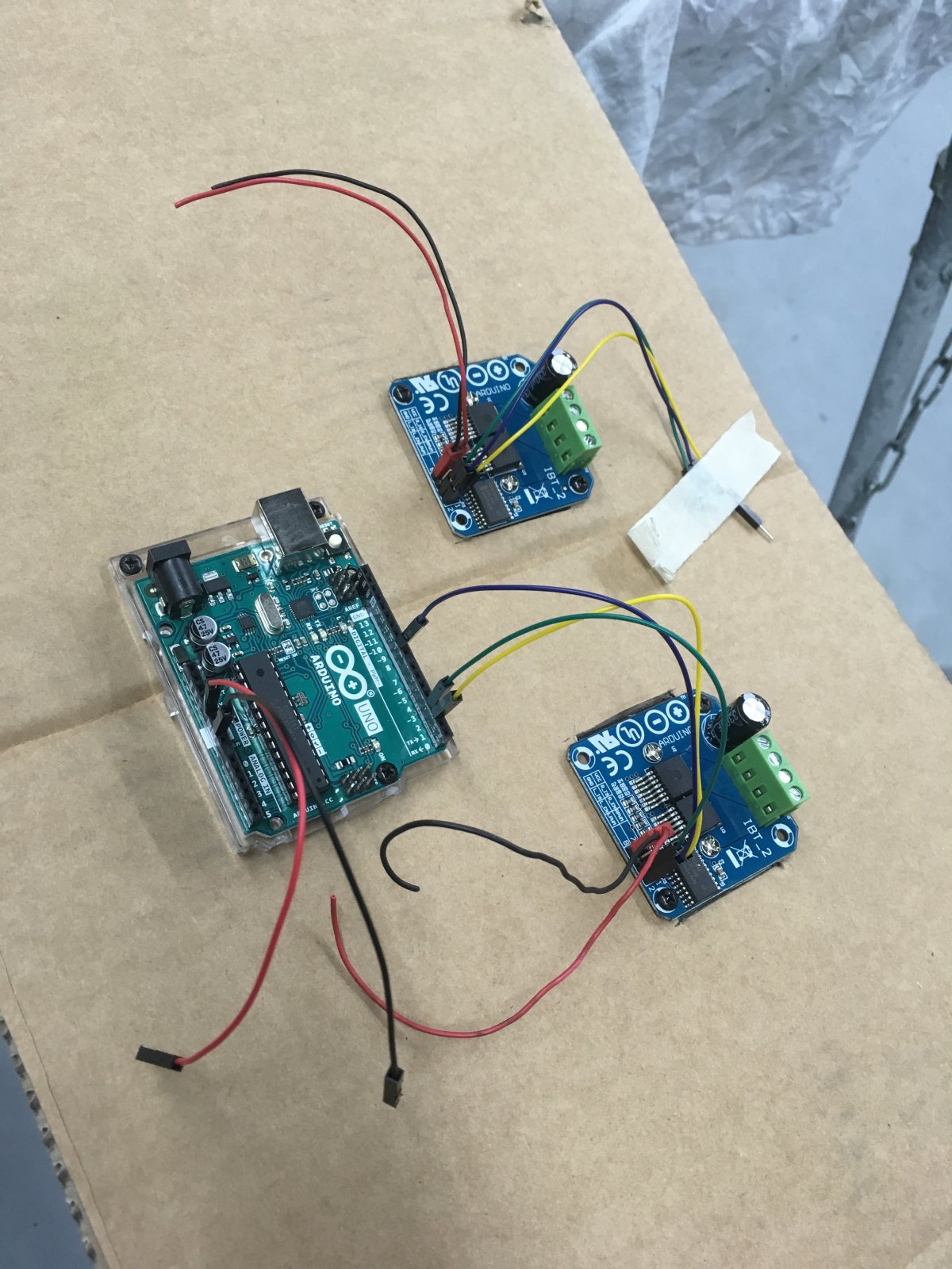

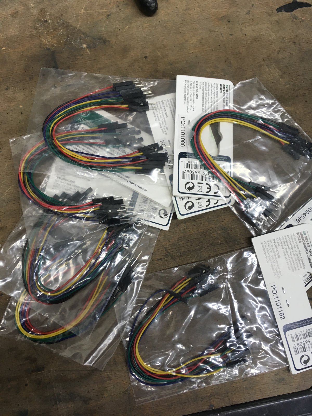

    Got Some wires today.
    And start conect Some.
    Work in progres.

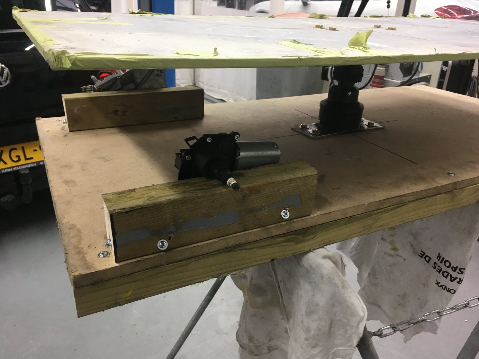

    Made this for testing

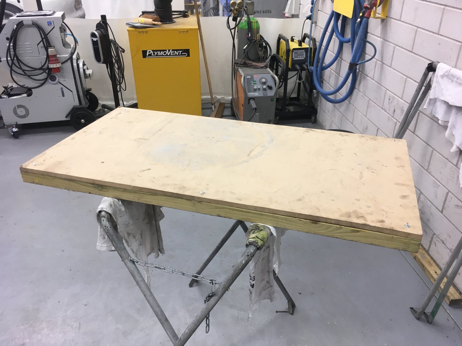

    I would like to test Now with Servos motors. In sim tools.
    where can I get the good code for ardiuino? And a preset for sim tools ?

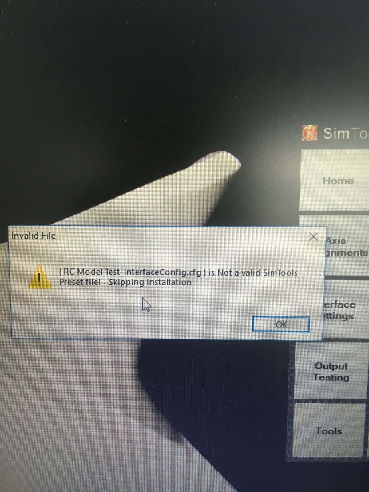

    If I want to upload the .cfg file to game engine I get this message:
    20,570
    145,292Coins
    +10,784 / 52 / -2
    That cfg was written for the old SimTopols 1.3 and has not been updated for SimTols 2, so manually configure: interface setup - IMPORTANT - The rest of the settings are in the following link but assuming a 2DOF for SimTools 2 the Interface Output should be set like this R<Axis1a>~L<Axis2a>~ https://www.xsimulator.net/community/attachments/rcsettings-jpg.48565/
