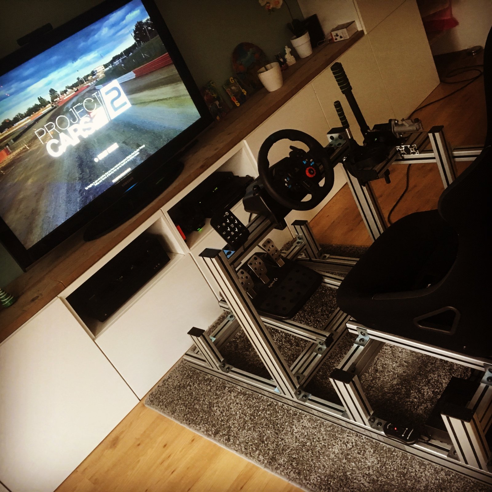

first project full frame 2 dof

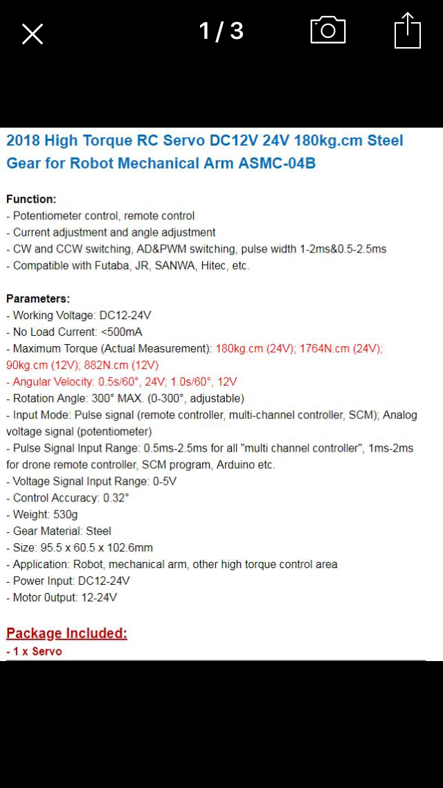

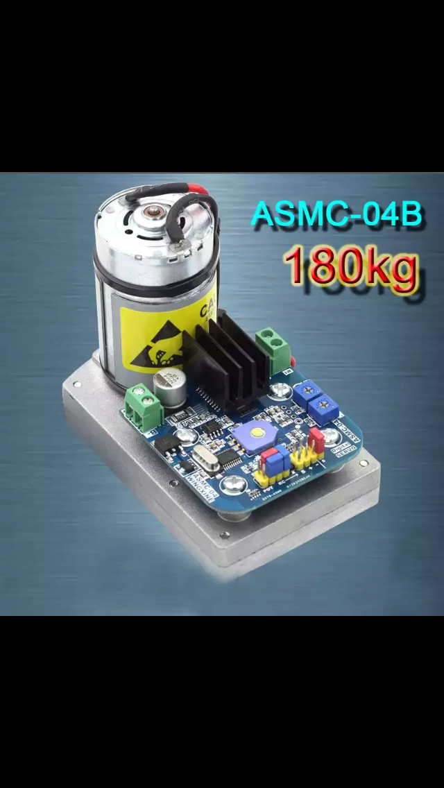

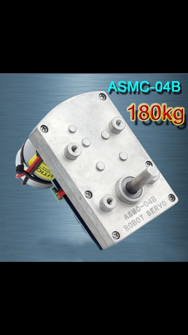

    B05A7AAE-1CBD-4D3D-B4FB-BFBADA9497E2.png EC91ECBC-D2D7-4168-81A7-B64BEF2CD0D4.png 998F08A5-1A26-48B9-9B84-AAB92839D1AF.png
    I found it on alieexpress. could I use this? instead of windshield wiper motors.

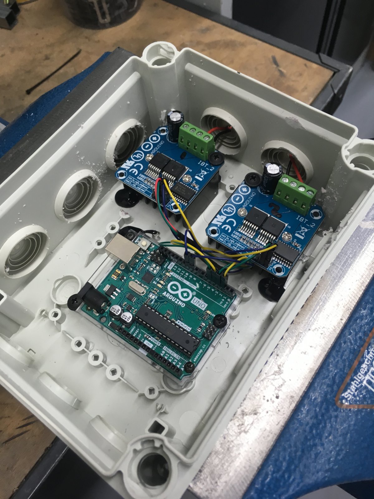

    first step with the wiring.

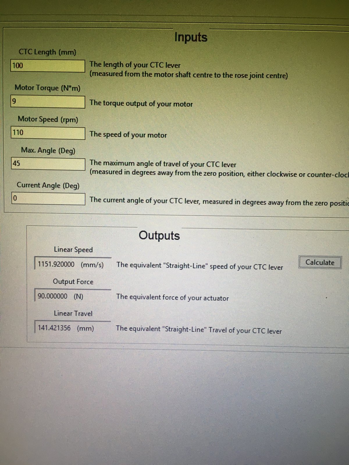

    Hi Guys.
    I am working on simcalc.
    is this calculation correct?
    1151.920000 mm/s ??

    Nobody can tell me if this is ok ??
  19. noorbeast
    21,665
    151,644Coins
    +11,044 / 56 / -2
    The CTC is too large and the Torque of the motor very low to drive most designs.
