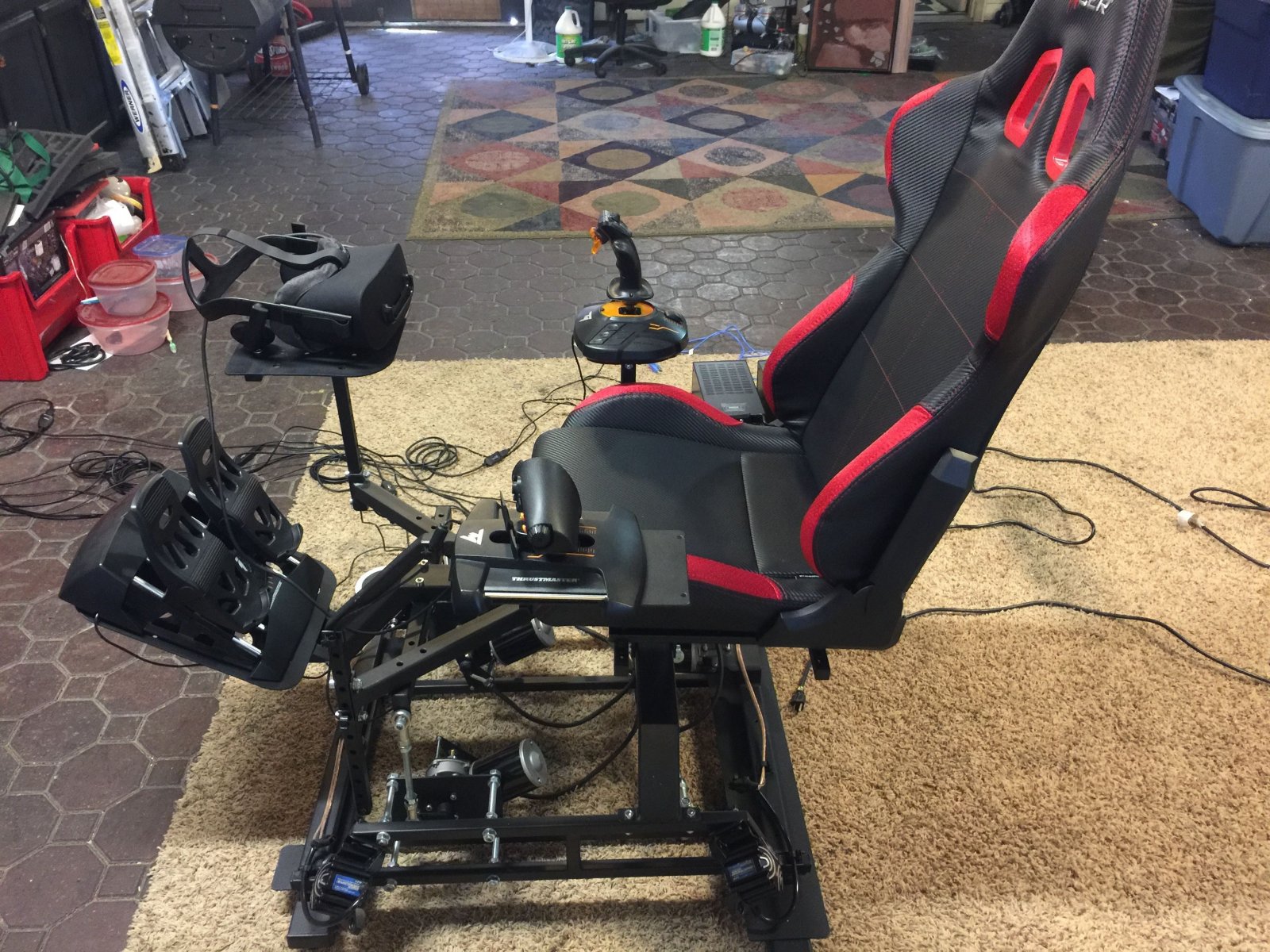

    Just my experience on basically completing a 2 dof full-frame motion sim for VR...
    You don’t need a lot of movement to really add to the experience in VR. It’s maybe more important to get good fidelity so the motion cues you get accurately match what you are seeing. I’m running with around +/- 10 degrees on the roll axis and around -5/+10 on pitch but haven’t measured. Those are guesses. For me, though, it’s plenty. Low angle displacements/movements also work better for VR without motion cancellation which appears to be problematic with the Rift right now.
    Though I haven’t tried a seat mover myself, the general thoughts here are seat movers are great for driving and even add some extra sensations due to the seat moving while controls are stationary. Driving needs much more fidelity and faster response than flying because you want bumps and curbs to happen as you see them and with no lag. Full frame sims have more mass, are larger, and necessarily respond a bit slower but are more appropriate for flying. But in all cases, the lighter your rig within strength requirements, the better. You want the rig to follow the commanded positions accurately. I am not sure about threaded pipe. You’d need to pin connections and you would need couplings or slip connections to build closed loops.
    As to 2 vs 3 dof, I was really amazed at how much I could feel "yaw" and "sway" on a 2 dof in VR. Only my opinion but I don’t miss the extra mechanical axis. On the other hand, now that I’ve built a 2, I am going to start working out a compact six. Compact thanks to VR seeming to not really need big motions. Should make it a lot easier to build, smaller, and cheaper. But I wouldn’t have had the confidence to even attempt it without the background of building my own 2 dof.
    Other than that, definitely a huge fan of bass shakers. They aren’t a dof but they add so much to feel the vibrations and bumps. Another thing that adds so much to the experience is wind. It also makes VR much more comfortable. You can scale the effect so it’s appropriate even for closed cockpit sims as in vent ram air flows, or run at full speed and depending on your blowers and setup, get up to 60 to 70 mph wind. You need Pro level SimTools for wind and not sure but I think for the upcoming Game Vibe application.
    Depending on what way you choose to go, you may find a 3D printer is handy. For me it’s been essential but I have done things differently for various parts of my rig and needed lots of custom parts. It kind of mushroomed because once I didn’t need to design around what I could piece together through other means, I could purpose build all sorts of parts to do and be exactly what I wanted.
    Last, something I just learned, for flight setups in SimTools, don’t even bother with the basic axis setups. You need the ones with filters because there is a return to center function. Without that, your platform can get confused and lean one way or another after various maneuvers. Anything where you can loop or roll or that tends to have the possibility for different motion rates in and out of maneuvers probably needs the filter stuff. I’m thinking of even going back and reworking my driving setups to have that.
    There’s lots to come up to speed with but it’s so worth it when you get movement working especially in VR. It sounds like you’ve done a lot of homework already so hopefully this screed helps. Motion is very worth the cost and effort, though. It’s just bizarre how it feels.
    Good luck!

    @Zed
    Thanks for your advice here. I was leaning towards a 2dof compact frame build, and you have me convinced that is the right decision. Since I am going to follow @noorbeast's example and bold the thing together, I feel like I can take it apart and add another DOF if I feel it is necessary. I am trying to design the frame with that in mind.
    I'm interested in this statement:
    Does your sim sub small amounts of roll for sway/yaw, or what sort of movement does it make?
    Since my primary use case is going to be space sims, I have been trying to think of ways I can 'sub' some sort of haptic (or other) feedback for a DOF. For example, an idea I had was to mount bass shakers on the left and right side of the chair, and if I am strafing left, that would engage the shaker on the right side of the chair.. basicially mimicking the rumble of engaging the thrusters located on that side of the boat. I could mount a shakers to simulate heave and surge as well, though I think that gets more tricky and expensive (I think that ends up being what, 6 shaker? I probably would go the DIY route rather than buying buttkickers at that point).
    For a third DOF I think that I am more interested in surge than yaw at this point. Mostly for the sensation of engaging boosters or afterburner and being rushed forward/thrown toward the back of your seat. I have seen some GSeat builds, and that is interesting, though most of them look uncomfortable. I was really impressed with the hidden g-seat that @Spit40 made. I really, really like that design.. and maybe after getting a 2dof under my belt I might think about taking apart my chair to do something similar.
    Also, I just picked up a 3d printer and have enjoyed playing with it. Mostly I've printed out little models and a detent mod for my throttle. What sort of custom parts did you need to print out?

    All it can do for yaw/traction loss is roll, and sway is also roll but in the opposite direction. It’s really weird but it still feels like yaw and sway when you have the VR visual cues.
    As to stuff I’ve printed, in the photos here (https://www.xsimulator.net/communit...-build-a-3d-printer-has-been-essential.10642/) all the red is 3D printed. Lots of other stuff too. Joystick mount and extension pieces, electronics boxes, power entry modules, trim pieces, mounts, standoffs, etc.
    Others can comment but things seem to work best when you let the software just do its thing. I had sway backwards early on and it just felt weird. Noorbeast mentioned it’s reversed from roll and things got way better. If you wire your shakers in reversed, they’ll always be reversed unless you add a switch to swap and unswap. But it’s also a personal preference thing. You can set things up however you want. The software is just interpreting accelerations and commanding motors per your setups.
