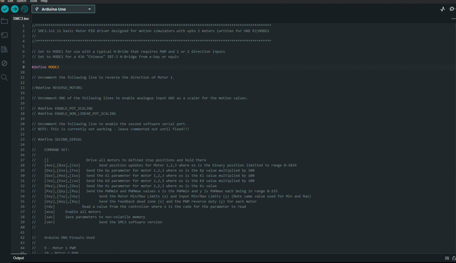

    Hey,
    I have some issues with my first Sim Rig projekt.
    my Setup:
    2x 24V Wheelchair Motors 250W 75rpm
    2x IBT_2 BTS7960 43A Dual H-Bridge
    1x Arduino Uno
    1x 800Watt 24VDC Powwer Supply
    I have done the wiring and and have load the sketch to the Arduino.
    My issue is that both motors are only spining in one direction. I have tested several settings in the SMC3 Tool and always the same results only one direction. I had checked the wiring three times.
    Pherhaps the mode in the Arduino is "MODE2".
    Maybe the IBT_2´s are brocken but both?
    Any Ideas what going on here?
    Thx and Regards
    Bjoern

    If i swap the cables at Rpwm and Lpwm at the motor controllers should the motor spin in the other direction?
    Because nothing happens if i do this.
    21,597
    151,245Coins
    Try testing the IBT2s with a multi-meter, to see if they work as expected.
    If so please set Fpwm to 25 and do the calibration sequence from scratch, then post the result, including the value of PWMmax when the motor begins to move:

    Yes, the ibt_2 are working only in one direction. When they had do reverse i messure 0Volts at the Motor pins.
    I also messured the PWM pins, there it seems all is fine. The voltage increase when i spin the pot away from center and decrease when i spin it to the center position. This works in both directions.
    I guess the IBT_2 are defect, but i am perplexed that both are defect.
    Have u got an explanation about this:
    Also when i set KP to 0 i can spin the motor, whats is wrong here?

    A number of members have reported faulty IBT2s, so manufacturing standards could be an issue, as they are built to a price.

    The twoIBT´s are broken, i changed them and everything works.
