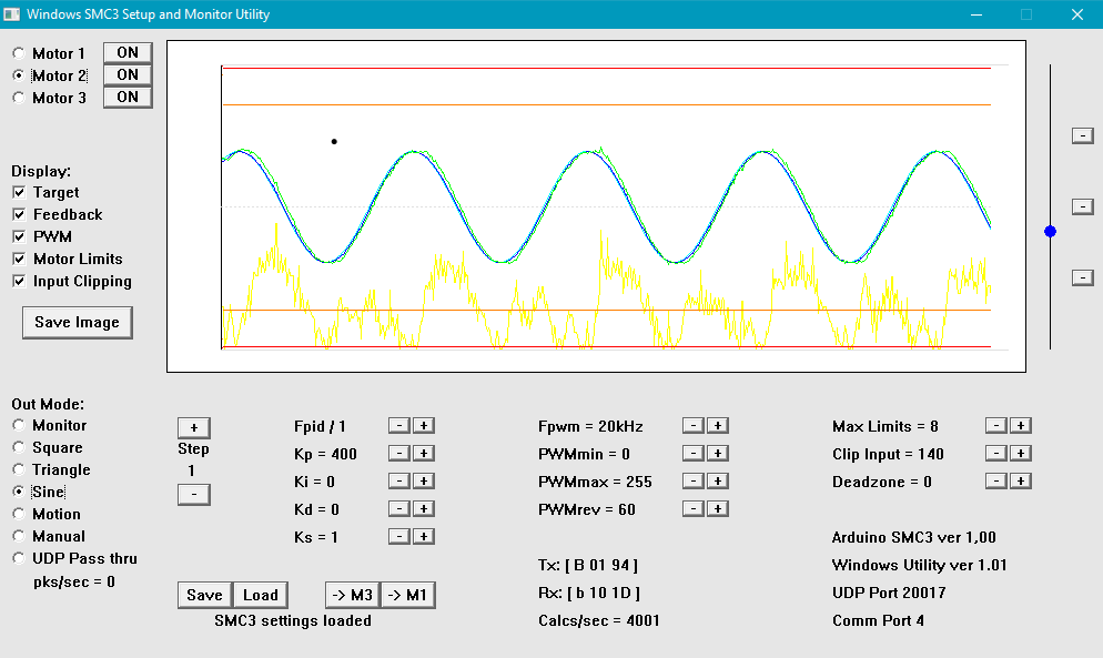

    my SMC Settings look like this:

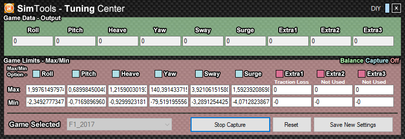

    TC Settings after first capture:
    Hope you can bring some light into the darknes…
    thanks Martin
    22,185
    154,750Coins
    +11,196 / 57 / -2
    The TC values for roll, pitch and sway look too low and generally speaking the Min and Max do not need to be different. So rerun Capture with the Option set Green. Higher values for roll, pitch and sway will settle the twitching, again do one axis/force at a time.

  7. Martin.Berger
    Martin.Berger Member
    May 6, 2014
    73
    216Coins
    So after some more tests where I set surge to green and to 50/50, I noticed the same strange behaviour Like Game Data are changing crazy, axis are jumping arround wild.

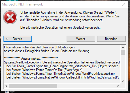

    Hi.
    There is something new occured:
    Hope someone can help (maybe Value1 or Noorbeast)
    Thank you
    22,185
    154,750Coins
    +11,196 / 57 / -2
    Can you please change the computer language settings to English local, just to rule out this known issue that only affects some machines: https://www.xsimulator.net/community/faq/simtools-language-setting-bug-change-to-english-local.233/
    Then re-post the full error message.
    Do you have anti-virus running? Some of them interfere as a false positive because SimTools needs to memory map to get the data it needs from games. Try temporarily disabling it and test.
    .NET can also be corrupted. You can reinstall or try the repair tool: https://www.microsoft.com/en-us/download/details.aspx?id=30135

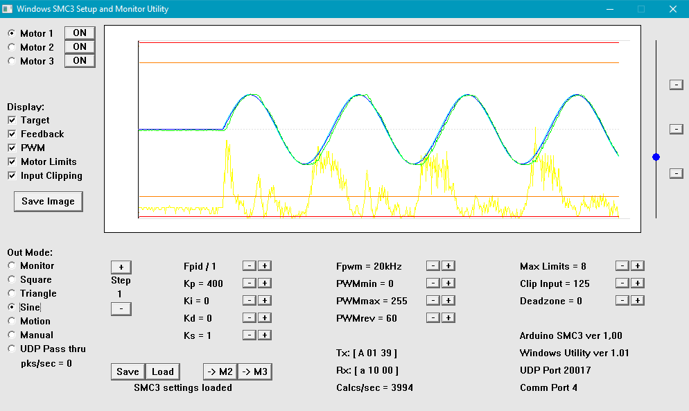

    in SMCUtil everything works thine each Motor.
    In Simtools just the right Motor moves since last testing.

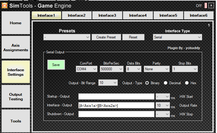

    Silly question: Should I configur both axis 1a and 1b for 2DOF?

    Your Interface settings should be [A<Axis1a>][B<Axis2a>] for a 2DOF.

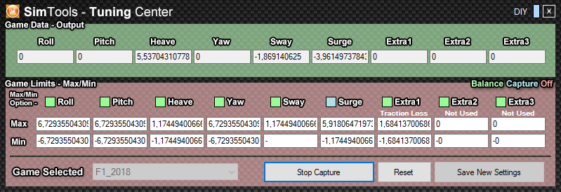

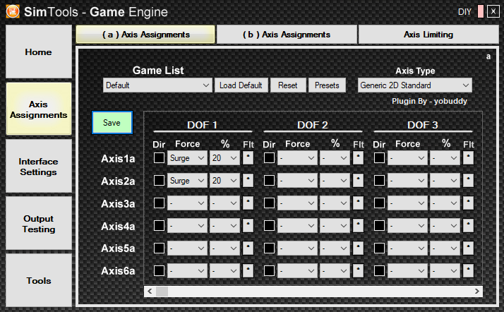

    my interface settings are:
    Axis assignments (for setting up a motion-profile just surge):
    Tuningcenter values:
    Strange things happen again. Now in 2018 with actual plugin and SimTools v2.3
    Motors just move when they want. it doesen´t make any sense when they move. just very short moves without any "connection" to the game. Most of the time GameData shows 0 then suddenly some values flicker up (i.e. heave 0,123647382)?!

  19. noorbeast
    22,185
    154,750Coins
    +11,196 / 57 / -2
    You have only given a picture of the Default Axis Assignments, we need to see the game Axis Assignments.
    And I would not recommend Codemaster Games for initial testing, as they can have complicating factors. Use Live For Speed for initial testing and make sue you run LFS first before patching, as that generates some necessary files.
    You also need to make sure the computer is set to English Local: https://www.xsimulator.net/community/faq/simtools-language-setting-bug-change-to-english-local.233/
