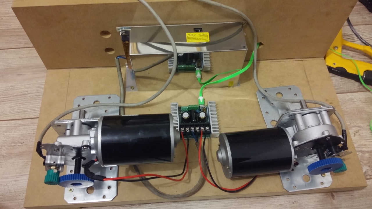

    I installed the sabertooth, the files for the PID
    And the arduino is installed, the first configuration files are uploaded (successfully) the sabertooth libraries for the arduino have been installed too.
    I have everything that worked, and I tested on the new PC LFS and simtools, it worked ... HOURRA

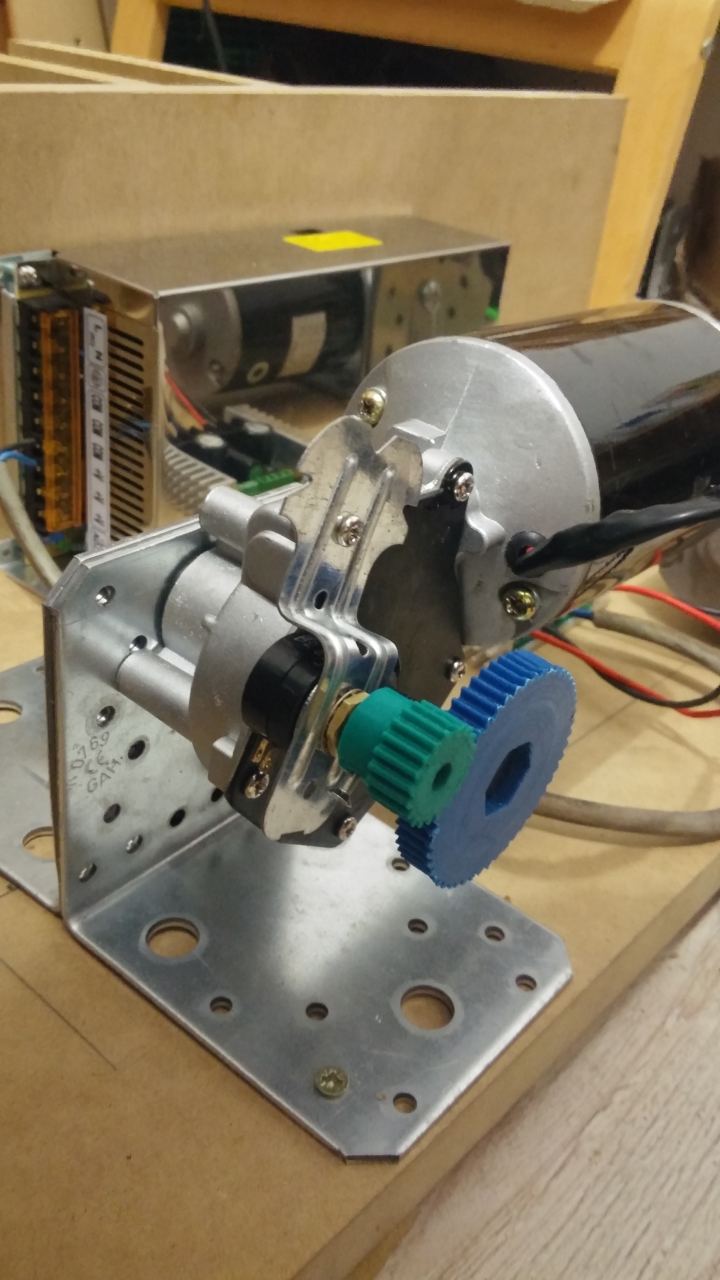

    I received this afternoon my new soldering iron (the old one to grilled !!) so I would attack Monday (I work this WE) the cabling and the fixation of the arduino, the sabertooth towards the engines and the Potentiometer wiring.
    I am currently thinking of fixing the potentiometers on the motors.
    I should receive my cranks (machined by a friend) at the beginning of the week.

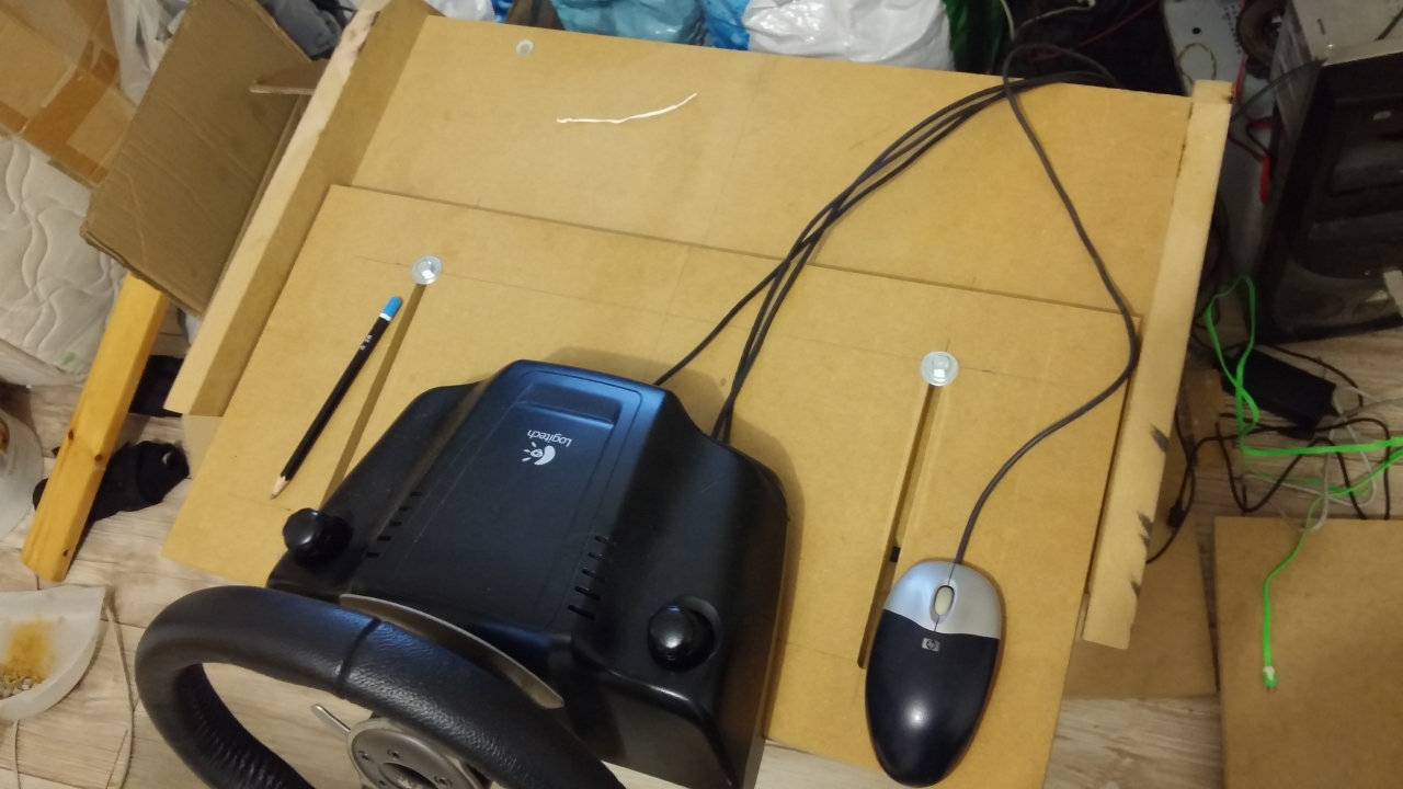

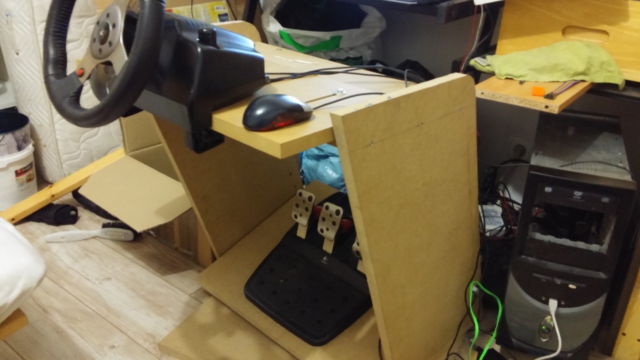

    I have "finished" my support flying and pedal before ...[​IMG]

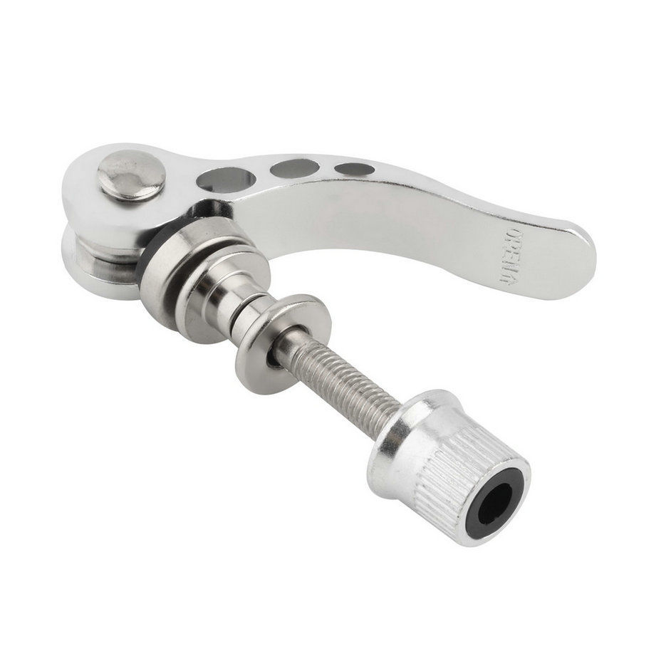

    The adjustment of the steering wheel (I would find two butterfly nuts to facilitate the tightening)
  4. Nick Moxley
    17,056Coins
    +2,506 / 30 / -2
  5. obobo
    obobo Active Member
    Nov 8, 2016
    248
    1,323Coins
    +77 / 1 / -0
    Actually, I had not thought of a quick bike clamp
    Good in the immediate, it works like this, I would wait to decide the color of the simu to order the quick clamps.
    Thank you for the idea:thumbs
  6. Nick Moxley
    17,056Coins
    +2,506 / 30 / -2
    I hid my clamps on the underside of the wheel deck. Nice and stealthy.

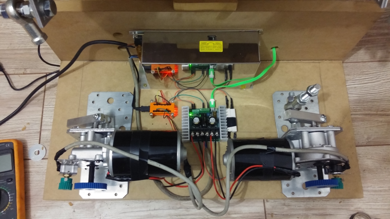

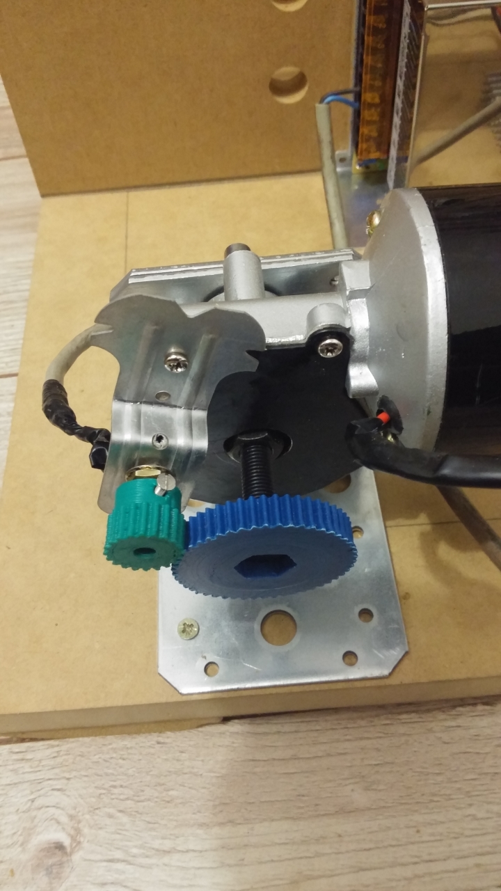

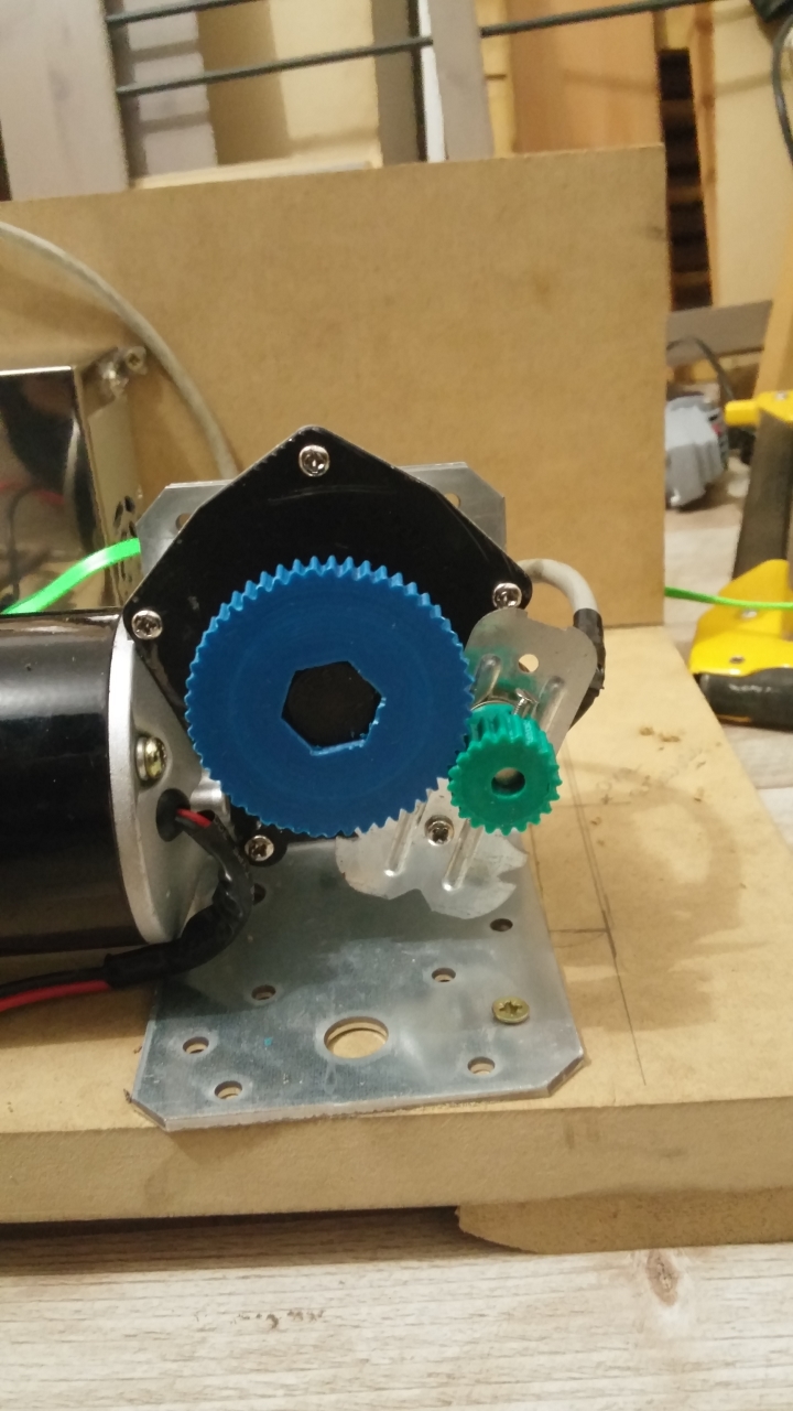

    I had a little time yesterday to tinker
    I manufactured the potentiometer brackets and I welded the wiring too (I received my new soldering iron :thumbs)
    I powered the engines temporarily to see if it turns well and yes it turns :grin
    Some quick photos
    And finally a view (temporary for now) of the electrical part of the simu !!
    The engines are still not fixed definitively on the base because I had to make a modification on the plate and I want to check that it does not change my axis for my links
  8. dedraro
    dedraro Active Member
    May 1, 2015
    104
    105Coins
    +65 / 0 / -0
    Hi, I have the same motors, I like how you have mounted the bracket for potentiometers, I wonder if with a single screw does not move when in motion, the bracket is sufficiently strong?
  9. obobo
    obobo Active Member
    Nov 8, 2016
    248
    1,323Coins
    +77 / 1 / -0
    It is relatively solid, but as a precaution, I would put a spring
    Between the screw and the end of the potentiometer holder
    For the moment, I did tests (just feeding), and it does not move

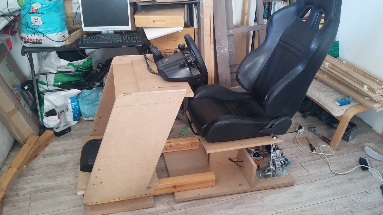

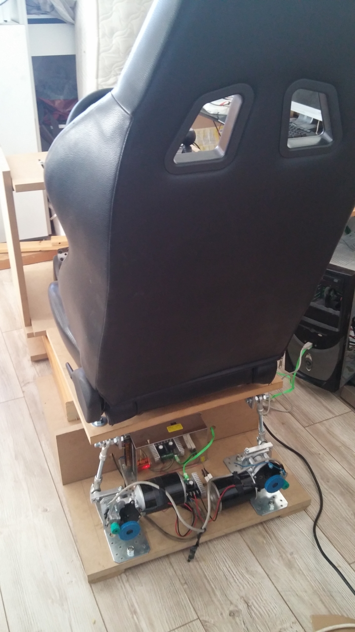

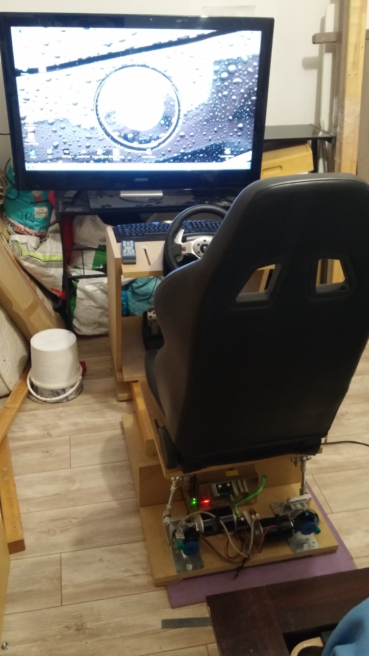

    The simulator is finished !!
    he works
    All is not perfect but I will work there to solve all this
    I put some pictures
    I have only tested with LFS for the moment
    I had quite a few worries to correctly adjust the motors and operation with Simtools
    In LFS, as soon as the race is displayed, the simu tilts backwards instead of staying horizontal. So I play rather inclined towards the rear, except when braking !!
  11. Tomsix
    Tomsix Member
    Dec 6, 2016
    84
    Németország
    324Coins
    +18 / 0 / -0
    Hi! In not sure but is that possible that the track is tilted? I have experienced some issues in LFS with the road telemetry with my RC-SERVO. This affected the Roll angle during drive, the seat follows the roads vertical angle.
  12. Tomsix
    Tomsix Member
    Dec 6, 2016
    84
    Németország
    324Coins
    +18 / 0 / -0
    Ehm not Roll axis * i mean Pitch angle.sorry

    good evening everyone
    After several days of galley to finish the assembly of the simulator and finish the installations of games, it is finished. Finally not painted nor anything like finishes but it does not matter.
    I had a mobile tabletop worry that turned to the left.
    Several games that did not work with simtools
    But after a lot of worries, I have all my games that work and there are only adjustments (it will not be simple, I am a big draw) so that the reactions of the simu are as realistic as possible.
    I thank all those who helped me and gave advice that prevented me from planting everything
