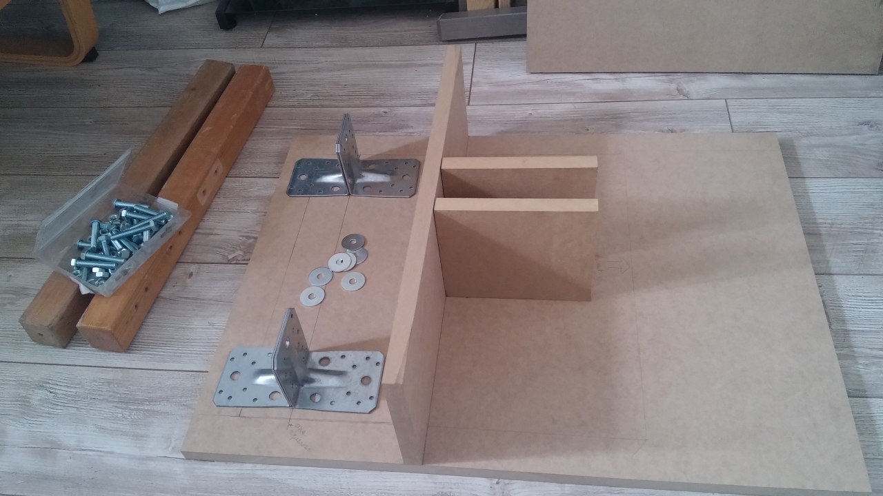

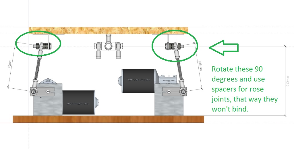

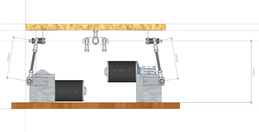

    I begin the construction of a dynamic simulator 2DOF in seat mover
    I started off a bit to understand the basics of building a simulator.
    But with help, I was able to start sketchup implementation of the simulator elements.
    Here are the first steps of creation

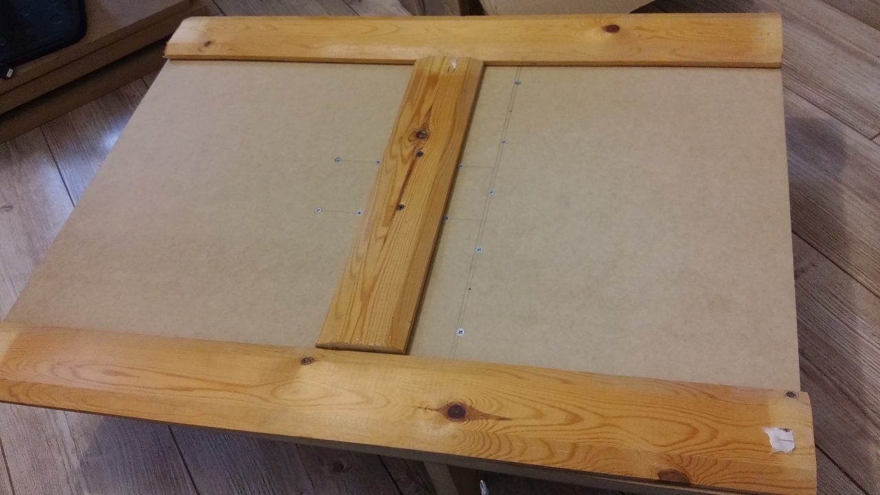

    I saw with my entourage to recover the maximum of materials and I ordered the rest on the site of Wanegain and Willaupuis: simukit

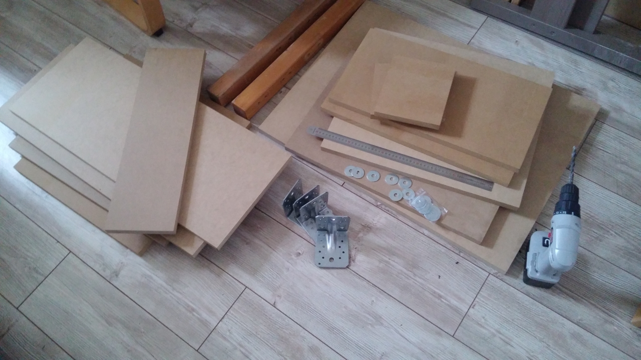

    I now expect to have everything in my hands to advance, even if I attacked the wooden base.

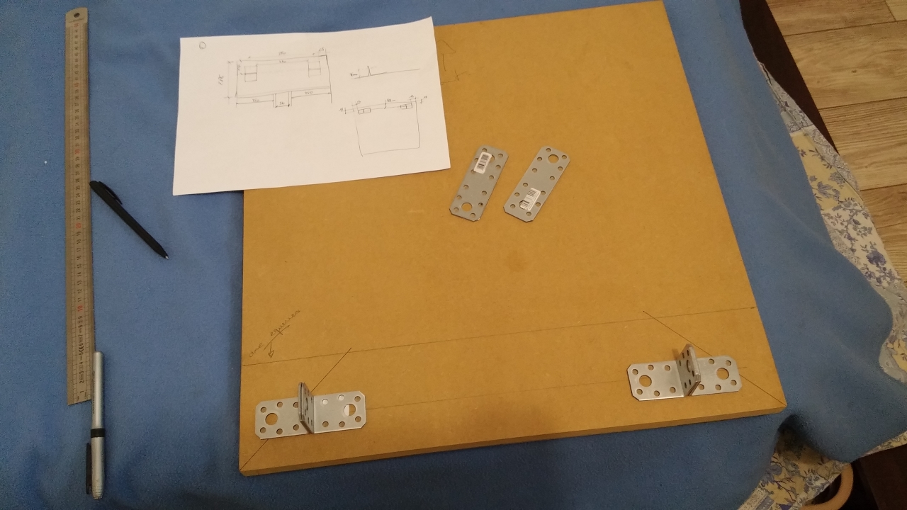

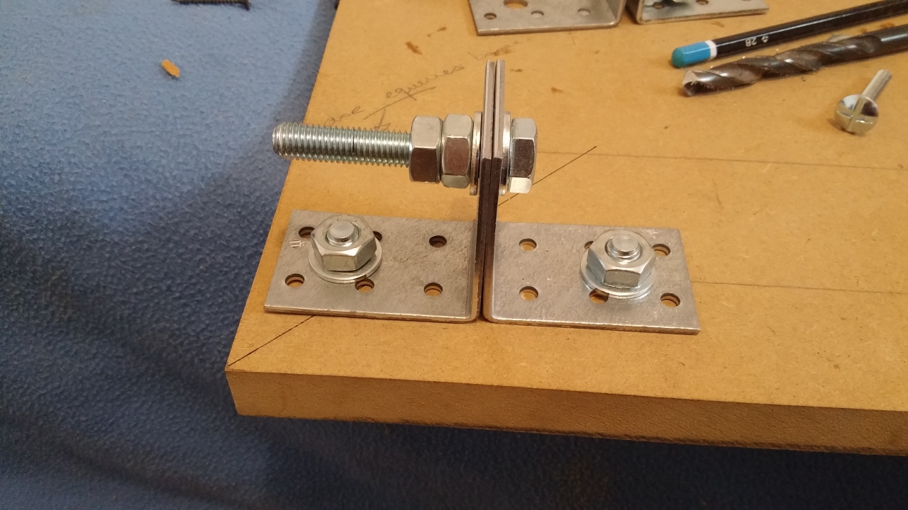

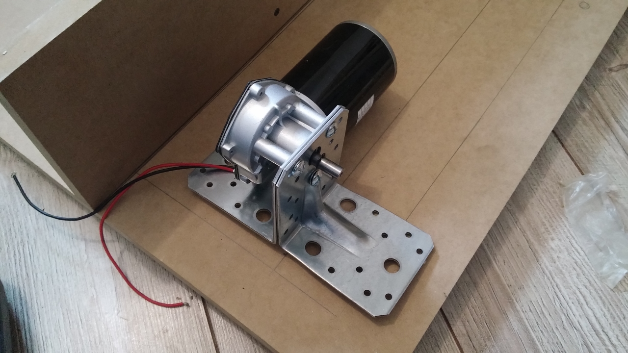

    I already have conical spacers made hands
    On the other hand I do not understand what can bring the fact of turning by 90 ° the support of the top.
    It may no longer be in line with the crank and the connecting rod
  4. Wanegain
    Wanegain Active Member
    Nov 6, 2013
    564
    Bruxelles
    1,997Coins
    +300 / 2 / -0
    He's true, it's better to have brackets and ball joints on the same side
  5. obobo
    obobo Active Member
    Nov 8, 2016
    248
    1,323Coins
    +77 / 1 / -0
    And I would be obliged to take back part of my structure to have the place to mount the supports.
    but if you can explain to me what it would be to win in this configuration ...
    21,494
    150,584Coins
    +11,017 / 55 / -2
    If you use a solid right angle bracket mounted 90 degrees from the one you have then the top rose joint can rotate freely as it is designed to do, as the lever and seat moves up and down.
    The way it is now there is a good chance of the rose joint binding as it has limited freedom to move when the top joint orientation is at right angles to the bottom joint.
  7. obobo
    obobo Active Member
    Nov 8, 2016
    248
    1,323Coins
    +77 / 1 / -0
    I see what you mean
    As soon as I attack the assembly of the connecting rods and supports, I would test in both directions.
    Thursday I go to my father and we will make the gimbals.

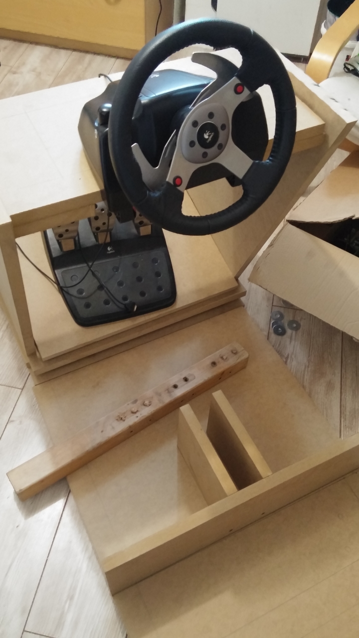

    +77 / 1 / -0

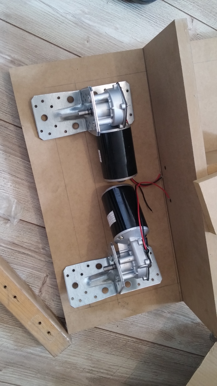

    under the Microsoft wheel, my G25 is in the bag :D

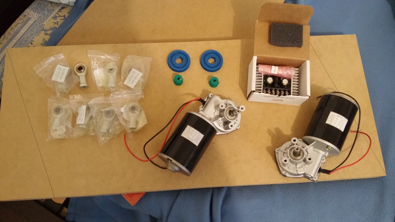

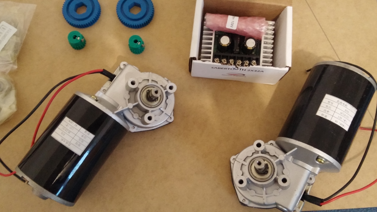

    Are those Bodine motors?
  11. obobo
    obobo Active Member
    Nov 8, 2016
    248
    1,323Coins
    +77 / 1 / -0
    24V DC motors 25Nm from simukit.com

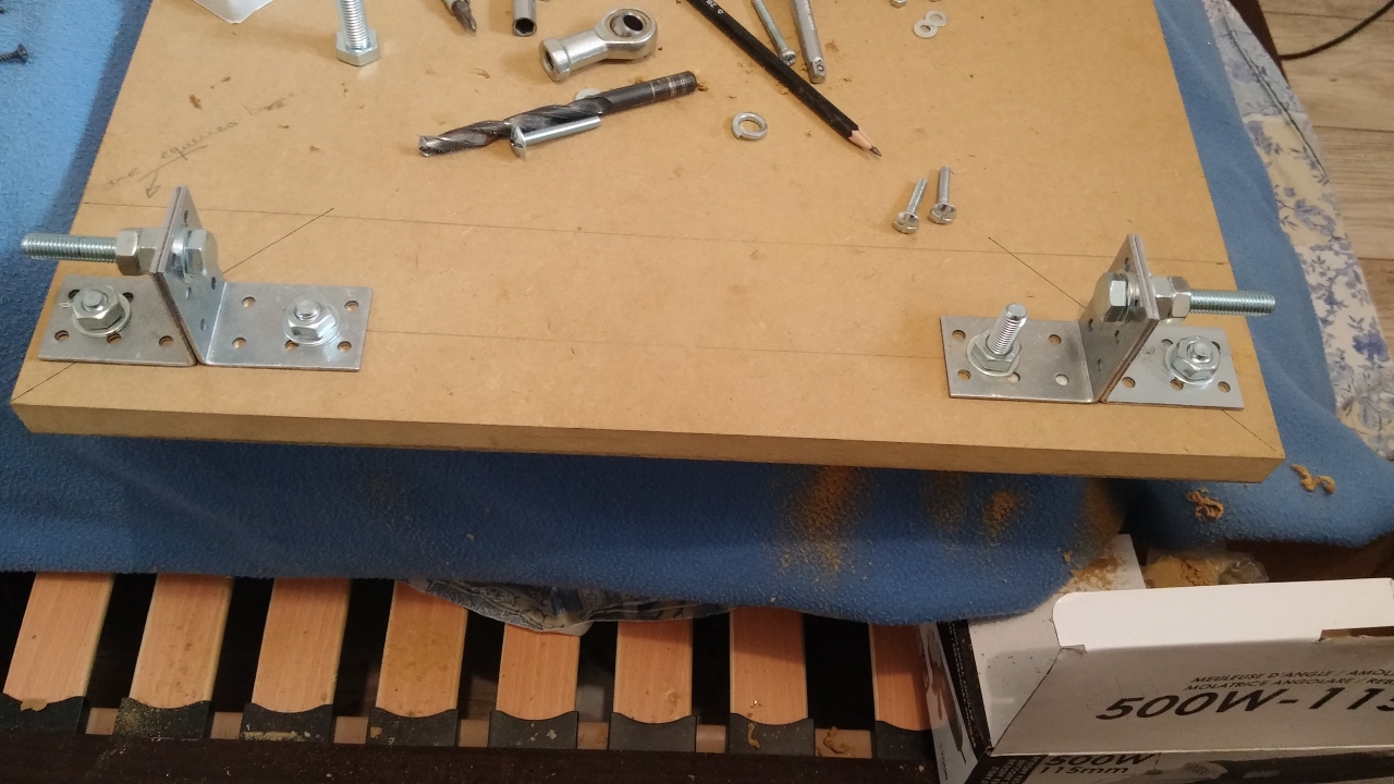

    following an error, I had to replace my squares of the top by longer ones
    I do my cardan this afternoon and so I could finally fix the mobile plate to the low structure.

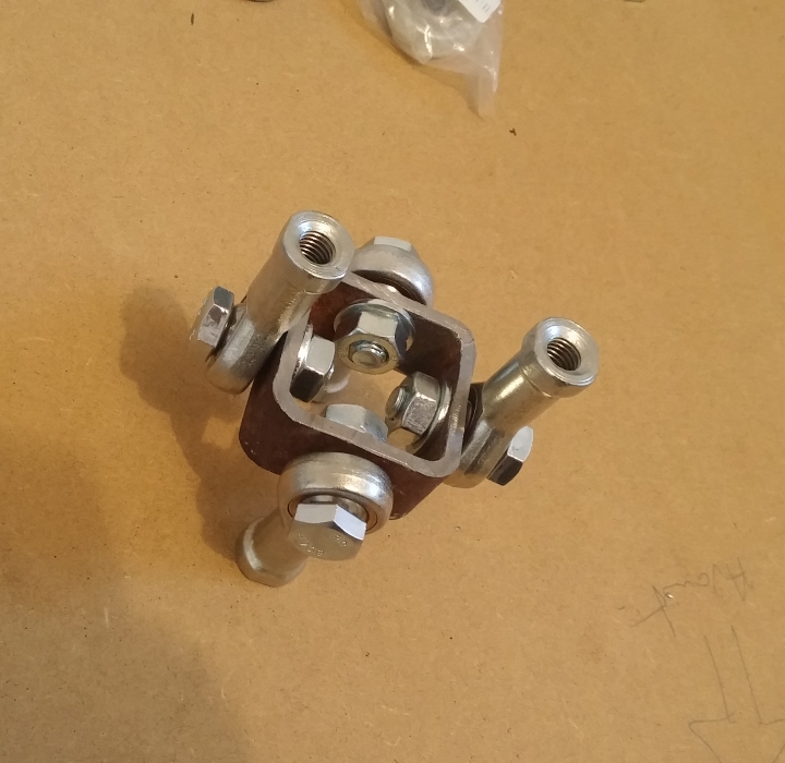

    This afternoon, cardan manufactured

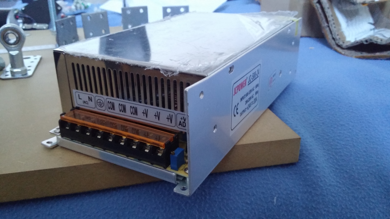

    Received power supply, I test the engines and sebertooth this weekend

    My ball rod joints are ordered from a hardware store near me
    I advanced a little the front part with choice of the pedal assembly !!
    Either as standard or by disassembling and returning it

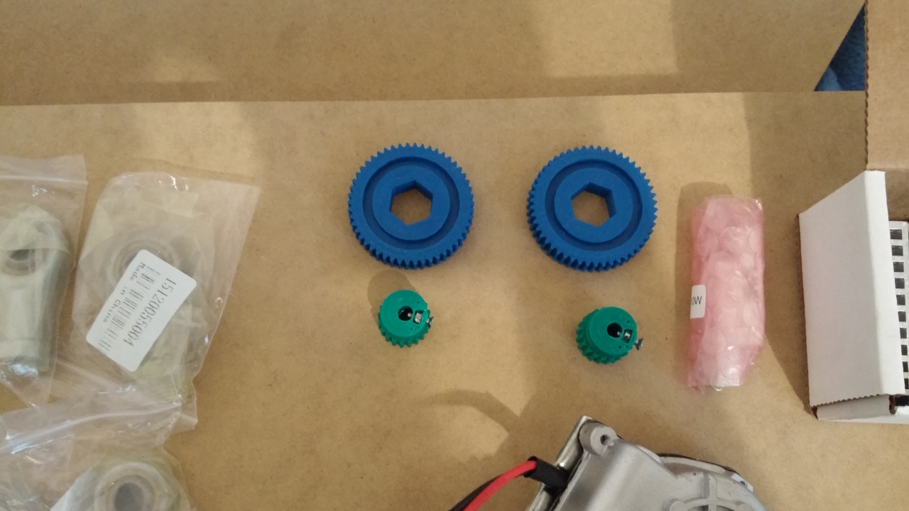

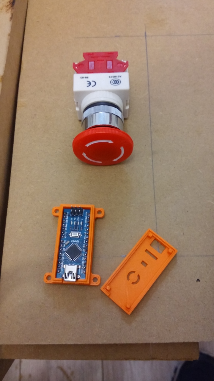

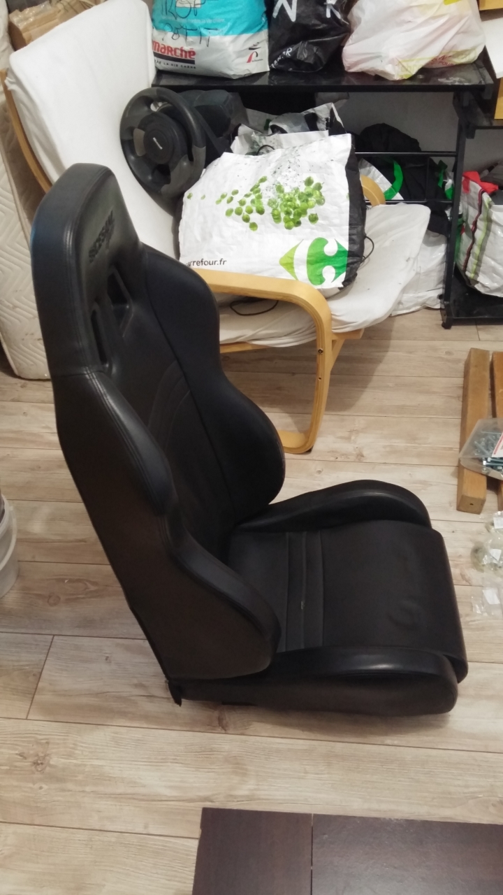

    I have these days worked a little on the simulator:
    2016-11-24 14.17.08.jpg Reception of some items ordered on the net or recovered by my brother. 2016-11-24 14.04.17.jpg 2016-11-24 14.27.05.jpg 2016-11-24 14.29.06.jpg 2016-11-24 14.29.18.jpg
    I almost finished the front part of the simulator
    It remains for me to make my grooves so that the steering wheel is adjustable
    And fix my pedals (I hesitate to disassemble it to reverse the pedals)

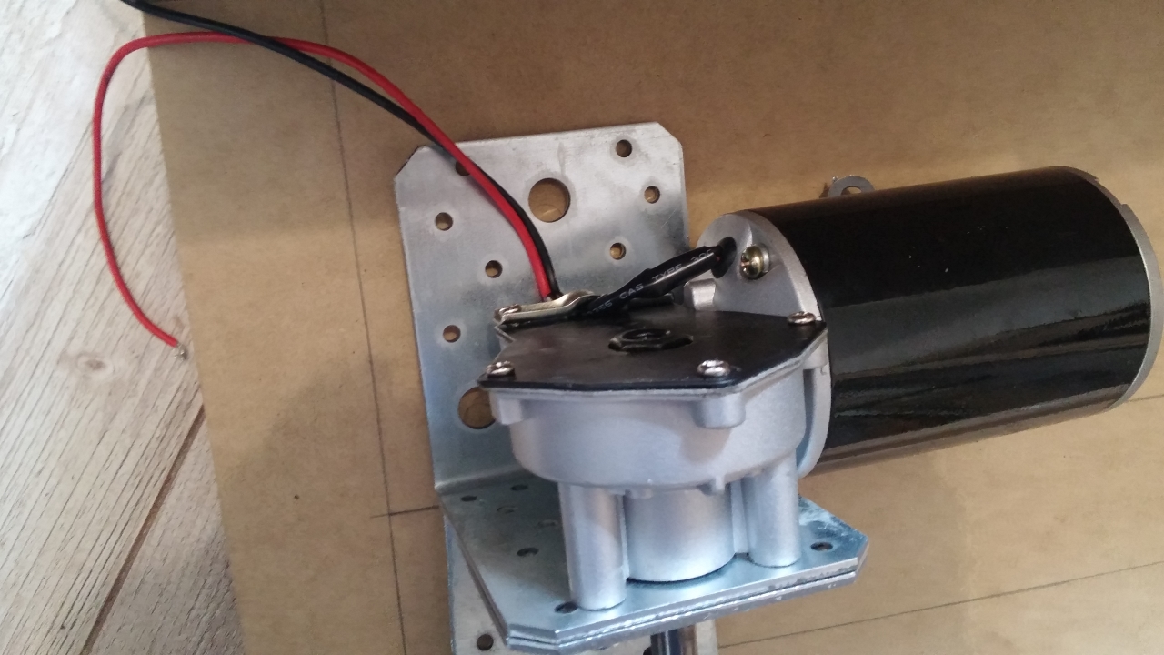

    Finally I almost finished the motor supports and the fixings of the mobile plate
    All I have left are the rods and the universal joint. My salesman had a ski accident, it delays me at least 1 week
    2016-11-25 10.25.00.jpg 2016-11-25 10.30.40.jpg 2016-11-25 10.54.58.jpg 2016-11-25 10.55.06.jpg 2016-11-25 11.18.44.jpg
