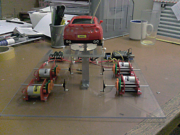

    Does anyone see a reason why I could not just duplicate the rear setup (normal mounting to the back of the chair) to the front with shorter rods?
    the chair has a multiaxis joint mounting the next 2 motors to the front left and right corner of the chairs platform similar to this project
