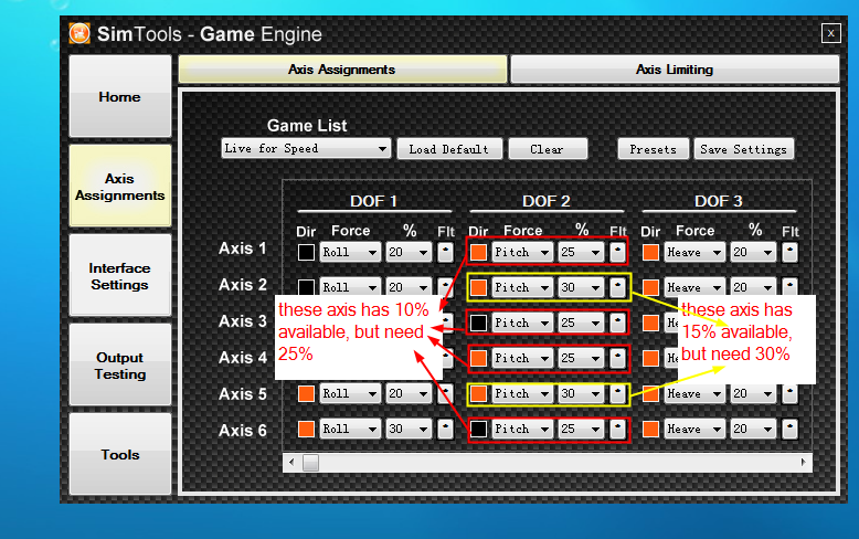

    Hi, I have DIY one 6DOF prototype, during the tuning I met some doubts about the filters of DOF. still can't understand it.

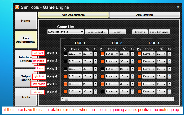

    My axis assignment.
    All the motor has the same rotation direction, when the incoming gaming value is positive the motor goes up.

    Boundary – Is to make sure the single DOF does not use more than X amount of the available axis. In turn letting you have a very sensitive axis and will make sure it doesn’t take over the whole axis.
    In my axis assignment some axis is totally more than 100%, and I feel the SIM is too soft, not fiery enough, I want to increase the percent of axis.
    If I didn't set the BOUNDARY here, is there some default protection mechanism to make sure the motor doesn't take over the whole axis?
    for example, the current DOFs have used most of the axis, 4 motors has 10% available, 2 moters has 15% availbale, the new incoming signal is PITCH DOF, 4 motors need 25%(but these 4 motors has 10% available), 2 motor need 30% axis (and these 2 motors has 15% available). how the SIM game engine command the motor to rotate? 4 motor rotate 10% and 2 motors rotate 15%, or the SIM game engine will keep the axis proportion (the 4 motors rotate 10%, and other 2 motors only rotate 12% to keep the PTICH axis proportion).

    It is not just your Axis Assignments that determine how 'fiery' your sim reactions are, it is also the Tuning Center values, plus you can use Game Manager profiles to refine the reaction of a game motion profile even further to suit particular cars and tracks: https://www.xsimulator.net/community/faq/steps-to-create-a-motion-profile.228/
    Filters are useful, particularly for flight sim motion profiles, but you first need to get the default then game base motion profiles sorted.
