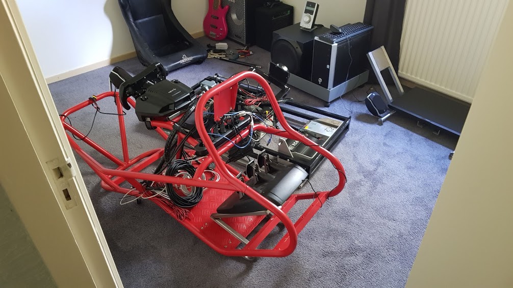

    Long time no see...
    Good news, everything works perfect! I moved the simulator to a different room. About 6 hours of work haha
    Before:
    (Below)
    And after:
    (Below)

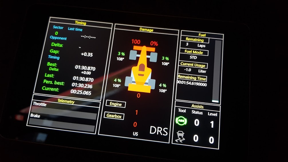

    Then I started using SimDash on a tablet, why u ask? I think it more fun to give the spectators an extra dimension when you are gaming with some friends. Below you see the most recent result. It's not perfect but I really dig the interactive communicaiton.
    (Something went wrong while uploading the photo's, I'dont know what but this seems to work...)

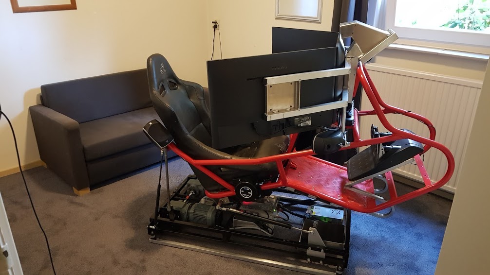

    Another upgrade wich makes gaming more realistic and more fun. I've just added a secondairy and third monitor. One biggie for the driver and a smaller one for spectators.
  20. Gadget999
    1,959
    11,983Coins
    +484 / 10 / -0
    looking good !
    how much movement do you have when the sim moves ? do the screens move about much ?
