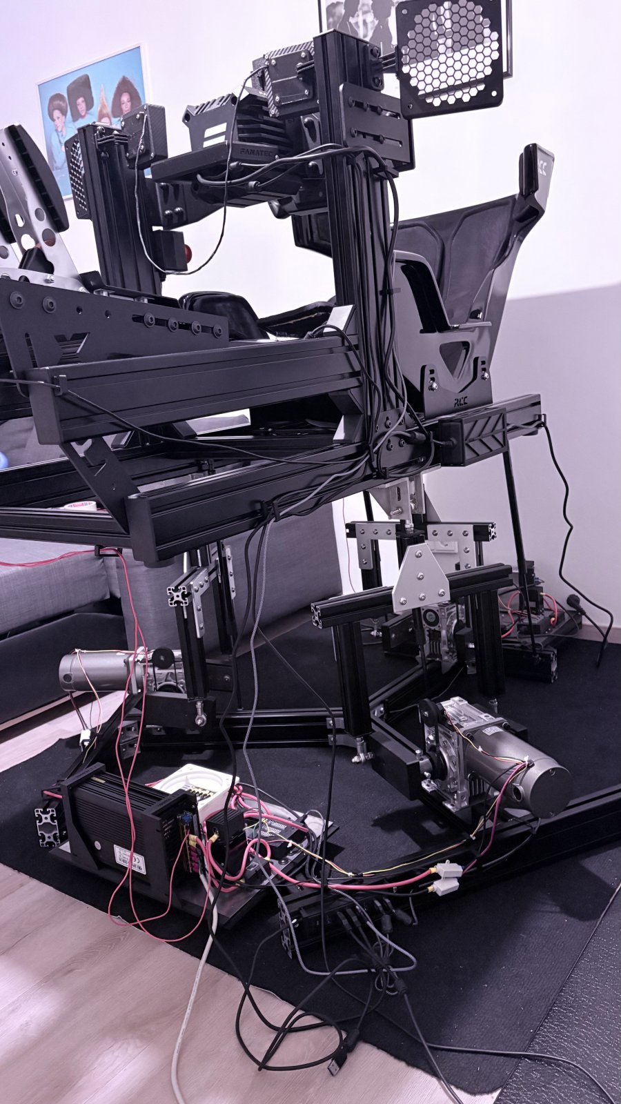

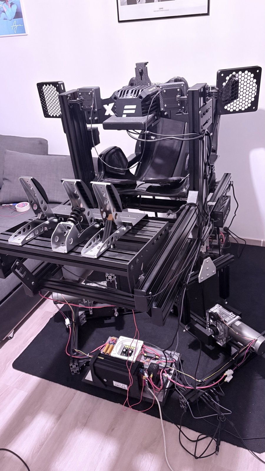

    Ok, so the USB-hub doesn't seem to be the problem. I've added ferrit cores to the USB cables and I laid the power cables for the motor and the cables for the Potis separately.
    For anther reason, I changed the Potis to ones with a D-Shaft, therefore I had to reset all settings in SMC3.
    I did some more work on the cable management, added 4 gas struts (each with 280N), two in front, two in the back.
    The current problem is massive stuttering of all three motors. I was able to reduce the stuttering with a lower KP value, but I am not able to remove it completely.

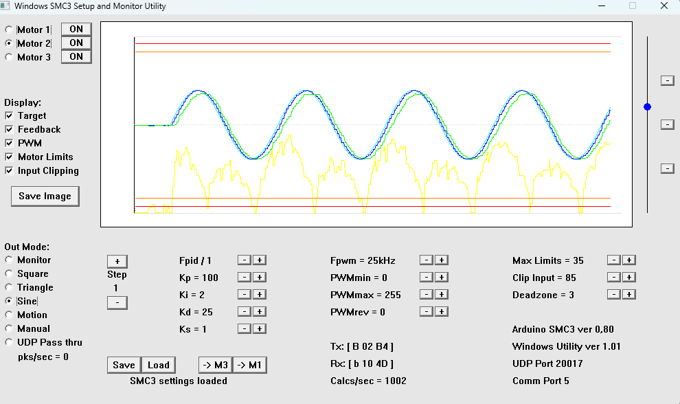

  15. noorbeast
    22,039
    153,830Coins
    +11,151 / 57 / -2
    Can you please post a picture of SMC3 running the Sine Test.

    325Coins
    +9 / 0 / -0
    Sure, here you go.
    The green line is a bit off, due to the lower Kp value.
    I've uploaded a video as well.
  17. noorbeast
    22,039
    153,830Coins
    +11,151 / 57 / -2
    For now leave Ki, Kd and Ks at 0, Kp to 200, and PWrev to say 120, you just want to get a sensible base then play with one setting at a time from there. Rerun the Sine test and post the outcome.
    In the video I can hear what sounds like the rig rattling/shaking, where is that movement in the rig, as it almost looks like a bit of lateral twist.
    Also, how close are the connecting rods to the pivot point?
    Lastly, has your rig been properly balanced, with you on the upper frame and all peripherals attached: https://xsimulator.net/community/faq/find-the-center-of-gravity-to-balance-a-motion-simulator.55/
  18. _cOdaC_
    _cOdaC_ Member
    Dec 20, 2023
    63
    325Coins
    +9 / 0 / -0

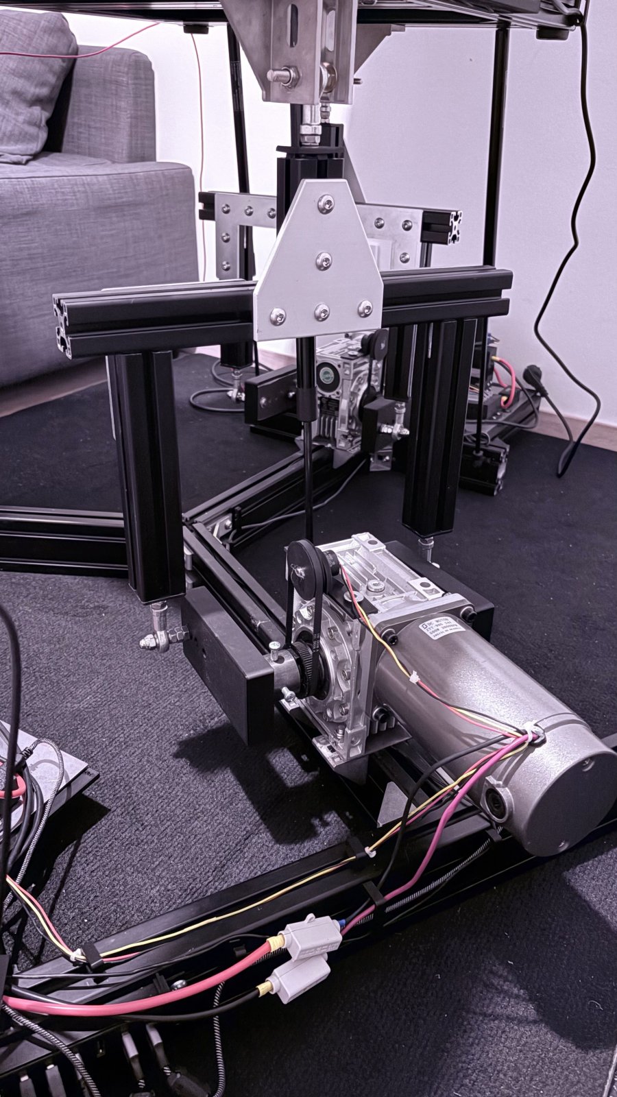

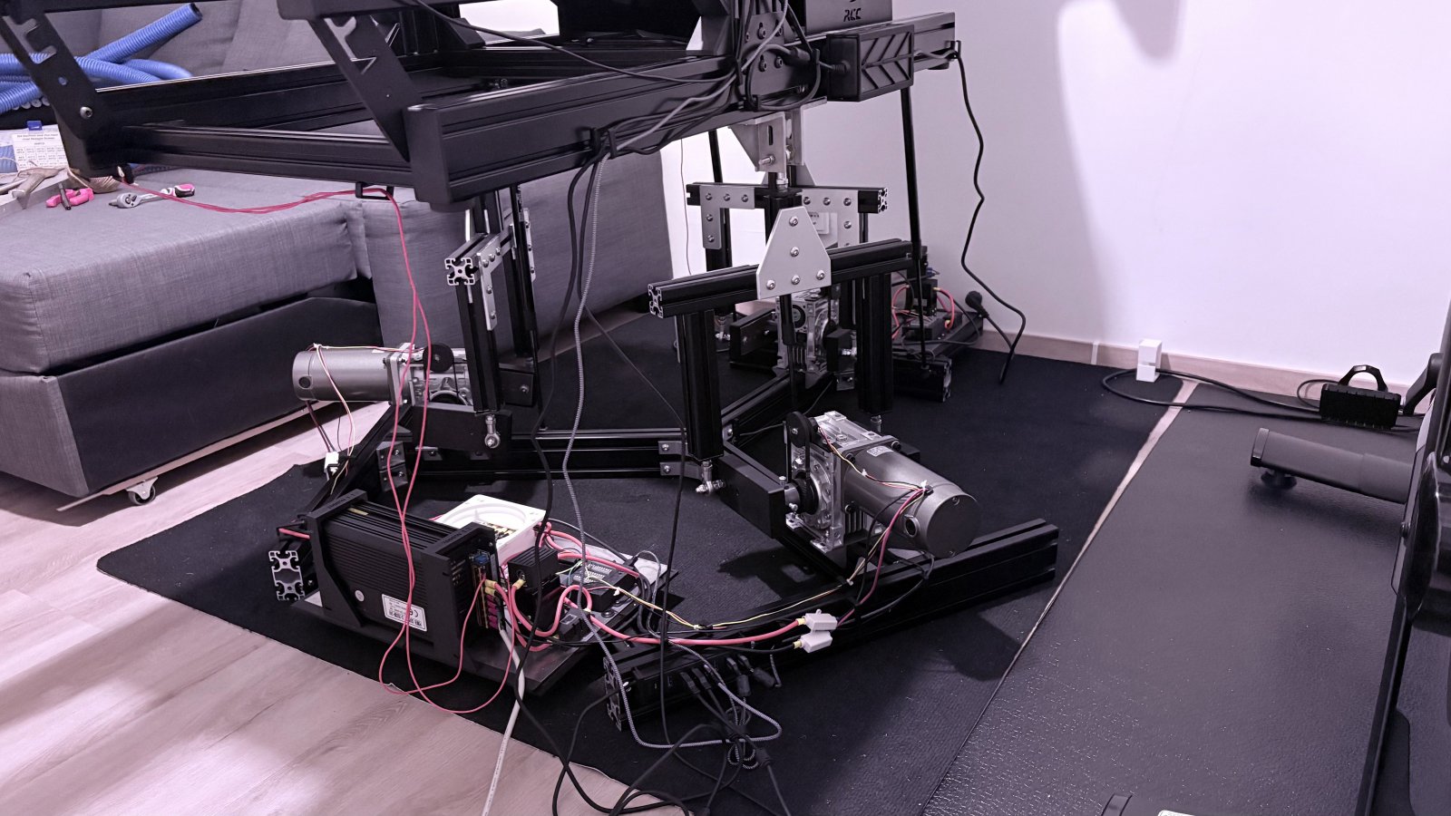

    Answering your questions:
    It comes from the stuttering of the front right motor (drivers view) and the stuttering shakes the whole rig and only the front right motor is moving.
    The motors are in an 120 degree angle to each other and the rig has been properly balanced, yes.
    Sorry I'm a bit lost in translation, but the lever of the motor is 41cm away from the CoG, if that was what your question meant.
    I've attached some photos.
    Testing your suggested values brought the following results, please see the attached Screenshot of SMC3 and another video with the new settings.

    I'm not so sure about the DIP switches. I followed this tutorial and set the DIP Switches to
    1 OFF, 2 OFF, 3 ON, 4 ON, 5 ON, 6 ON.
    I'm using the 8.2 soft start sketch and set both Sabertooth to a Baud rate of 115200. Serial Timeout is set to 100ms.
    The Baud rate is set to 115200 but the DIP 5 is an Autobaud setting, and might better be set to Off, no?
